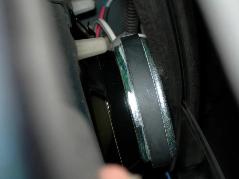

The 6.5" Pioneer TS-G1643R speakers for the front do not sit flush against the door as the magnet hits the window channel inside the door.
I positioned each speaker and drilled 3 new small holes to secure each speaker with the longer screws that came with the speakers since the Toyota speaker screws were too short.
I then used some foam insulation from Home Depot to line the perimeter of the speaker opening in the door.
Here, you can see the foam sticking out from behind the speaker. As I snugged down the speaker screws, I raised and lowered the window to make sure the speaker didn't push the window track out of alignment and cause binding:

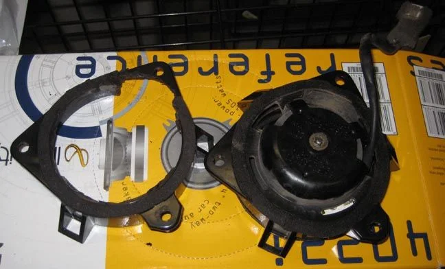

The rear speakers are mounted in a 'basket' which holds them off of the actual door frame. And the OEM speaker grill snaps into this basket. The stock speakers are secured to the basket with a single screw in the back. I removed the OEM speakers from the basket and found that the magnet on the back of the Pioneers is too large to fit into the basket. I first tried enlarging the cavity with a barrel sanding drum in my drill press, to no avail. Then I decided to just cut the back of the basket off with a jig saw. Unfortunately, I forgot ti take pictures when I was modifying the basket, so some of these pics come from other threads on this forum.
Here's a stock speaker mounted to the basket, and a modified speaker basket. Picture courtesy of nakman:

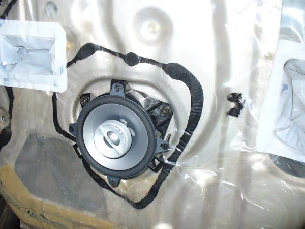

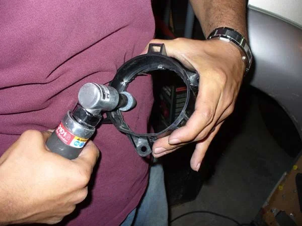

I used a jigsaw to cut the back of the basket tub off the basket housing. Here, Romer is using a die grinder to clean up the basket opening. This wasn't necessary with the Pioneer speakers as the magnet had plenty of room once the back of the basket was cut off.
attachment.php
Here's the new speaker installed in the basket and the door:
I secured the new speaker to the basket with JB Weld, visible at perimeter of speaker and basket:

I offset the speaker mount tabs slightly from the basket's mounting tabs for the speaker cover and found that it fit perfectly - no modification required to the speaker to clear the grill mounting tabs.
Here's my completed install:
