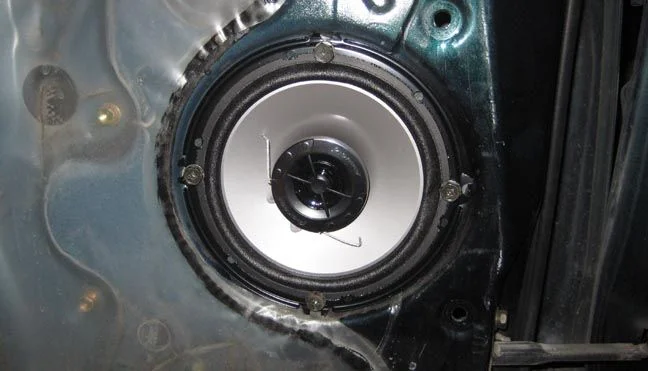

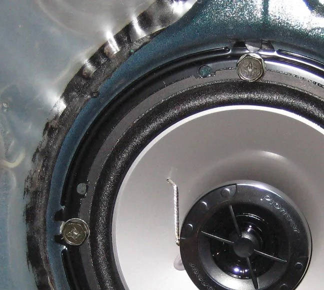

Wow, added the rears this afternoon and re-evaluated everything. Used Skillet's mounting and for those without a dremel you can also use an ordinary soldering iron with the blade thing (they all come with one) to cut the plastic baskets.
The rears were single cone speakers from the factory like the fronts. They were putting out really awful stuff - not contributing anything but filler noise. Like the fronts, the new Pioneers are two ways so there's a much nicer stereo separation going on and it just crisped up the sound a bit. Now when I compare the fronts and rears the rears are actually adding a quality sound vs just a melange of sound. Very nice addition. The big bang is still with the front installs, but the rears complete the package. Remarkable, really.
I'm an AM talk show junkie as well and cannot believe how much better I can understand the words, tonal inflections and such.
That Scion head unit just got moved to a shelf in the garage.....

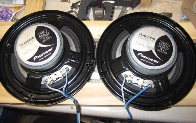

I see IdahoDoug did this to his '93 LC. Has any-one been successful in doing this particular front speaker replacement to a later-model LC? I'm having no luck with my '97 LC Collector's Edition.
I suspect Toyota changed the front stock speaker grill in later 80 models, and maybe even the available speaker depth for the magnet.
There is no-way I can get the front door panel to fit over the 6.5" Pioneer TS-G1641Rs without a bulge appearing - the yellow clips above and below the speaker will not even engage wthout significantly bending the panel.
I tried it both ways with 3/8" worth of spacers to keep the magnet off the window channel - using small screws and drilling new holes, and also with the factory holes with longer screws. I even tried a 1/4" of spacers, with the magnet tight against the window channel - still no luck.
The rear 4" Pioneer TS-G1041Rs's fit just fine as IdahoDoug/Skillet have outlined.
Bummer on the fronts though -any thoughts? Thanks! Keith.

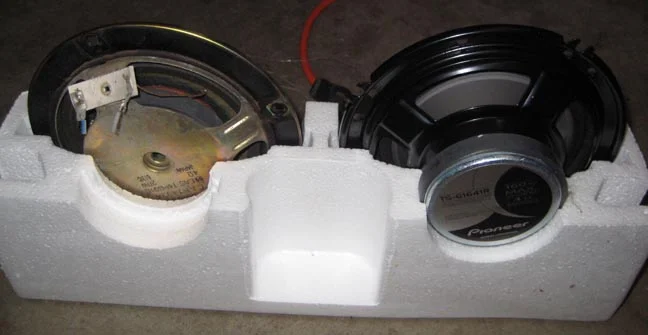

Yes I bought them new from BestBuy after I saw this thread. Be sure to not do what I did - going on this thread I assumed they'd fit, so went ahead and destroyed the packaging box they came in when I cut out the speaker template on it :doh:.

The Pioneer G1641R's have a top mount depth of 1 11/16". This thread has established that these fit the earlier LC80's with the factory speaker grill, but do not fit the 97 LC with the factory speaker grill.
The Eclipse SE8365's have a 1/4" deeper top mount depth of 1 15/16", so I see no way they would physically fit the 97 LC with the factory speaker grill - or financially fit at $119 a pair!​
Seems those wanting to retain the factory speaker grill in a late model LC80 need that magic combination of a 6 1/2" speaker with no more than a 1 1/2" top mount depth - I checked and all thirty-six 6 1/2" speakers on Crutchfield do not meet this requirement. Oh well, I put back the factory stockers for now.

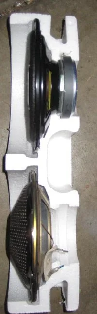

Ok, silly question Keith, but you're not trying to install them with the grills on, right? just trying to see why these are working fine for everyone else, that would definitely do it..
Correct, I just installed the speakers - the Pioneer grills were left in the styrofoam packing.
