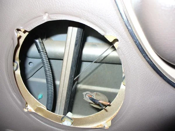

For some reason I thought I read in an older thread that the maximum depth was just shallower than 2".... now if I am reading correctly we are saying it's just a tick more than 1.5"? That makes a very large difference in speaker selection... so which is it?
I believe it varies depending on the model year, and where you are measuring from - :frown::
For my '97 LC, since I wish to retain the stock speaker grill, I can only mount about a 1.5" or shallower 6.5" speaker directly onto the door metal.
Now if I were to remove the factory speaker grill, and fit the new 6.5" speaker on the outside of the vinyl/leather/pleather door panel, I'd likely have ~2" of depth - but then I'd need to use the new speaker's covers - which defeats my objective and the title of this thread....
I guess I'm the only 97 LC owner actively trying to fit these speakers - all others on this thread to date have older model LC's, which appear to have a little more breathing room in the speaker compartment...

I put them in my LX450, it required shim about 5/32 inch thick. Even with that, the magnets were touching the window track. When I put the door panel back on, there was a small bulge where the speaker was. It fit OK, but not great.

This is exactly where I am with the install of the Pioneers I linked to above. Had to shim quite a bit.. and while the door panel goes back on just fine, there is probably a 1/4" bulge around the stock speaker grille. I've removed the stock grille from the door panel for now.

I did take this picture of the speaker hole on the 97 and the window rail bar is right in the center of the hole and thats what the deeper Pioneers would have hit.
Good picture! Yep, that sums it up for the '97 LC - minimal mounting depth - glad to see mine was not the fluke :D.
According to Crutchfield, the Infiniti's are 1/8" deeper than the Pioneers, so they would have had an even worse time trying to squeeze behind the factory speaker cover.
