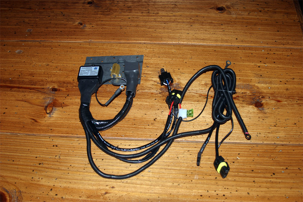

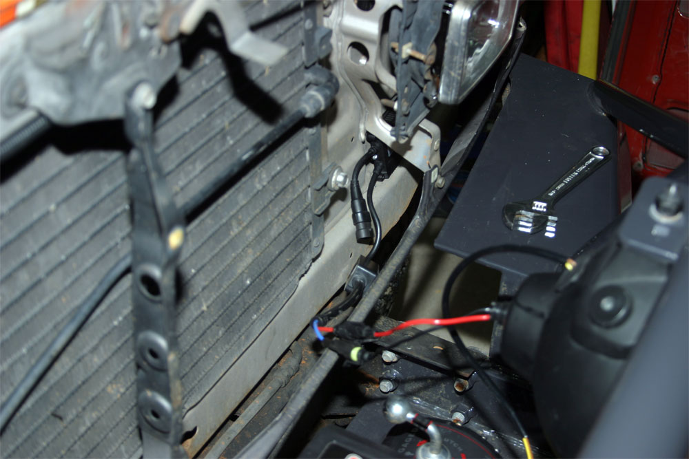

My outer lights are now 35w 6000K Hi/Lo HID 2800 Lumens. Iam using a custom Harness, and it does light up the "Brights" idiot light in the dash, and was 100% plug and play.

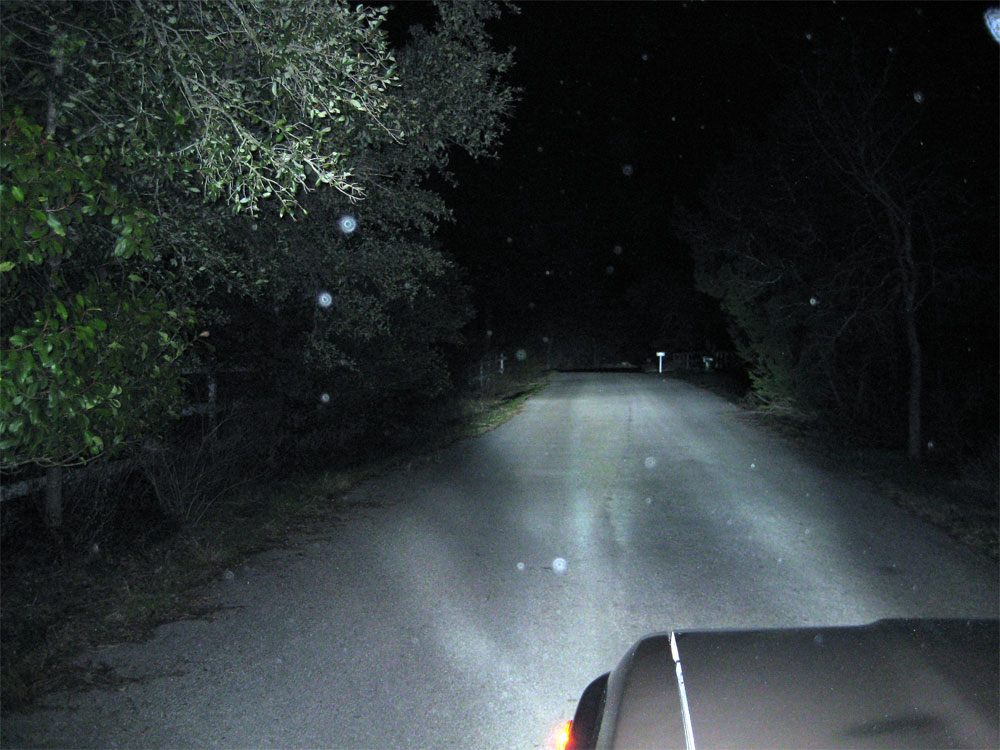

Low Beams only:
High Beams Only:
All the lights:

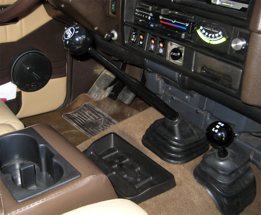

I used some extra rear defroster switches I had, and some stickers to label the switches.

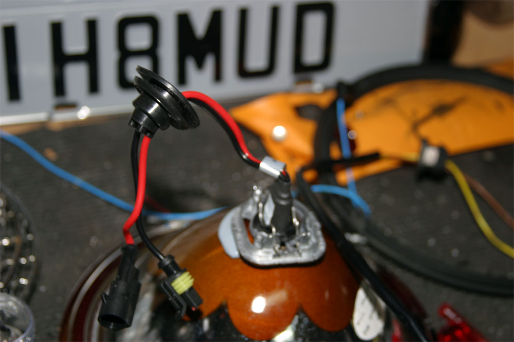

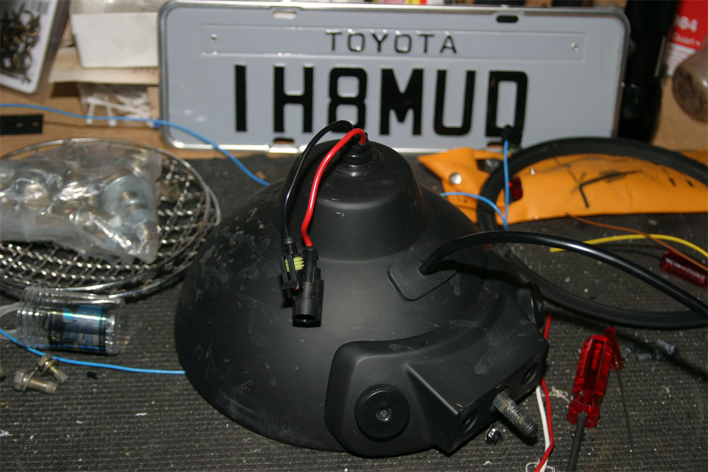

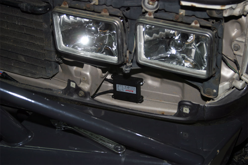

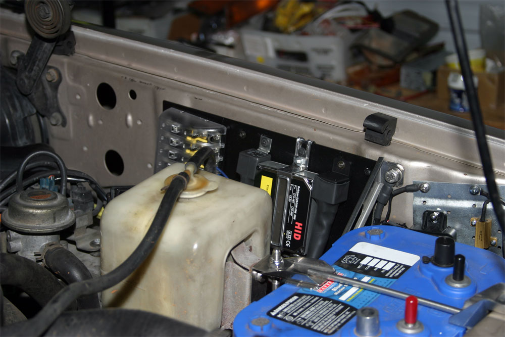

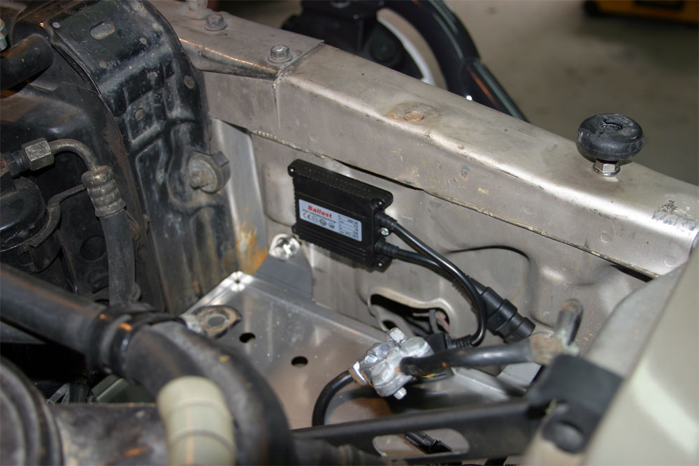

I stuck the 35w slim balast behind the lights, and the 55W balast where ever I could. One other next to my accessory fuse box, the other - on the DS fender.

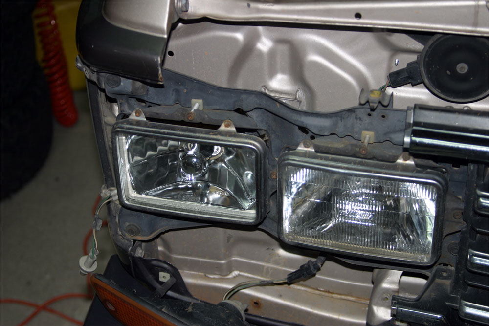

The Light housings for this are Autopal, but Iam changing them out to Nsirus, because they are better housings.
As far as the harness - You need it to be wired correctly for our trucks, unlike the FZJ80 or 100 series where people are just putting in HID bulbs/Ballasts/harness to the factory harness. So, yes, it's not a draw issue, but a relay, trigger, brights on dash issue.
The Ballast Iam using are water proof, and the name is Generic. From what I understand about all these HID kits, there are different levels or grades. Mostly coming from China and Taiwan.

How is the horizontal cut off on the low beams? The cut off on my Bosch H4s in my FJ-62 and the HIDs on my Audi and Lexus are really distinct. I thought about HID before but the retrofits that I've seen throws a lot of light "up", which is the issue with on coming traffic.

Currently Iam using the Autopal light housings. I'll be changing them to the NSIRUS this weekend, then I'll take some pictures of the light out put for you against a wall.
They do have a cut off, but it's a bit fuzzy and not like a true HID with a shutter. I would say yes - It tossed some light up, but I have yet to have some one flash me because they are upset. But a picture is worth 1000 words, so I'll take some for you.
I have a true HID 4x6 housing on the way, it's a true Bi-Xenon unit with a projector and D1S HID Bulb. This is 100% DOT compliant for on road use. Of course this is not going to be a cheap solution, but if you want a true HID - it's the only way to go.
