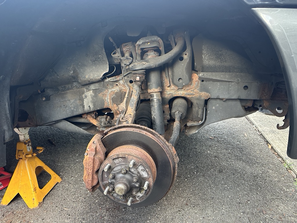

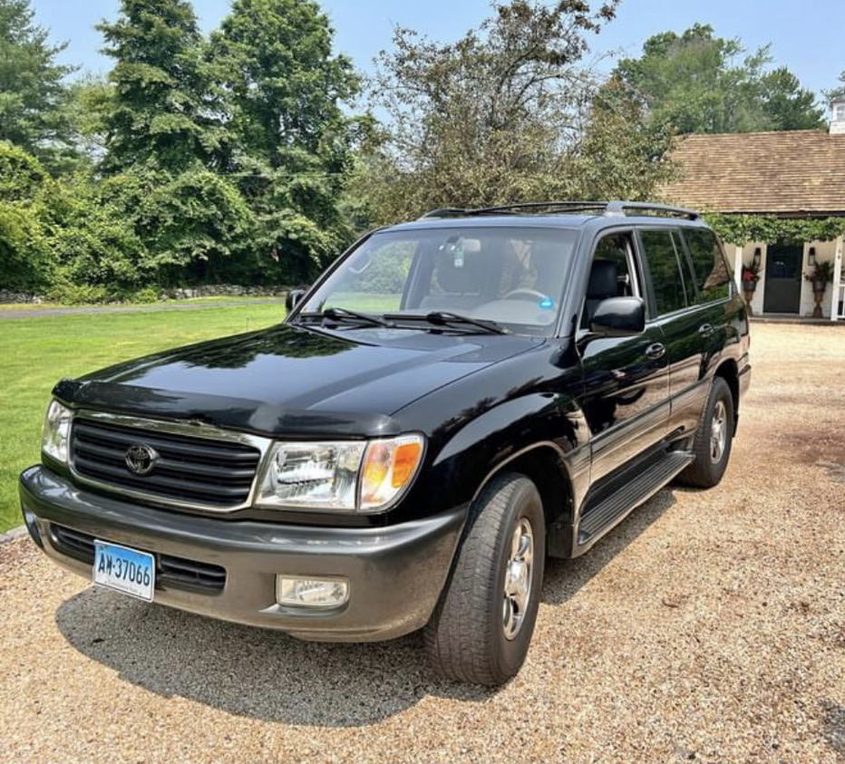

Whats up! I'm new to the group, serial DIYer, last project was a Land Rover Disco II, this is my first Land Cruiser. So far I love the truck but this is going to be a huge project. Any advise?
welcome and beautiful 100! Agree with previous comment. Rust 1st, it is the biggest weakness of the 100 and will nullify anything else you do. Having said that, recently Went through mine (2004) and every mount and bushing was dry-rotted (if not destroyed). The 4 with actual rubber missing were: lower control arms, trans mount, and the front diff mount (radiator side). But mine was at 300k miles. Just things to look at While going through it and you can assess for yourself.
As stated above get the rust under control. I would also start with the basic baselining all fluids. Check heater T's, timing belt, and water pump. Spend a lot of time readying the FAQ's (a ton of great info there). Make a list and work your list.

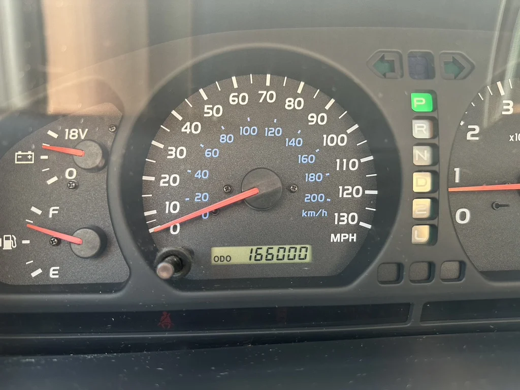

Welcome, if there’s no timing belt sticker or service records, that must be done every 90k, so may want to do that. And if you’re going to do that, then you might as well replace the water pump, pulleys, tensioners and drive belt. Check the underside of the body back in trunk for rust. check OTRAMM‘s pre purchase inspection points:

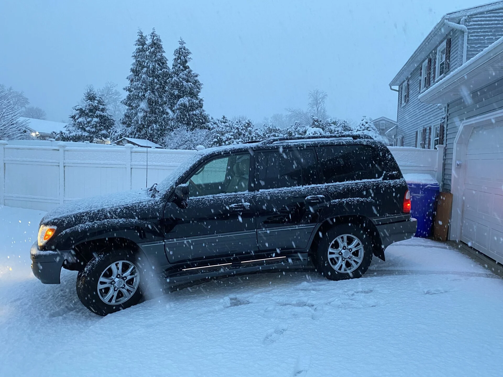

Great ride! Nice to see another New England driver. I’m in Massachusetts. Also, black rig for me, ‘05.
