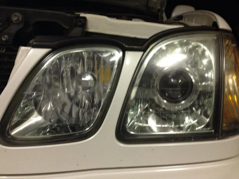

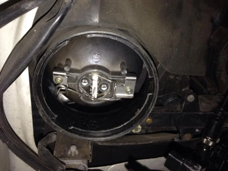

I looked on Rockauto and typed in 2005 Lexus LX470 and it called for High Beam is 9005 and Low Beam is 9006 replacement bulbs. So I called Steve at SEO and ordered a pair of each in LED. I went to install them last night and ran into a problem. I got the high beams in but the low beams don't appear to be anything like a 9006 bulb. WTF?!!
I am going to attach some pics and ask for any advice on how I should proceed. Did I just order the wrong bulbs? Has his truck been modified prior to his ownership? I'm baffled but then again it really doesn't take much to baffle me :confused:

No idea as to the '05, but my '01 has H1's as low beams.
Steve
This may sound silly but you do realize that the high beam is Not the projector lamp and that the high beam also acts as a daytime running light using a ballast that halves the voltage to the light during daylight operation, concern with this is how will an LED bulb react to a voltage reduction during daylight operation? I'm interested in this as I have added HID's to my projector/low beam and I still can't stand the orange light that the high beam displaces during daylight running mode!

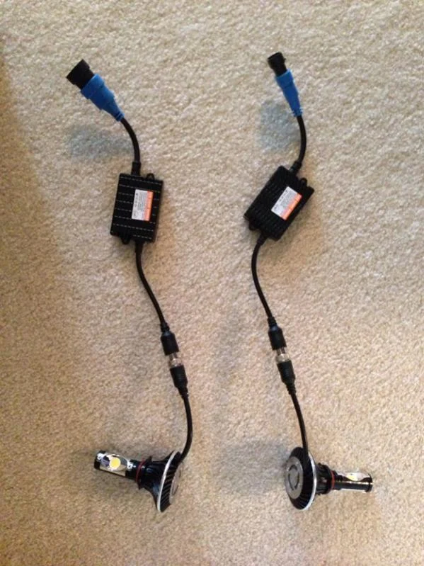

Well, I was going to do a separate thread with a review of all aspects of these bulbs but since I ordered the wrong bulbs for my brothers truck and am still figuring out what to do, I will post up my first impressions here.
I purchased them from Steve at Southeast Overland. As said before, they are Lifetime LEDs so they are lifetime warrantied including the fan motors and even if they get drenched. Steve said they also have a 7 day "no questions asked" warranty so if you get them installed and are not happy for any reason, you return them.
Packaging was very professional and quality.
The bulbs and fan motors have a nice solid feel to them. I believe the housings are an anodized black aluminum.
Outside of that, that is all I know about them currently.

Thanks for your business and sorry you are having issues with your high beam headlight install. I checked Sylvania's website and it calls for a 9005 for high beams so that checks out - and it calls for an H1 for low beam so that might be the issue. We don't have H1s available currently but will in March. Just hollar at us at Sales@SoutheastOverland.com if you want return those headlights. We will give you a RMA and get them headed back our way, postage paid. We can either give you your money back or send you a pair of replacement H1s when they are available.

From my days working with LED fixtures and drivers, the LED probably generates nowhere near the heat that the halogen bulb; the fan is likely just assisting with thermal shedding to keep the (diode) junction temperature at a reasonable level...if this level is not maintained at or below a specific temperature, LED output/life drops precipitously.
