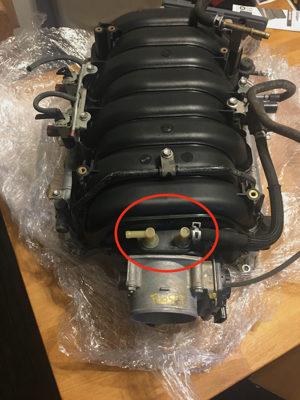

Hi All,
I recently bought a 2008 GX470 and starting to update some of the hoses. Can anyone tell me what the hoses at the front of the manifold are? Looking for a part# for the right side (starting to crack). I promise I tried to search for the answer before I posted. I borrowed the picture from joemg on the lexus club forum. I hope he doesn't mind I but could not find a clear pic otherwise.

They are vacuum hoses that operate various systems.
Really no need to replace them with OEM Lexus/Toyota hoses (though there is certainly nothing wrong with that either). You can just go to an auto parts store and buy vacuum hose of a similar diameter by the foot and replace them with that. However, Lexus/Toyota should still offer them for a few dollars each - if you do want to use OE I'd spend some time on Lexus/Toyota parts websites (looking at parts diagrams for the emissions/vacuum systems) and then order the parts from your local dealer or Partsouq (which is often cheaper).
Regarding the rear main seal - you may be kind of far down that road - but my drip dried up with a bottle of AT-205 seal plasticizer, which is $20. Definitely worth a shot relative to the labor of dropping the transmission to pull the seal.

Thanks, Rednexus!
I figured they were vacuum hoses, but wasn't sure. I've been searching the parts catalog and websites, but I think I'll take your advice and just get some vaccum hose from the store for now.
Also taking your advice on the rear main seal. I thought the same thing. I've been watching the valve cover gaskets for a while and I need to do the same thing with the rear seal and try AT-205 before I pull that trigger.
