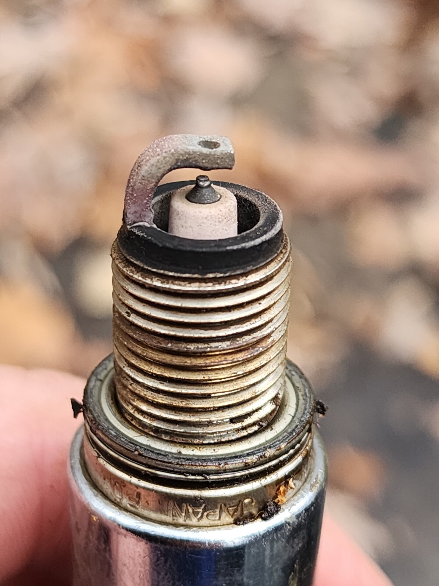

I have installed a turbo and I am very happy with the results. Only running 5-6 pounds boost. Everything is stock. So the question I have is about the A/F ratio. In the attached link I have a short video of me driving on the highway showing my A/F gauge. It seems I am running lean at idle but its ok at speed and WOT??? I am also including a picture of the spark plug from #2 cylinder. It looks good to me. I pulled cylinder #1 and it was not quite as good(looked lean) but did not take a picture before I put it back in. I have about 15k miles on a complete top end rebuild that included a full injector cleaning. I have the feeling I am running lean on some cylinders but not others. May need to replace some injectors. No codes. I also pulled the plug on the o2 sensor and it did not make any noticeable difference. I tought it was odd that I did not get any codes when I unhooked the sensor. Should it throw a code?

Brain trust,

Things look mostly fine, it is hard to tell in a video with just the AFR gauge and not the vacuum/boost gage and RPM, but for cruise and in vacuum those AFR's look fine, and then under boost those AFR's look fine. One thing I did notice is that your truck was still cold. The fueling when cold will be slightly different than when warm. Let it get to operating temps and check it again. But from what I saw I did not see anything alarming.
An yes the AFR gauge being all over the place is normal and what you want when you are using an O2 sensor to make decisions about fueling. You are using it just to monitor so you have to use your common sense to filter out some of the noise. You will always be lean on decel, anytime you shift you will see movement on the gauge, any slight pedal variation will likely decrease your AFR before the older and slower 1980's tech of the 80 series catches up to a modern O2 sensor.

You aren't going to hurt anything at idle. If you are lean under boost you will have detonation and that is when you have serious issues, at idle and cruise, because there is no WIDE band O2 and the old technology uses NARROW band O2 tech, the truck will kind of hunt between 14.2-15.2, the sensor only knows if you are between that range, if you are outside that range it doesn't know by how much etc.
