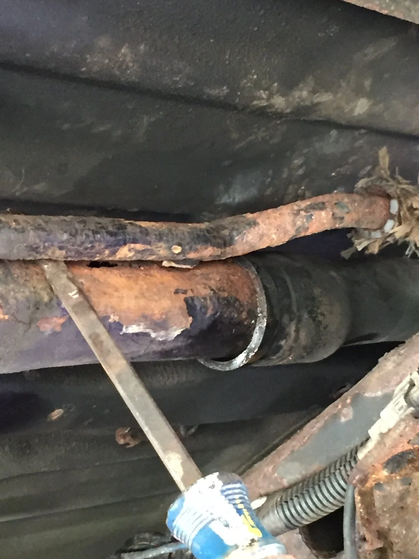

I think the leak is just over the rear axle, where the fuel hose and vent line are touching together after the bracket. When I was trying to remove the bracket, both bolts snapped so that sucks. But there was a rainstorm of rust dropping on me. It seems likely this is where the issue is.
The filler neck is prone to corroding at the support bracket roughly just in front of the rear axle. Look for a white residue on the underside of line/metal pipe. Also the pipe will appear "cleaner" than the surrounding metal surface where the leak runs down the outside of the pipe. Will be subtle but visible. If you can, get your phone camera lens up in there with flash on and snap pics of the top side of the pipe. Could be occurring where the vent line and filler pipe meet. Hard to see when laying on your back underneath the truck. Here is a pic to give you an idea.

So the leak was where the air and fuel were welded/linked together. If you look to the right of the screwdriver, hole is roughly 1” long with about a 3-4” line where the hole is leading. Tried to remove the filler neck today, can’t Free either line from the tank. If I drop the tank, I have to break the tank strap mounts because the nuts wont release. Very frustrated to see what needs to be fixed but all of the options aren’t good. I’ve been told that any JB weld or similar permatex compound won’t adhere due to rust. If I could sleeve the pipe with another fuel hose that would work. But I still need to get it down on the ground to release the fuel filler. Never mind the fact that I can’t get a replacement..I need a beer
