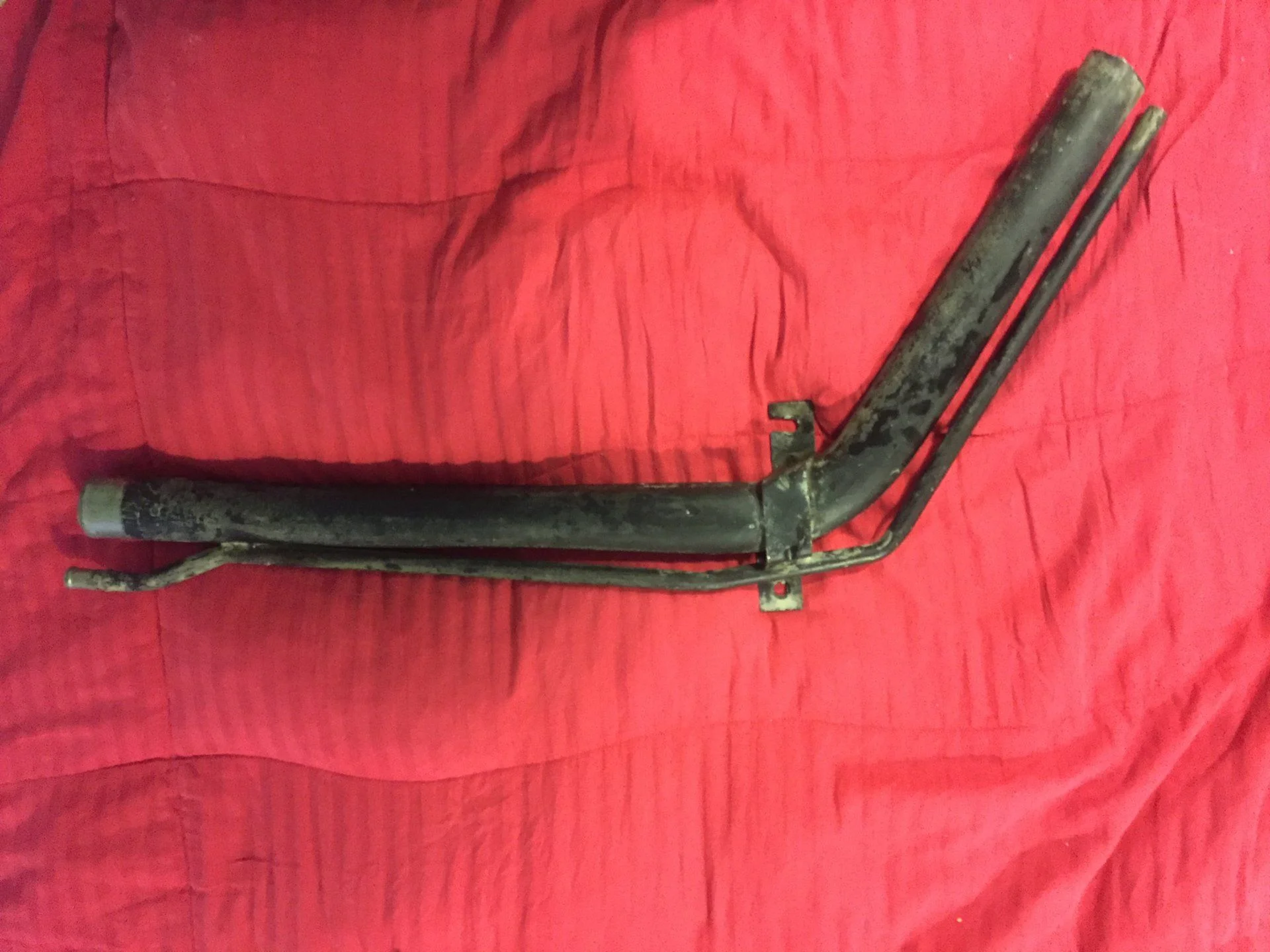

I am not sure if I followed this thread completely. I have removed the filler neck twice, once when installing a complete OEM sub tank system, and once on another rig, when I moved the rear axle back, and the fuel filler neck needed to be relocated.
Both times I cut the filler neck to remove it. The OEM subtank solution has a short OEM pipe from the tank, then a rubber hose connection to a short duel filler neck. If your ultimate solution involves a flexible fuel rated hose connecting hard pipes. I see that as aligned with Toyota engineering.
Seems to me a bit overkill to buy a Complete new filler neck, then perform all the gymnastics to install it. Will JB Weld, seal a fuel related crack ?
The pic is one of the filler pipes I cut. It’s cut about where the OEM sub tank part ends and it is surplus for my current rig. Not sure exactly where your leak is, but if this works into your solution, drop me a PM
