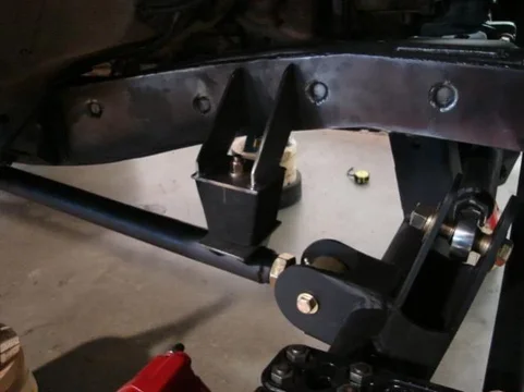

I got a little time last night to work on the bumpstops. Here's a pic before tacking them on.
And tacked in place. The bumps contact about an inch before absolute bottum out. Hopefully this cushion will keep the panhard from becoming part of the oil pan.

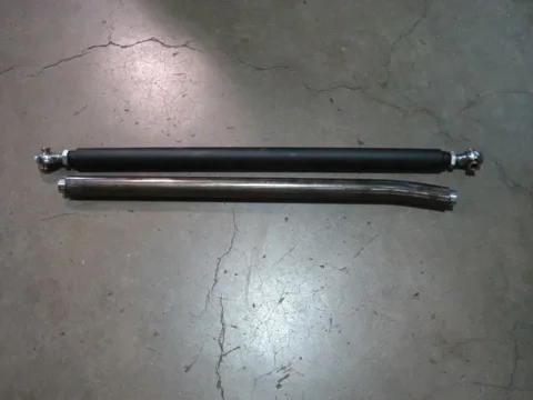

Well it's been hard to find any time for the Heepetr with the holidays and all but I was able to make some progess with a little help today. I changed my panhard bar a bit and found that with a slight bend near the frame I was able to gain about another inch of compression. Here's a pic of the old one (top) and the one I'll be using.

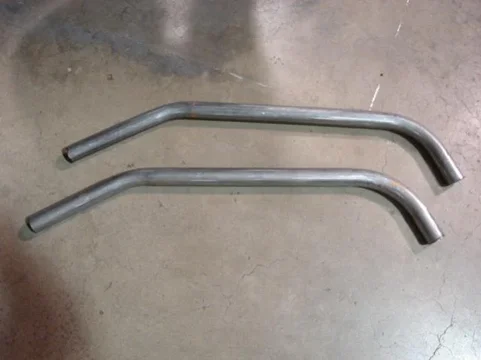

Thanks to Motorhead Mike's I was also able to get the front coilover hoops bent up this last week. These are 1.75" x .120 DOM. The upper radius was a little bigger than I would have liked but as tight as the bender would allow.

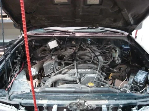

Here's the engine bay with the fenders cut for the hoops. It's a bit hard to see but I gave up a lot of inner fender. Once I get the hoops tacked in I'm going to have to spend some time reworking everything that used to sit there.

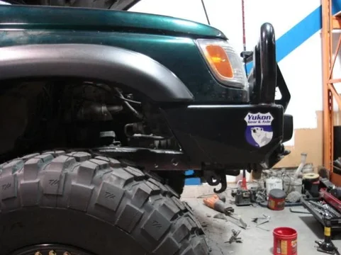

This is the driver side hoop tacked in place for some measurements. Once I finally got enough fender cut out to get these in place I learned I'd cut out far too much.:bang: This is going to make putting everything back in a p.i.t.a.. Only good news is that the hoops sit inward far enough I won't have to relocate as much stuff as I originally thought.

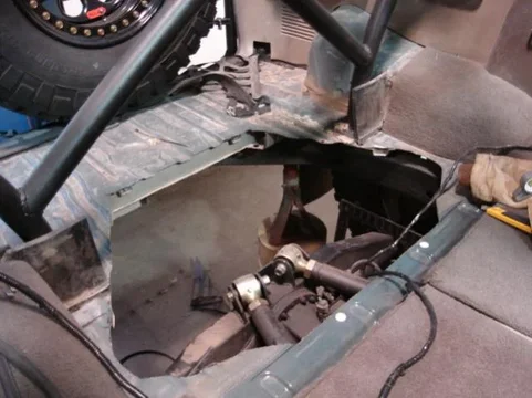

Here's the rear floor before the cut for the fuel cell and coilovers.
And here it is after cutting. The cell is going to mount the long way down the middle and the coilovers will pass through the floor on the outsides. I still need to fab up the mounts for the tank and coilovers. I was going to run 18" coilovers in the rear but am thinking that with inboarding them I might only need 16"s?

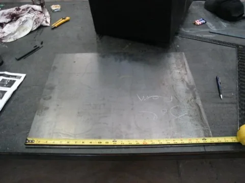

I needed to fab up a mounting plate for the fuel cell so I started with a piece of 1/8" plate.
To make it a little more rigid I welded pieces of 1/8" strap to the bottum and cut out a section for the sump. I'm going to bolt it to some 1 1/4" angle welded to the frame so that the cell carrier will be removable. This picture is before primer.
