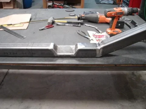

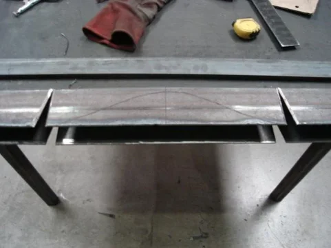

Got around to building the rear axle truss today. I used a piece of 3" x "4 x 3/16" square tube about 4' in length. I wanted a flat plane to mount the upper links above the diff and needed to build up to the 1/4" link mounts. The extra strength won't hurt either. This is the tube with the bottum cut off and notched for two bends. I beveled the cuts back for good penetration so I could weld them up and then grind them back smooth.

Here's the truss after welding and cutting out the shape. It took three pieces of cardboard to get it right.

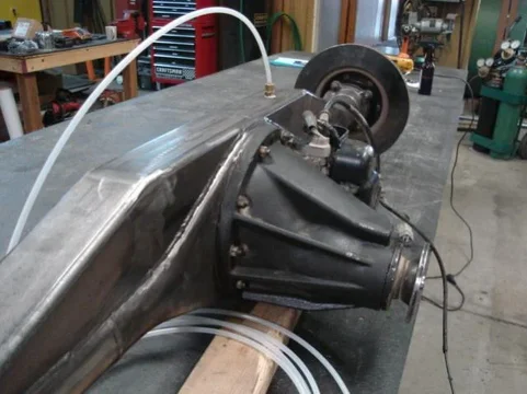

I had to run a hose for the diff vent through the truss. It will end up in the back of the Heepetr for deeper water crossings.

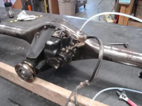

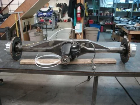

The truss in place on the axle. I welded in on in about two inch sections, moving around and giving it time to cool in between.

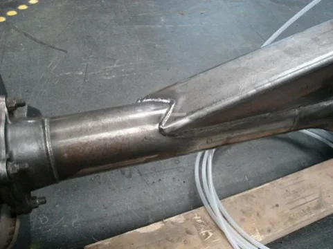

Here it is all burned in.

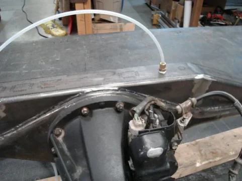

The vent tube ran from a barbed fitting in the original housing and then through a compression fitting I drilled out to keep water out of the truss.

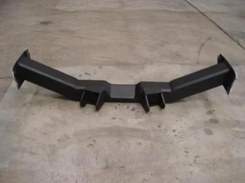

The brackets for the rear showed up so it was time to start mocking the suspension. First thing for me was to build a new crossmember to hold the frame end lower links. I used 3" x .25 square tubing. I had to ramp out the middle to allow for full downtravel of the driveline. I wanted to build this crossmember only once and therefore had to put it far enough away from the t-case to allow for a doubler later.
With some bending and welding it began to take shape.

Here's the crossmember finished. I was pretty proud of the way it turned out.
