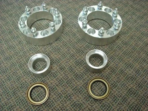

I had some problems with changing the rear axles and thought I might save someone else the same trouble. When I originally ordered my axles from Marlin Crawler I asked about any trouble with the ABS and was told I would have to eliminate it. No big deal. What I didn't know was that they don't have an ABS axle and that I would need a part machined to move the axle seal out to the original position of the non-ABS axles. Just a little heads up. I got it ordered today.:bang:

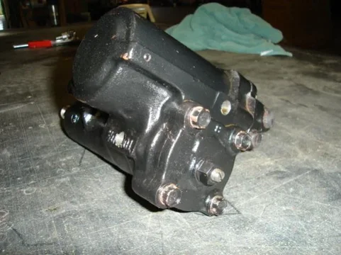

I didn't get the pan changed today but did get my steering box drilled and tapped for the hydro assist. For any one that doesn't know how to do this (myself included untill today) there are some good threads on Marlins forum. I've got the 87-88 IFS box. To start, center the input shaft, remove the 4 bolts on top of the output shaft flange, and remove the output shaft with a couple taps from a dead blow. Then turn the input shaft all the way to the left, remove the 4 bolts from the input shaft flange and remove carefully as there is a teflon seal you don't want to damage. This is my box all torn apart.
Next step was to drill and tap a 2 holes on the box. The first was in the middle of the Toyoda and the second on top of the box along the raised vein. Some of the forums will warn about the Toyoda location getting in the way of the body mount but I plan to use a 90 degree hydrolic fitting so it won't be a problem. The top hole should be drilled carefully to avoid drilling past the channel. Drill both holes to 7/16 and tap with a 1/4" 18NPT tap. Here you can see both holes after tapping.
Here's the box reassembed after carefull cleaning for all the metal drillings. You can see both tappped holes from this angle. Also be carefull reassembling as to not damage the seals. Check the post on Marlins forum for more info.

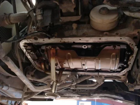

Very little done today. Just got the oil pan pulled and the sumps changed Hoping to get the T100 pan on tomorrow. Here's the old sump.

What did those spacers set you back from Marlin. I have a TRD rear under my 4 Runner and have heard the axles like to snap with anything over a 35-37" tire. Was looking to upgrade to the Alloy USA shaft that Marlin has.
I finally got the oil pan swap done today. The pan itself was easy but installing the rearward dip stick was a pain. You can see its' new location just below the motor mount.

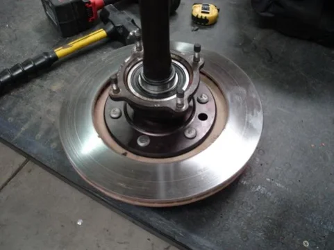

For my disc brake conversion in the rear I wanted to run the stock discs with the 2" wheel spacers and weld a mount to the axle to hold the calipers. Problem is the wheel flange on the axles is a little to big to fit down in the discs. I'm considering having the flanges machined down to fit. I've also heard of people using chevy discs and calipers instead. Anyone have any ideas? :confused:

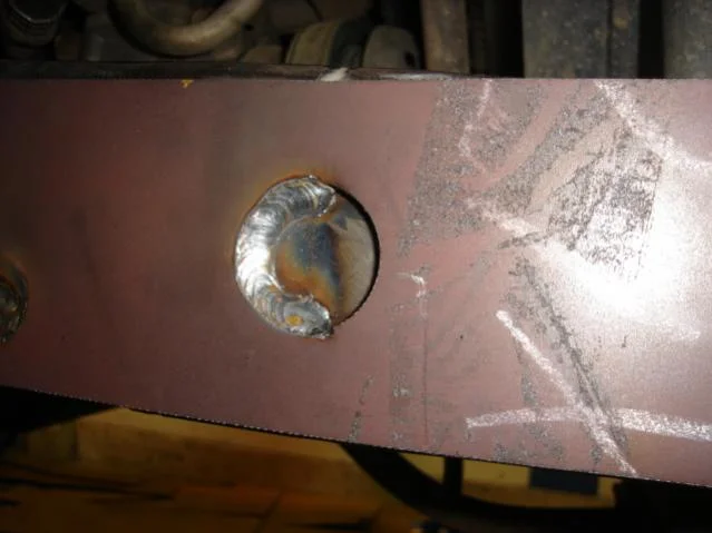

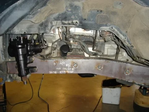

I got my frame plates back yesterday. A big thanks to CDA Metals. I had the CAD drawing to them Monday afternoon and they had the parts lazer cut and back to me Tuesday morning.
This is the motor mount plate.
I tried to weld things a little at a time and hopefully not warp the frame.

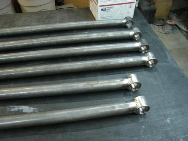

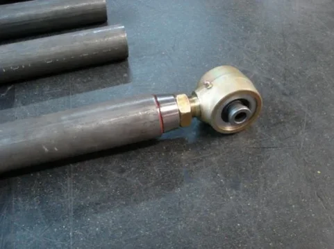

I got a little time today and since I don't have my brackets yet I started welding up the control arms instead. For the frame end I'm using the fixed 2.5" johnny joints.
On the other end of the arms I'm using 2.5" x 1" johnnys. I was going to use the 1 1/4" but got a steal on these. Has anyone ever broke the treaded shank on one of these? Currie told me they had never seen one fail at the threads?

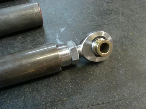

For the panhard links I'll be using 7/8" heims. I opted for the cheaper ones...I mean more affordable. I figured if I was unhappy with these they'd be easy enough to change over.
