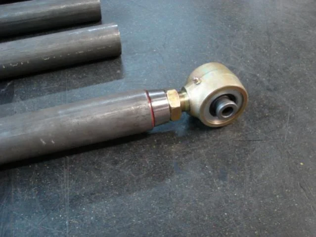

The more I thought about the 1" shanks on the Johnny Joints, the more nervous I made myself. Today I sent the stuff back to exchange for the 1 1/4 shank. A little extra insurance is never a bad thing. A special thanks to Ruff Stuff. I got the tube adapters from them. They are awesome to work with.

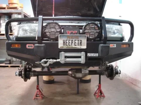

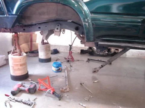

I made some progress today. I got a look at the axle under my rig and started working on the steering. Also pulled all the ABS stuff and the charcol canister and related plumbing that was in the way.
This thing sits wide!
I'm a bit concerned that I may not have mounted my steering box far enough forward but if thats the case I'll be forced to relocate it. I won't know for sure untill I lower the Heepetr down to full stuff.

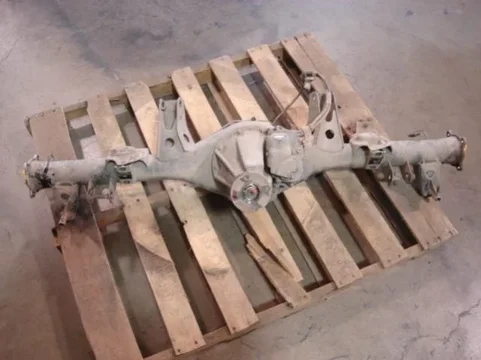

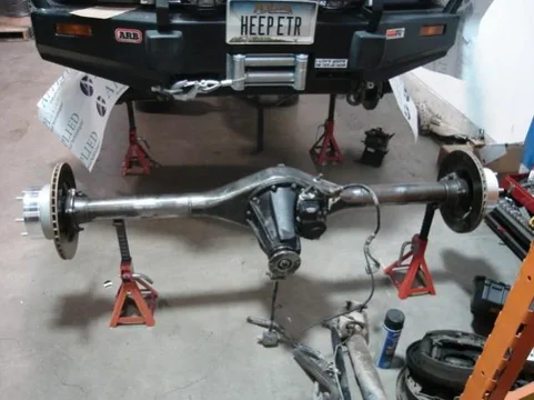

While I'm waiting on my crossmember from FROR and some link brackets I figured I get some more done on the rear. I managed to get the rear axle unbolted today.
Here it is out on a pallet.
3rd pulled.

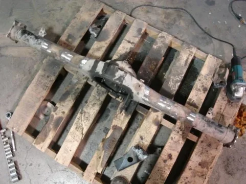

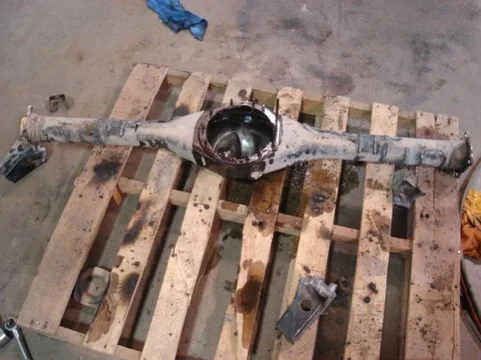

Here it is with all the OEM brackets cut off. It left alot of grinding but I didn't want to cut too close for two reasons. A little less heat into the housing is a good thing and oh yeah....I'm not great with a torch and didn't want to blow any holes in it.:Drear axle 011.webp
After far to much grinding!

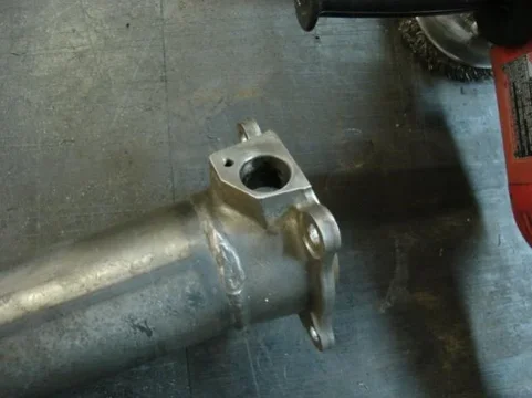

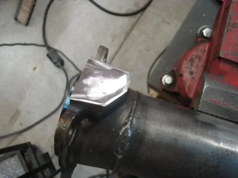

I am removing all the ABS stuff from the truck. Here's the ABS sensor port in the rear axle.
This is after it's been filled and buffed up.

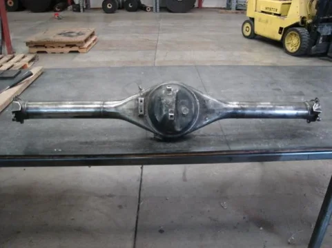

The rear axle cleaned up and ready for the next step.

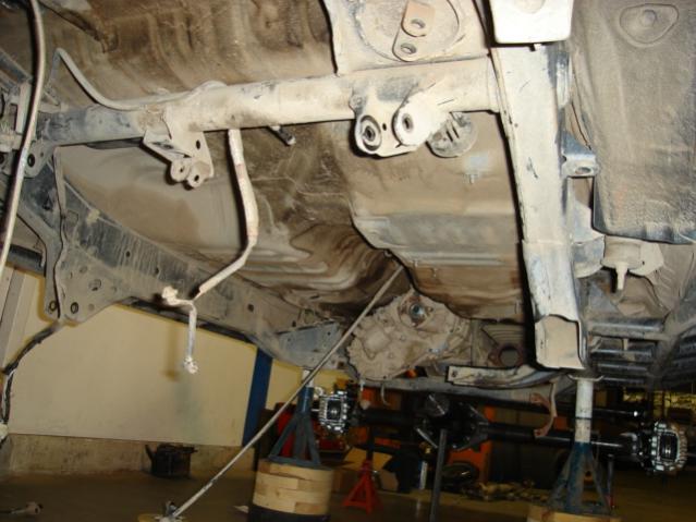

I finally got some time to work on the Heepetr. With a little help I managed to get the exhaust and gas tank pulled out. I'm really thinking 4-link and fuel cell looking at all the room I have now.

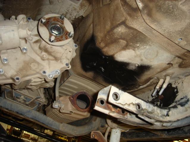

Got the FROR cross member in and was excited to get it installed until I found it didn't fit. Called FROR and was assured they'd never heard of this problem. Here's the under-body after some heavy hammering and a little bed liner.
The crossmember still did not clear and so I had to do some heavy trimming. This is what got cut off.

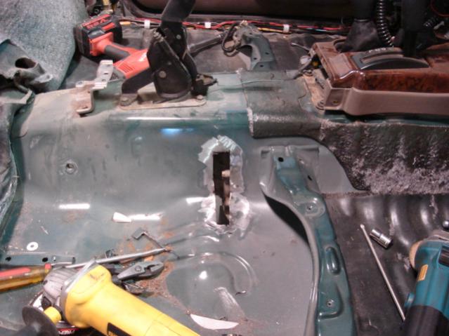

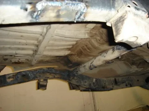

Well I found out today the T-case crossmember still didn't fit. I can't imagine I'm the first one to have this problem? Rather than cut the crossmember more I decided to cut the body instead. I will eventually be going to a dual case setup but I wanted to move forward with the suspension as is and need to remove the transmission crossmember asap. Here's part of the body cut out next to the T-case.

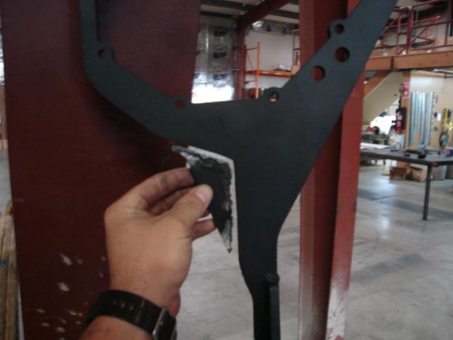

I couldn't find any sheet metal around my shop so I cut a dust guard off of an extra IFS spindle I had laying around, pounded it flat, and cut a diamond out to bend into a internal cover. This is it tacked into place.

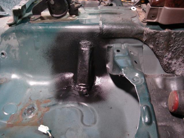

After some finish welding, a little STR sealant, and some bed liner. I'm really liking this stuff v.s. paint.

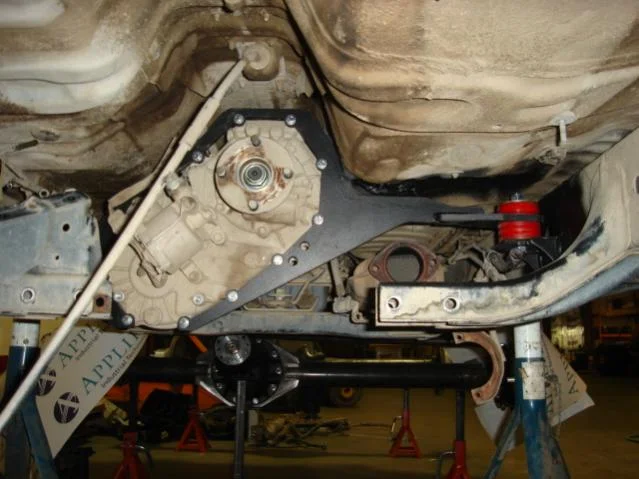

:cheers: Alex. I was able to install the t-case crossmember the other day. Here's its temporary resting place until I can get a second case.

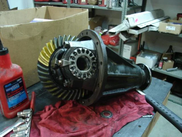

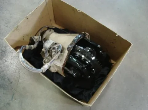

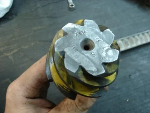

After the t-case I started on the gear change for the rear diff. Contrary to what I've heard the 3rd came out fairly easily with the locker dissengaged. Maybe it's different on an 80 or something? However....on the third try getting the pinion bearing shim right, the bearing gave me some problems. Trying to remove and reinstall the bearing without a press proved to be a bad idea. I cracked two of the pinion teeth with a 3lb hammer.:mad::bang:
After ordering a new set of 5.29 Yukons and building a 12 ton press I'm not sure I shouldn't have just payed someone to do it. At least I know it's right...?

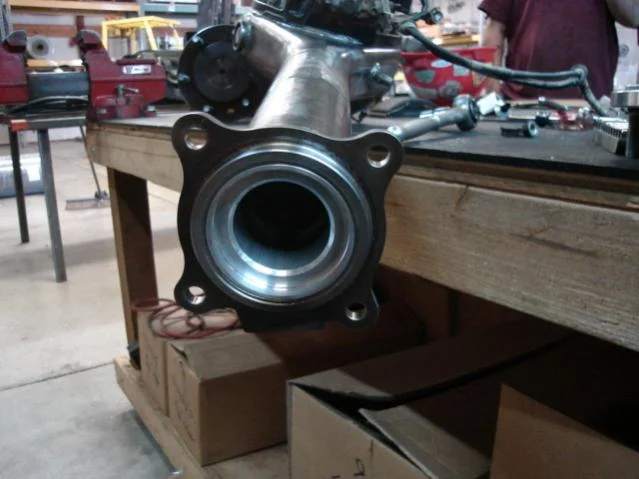

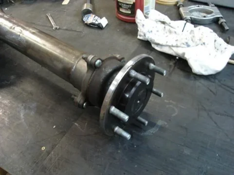

Here's the Marlin ABS eliminator spacer installed in the axle end. The Marlin HD seals installed into the machined area.

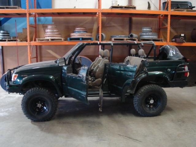

In the mean time I wanted to use the spray on bed liner on the plastic flares. They've gotten prett chipped up and thought they'd look great black. Here's the truck all sanded up. I got it taped off and painted tonight too. I try to get some pics posted tomorrow of it finished.
