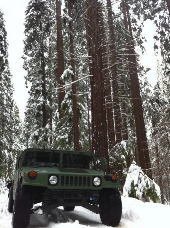

tossed in a pic of the hummer from a recent snow run. the hummer is cool and fun to wheel but it aint no 80 on tons

thanks for flipping my hummer

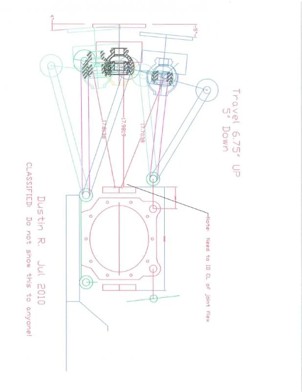

Mike this could be you
Did you start a thread for your buggy?
look in my sig. the build is on pirate but i havn't posted in a while. this buggy will be something special....
LOL. :D
At least you were out having fun.
Say hi to your dad for me.
he is having a lot of fun CADing the buggy parts
Drew you should see his new wheeler.
when is the next expedition?...
"classified, do not show this to anyone"
The internet is such a good place to hide stuff like that :)
