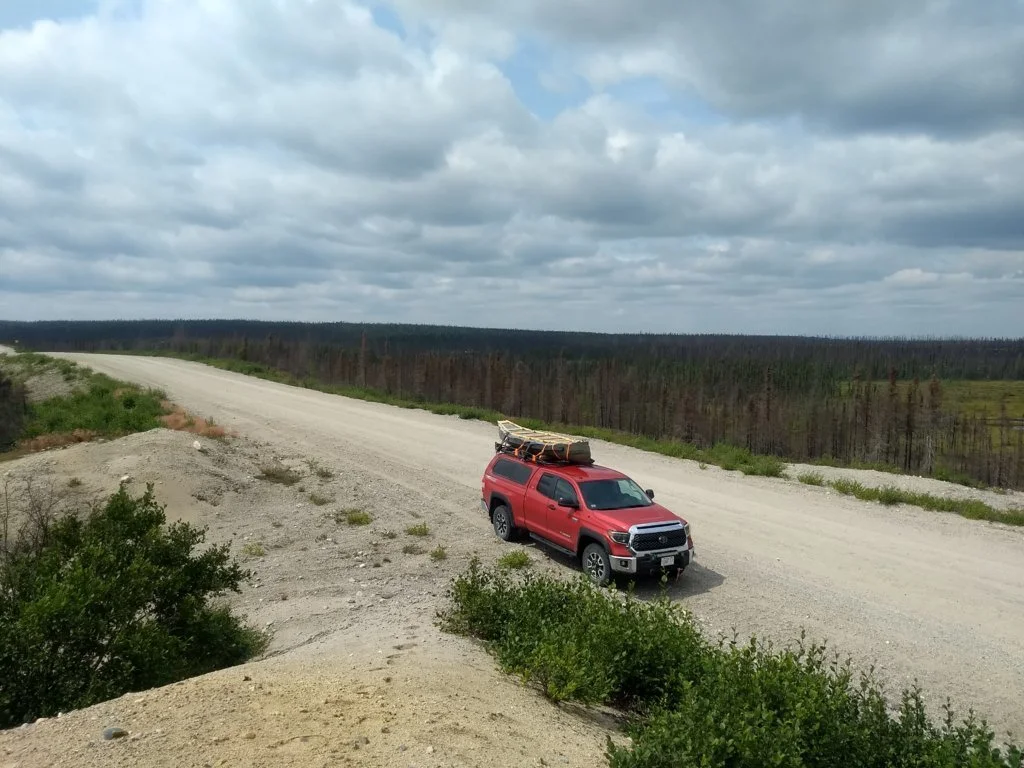

708 miles on less than 30 gallons, with wind brake on the roof - that's better than 23 MPG! 80 F weather, driving +/- 45 MPH, no braking, no accelerating. It stayed in 6th gear, torque converter locked up, engine revs around 1200 most of the time.
