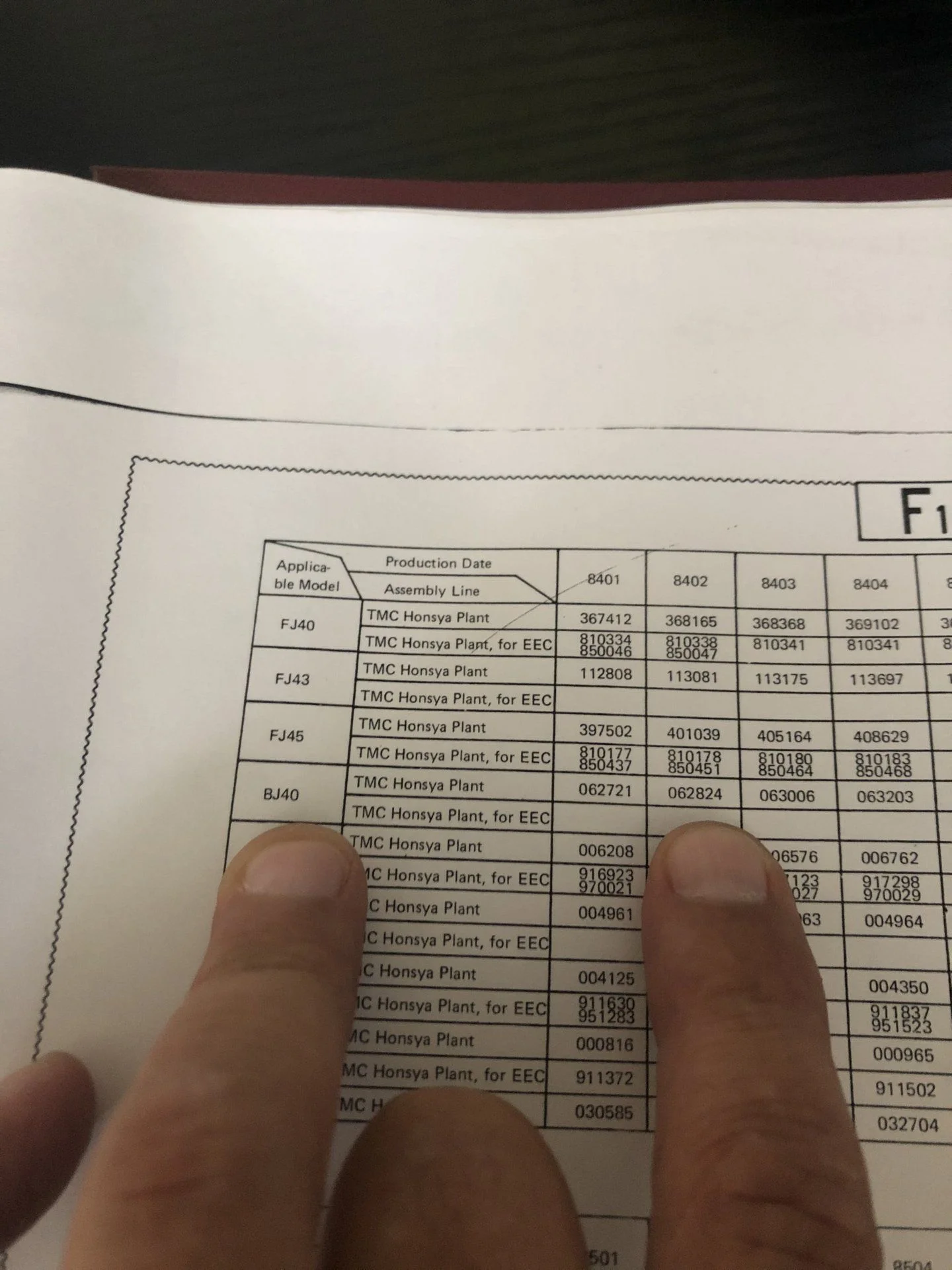

Looks like this will be a BJ40LV-KC. Most likely.
If this is a Colombian build, it will either have been imported from Japan as a CBU (Completely Built Unit) or as a CKD (Complete Knock-Down kit) that would have been sent to Venezuela and assembled there.
The frame number indicates the following:
Feb. 1984 manufacture plan started with frame number 62824. March 1984 manufacture plan started with frame number 63006.
So we are looking at 182 frames (vehicles) manufactured in 02/1984. Yours would have been the 134th frame to be manufactured during that month. So more than likely the 3rd or 4th week of manufacture if the manufacturing pace was consistent (and for a low monthly volume of this specific frame, it would have been thrown in the mix with the thousands of other LC's being manufactured during this time with different market-specific platforms and engines).
