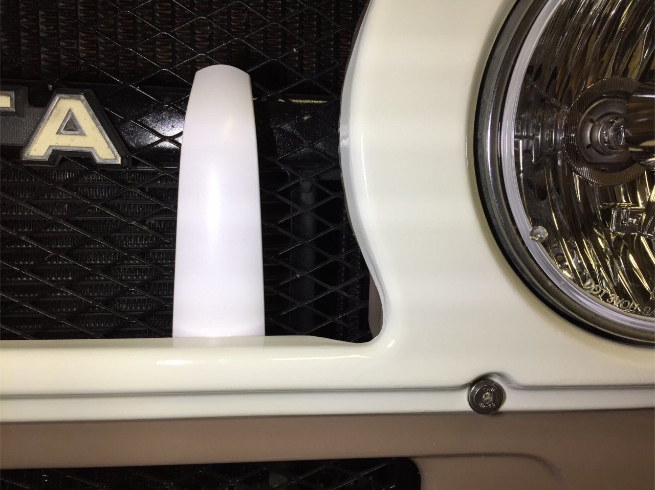

A close match to the OEM Cygnus White out of a can is Duplicor Wimbledon White. As seen below, the top bezel is painted Cygnus by a Toyota Body Shop and the bottom is Wimbledon by me. I think I went back and put a couple coats of clear on the Wimbledon and it darkened it up a bit.....

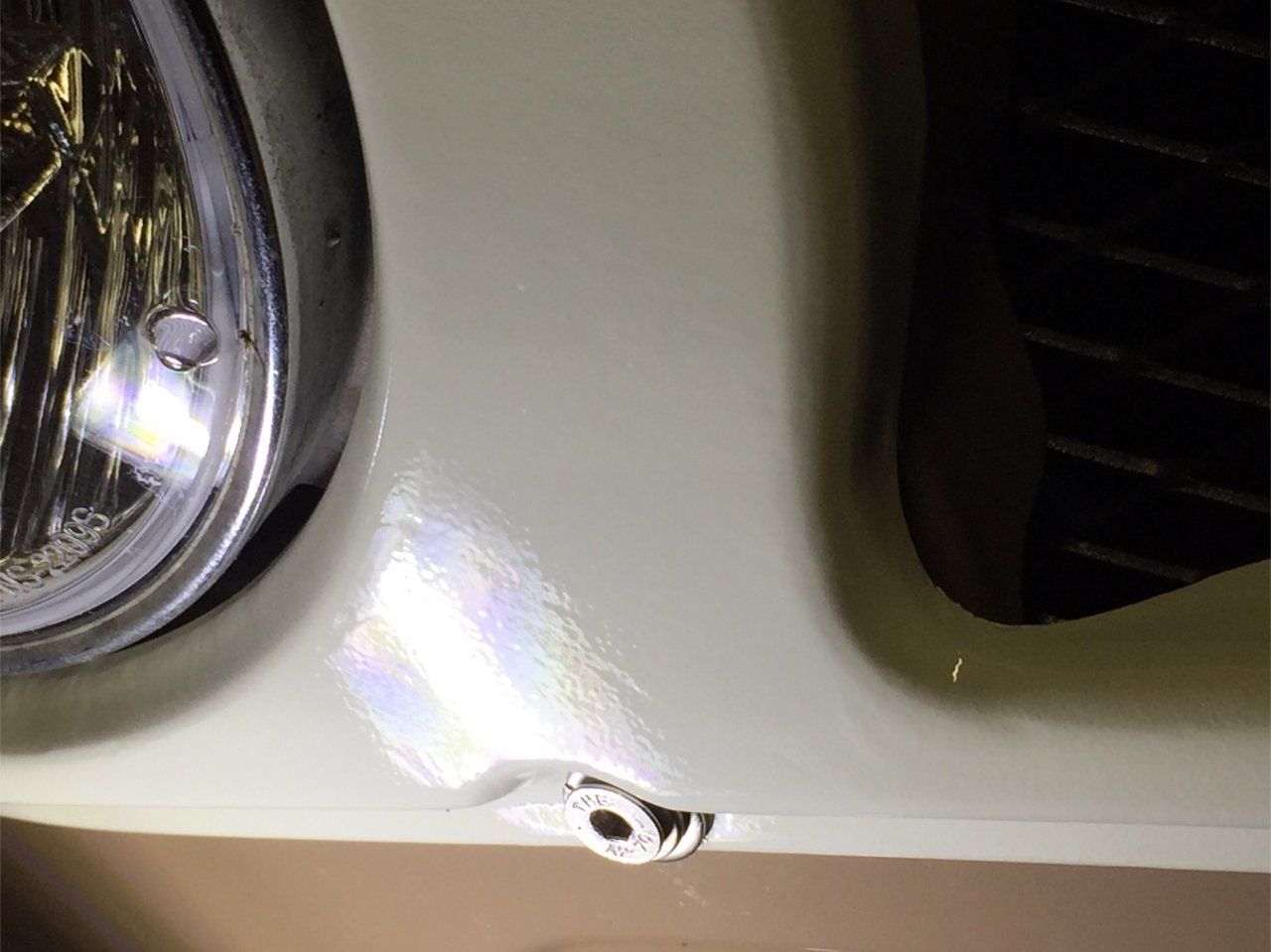

Here's Toyota 033 white with a stark white nintendo wii controller for reference.
a bit overboard, but I had the 033 custom mixed in a 2K spraymax rattle can. The Spraymax cans have a built in hardener pod you rupture before shooting. I wanted to use durable 2 part epoxy or "single stage" but didn't want to use HVLP for just a bezel. So I ordered a custom mixed can from Auto Touch Up Paint | Buy Car Manufacturer's Factory Paint

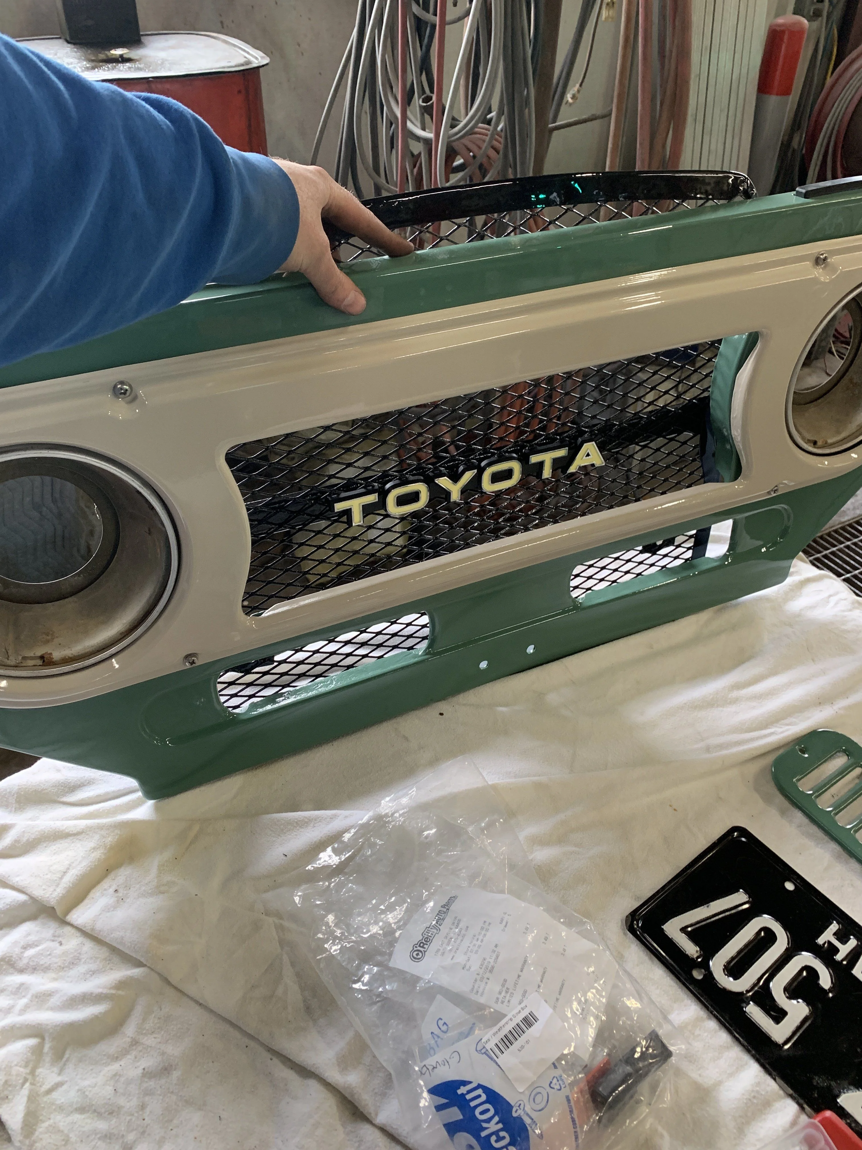

My top, wheels and bezel are all done in Limco Shell Ivory.

@workingdog I think your new bezel color looks great.
Like the stance of your rig. What tires and suspension kit do you have? Stock 40 axles?
Love that color with the green. I agree on the off white on vintage rigs like a 40.
