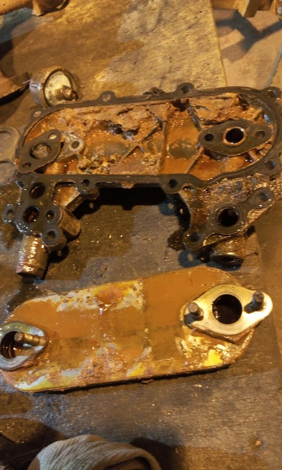

Engine cooling system flush PO used tap water
i was advised against this!!
You'll have to pardon me for misunderstanding the above post.
Tap water in Israel are very hard and salty total no no for engine
coolantView attachment 1597616 View attachment 1597617 View attachment 1597618
