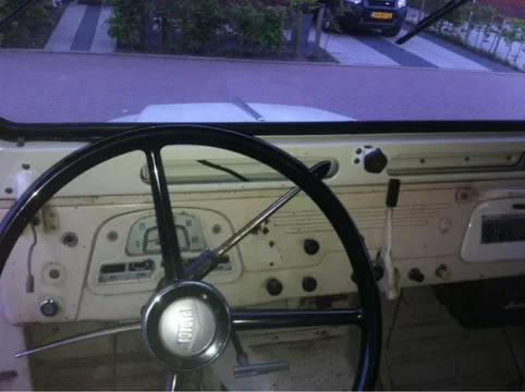

FJFJFJ / 1962 fj40 build / a few more pics.
Hello you guys,,,,,,,,,,,,,,,Here are a few more pics. Am hoping to be done within a month. Thanks again for all the help I have gotten from MUD members. A bunch of great advice, parts and inspiration. Will post more pics when I get them. FJFJFJ
Wow. It's going to be one of the nicest cruisers out there where you're done. Plans?
beautiful, nice work and thanks for preserving a piece of History....
Didn't the very early 40s have a white gauge face? Ill have to go check my pics but I'm pretty sure my 1963 (actually made in 62) hade the white gauge face.
Edit. Or was it silver. Pretty sure it wasn't black though.
Hello Girraffe,,,,,,,,,My Gauge face is the original. Oil and Chg are the correct lit up gauges also. I know what you mean about white gauge faces though. Hello Tjhaga,,,,,,,,,,,,,,,,,,those hose clamps in the picture are my originals. Just restored them. There is a place in Escondido California ( I will find out the name for you ) that sells those type clamps though. Not sure if Toyota sells them. fjfjfj
