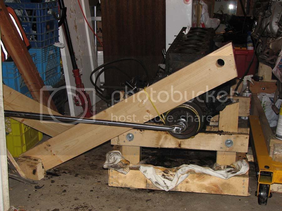

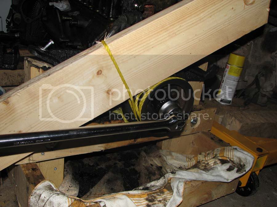

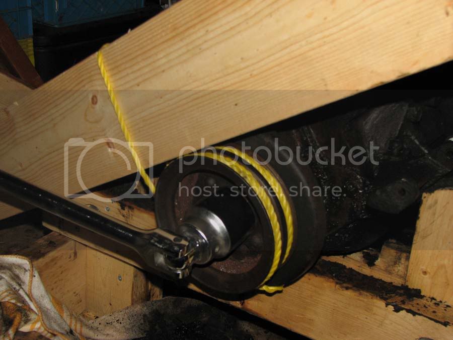

Thought I would share the trick I used to get my crank nut off with the engine sitting in a cradle, and without an impact wrench. The rope is wrapped around the pulley 8 or 10 times then looped around a 2x6. The 2x6 is levered against the floor to hold the pulley/crank stationary once the slack is taken up. I'd say it took somewhere around 350 ft-lbs to break the nut loose.

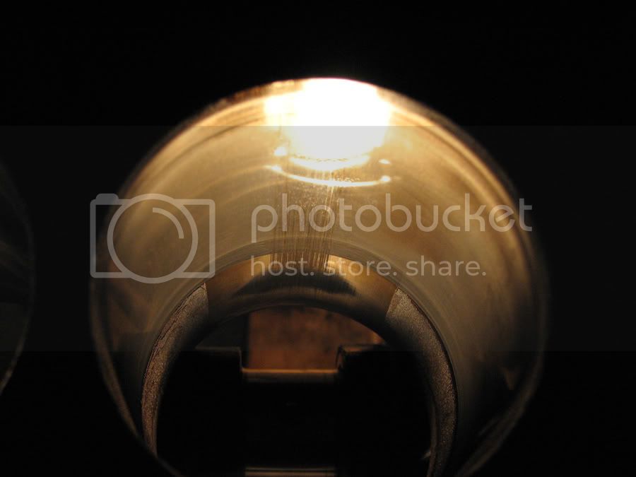

Got the pistons/rods out this afternoon. First couple went slow till I worked out how to do it, and the last 4 went like butter. I'll get some pics of the pistons and bearings and post them tonight when I have some time, the scoring of the piston skirts looks similar to what came out of Marshall's Big Gay block, although the pistons themselves seem to be different. So..... think I'll be getting new pistons and having the block bored out a bit, but I'll solicit opinions when I get the photos up.
Here's a shot of the cylinder wall off #1, all show the same scoring/scuffing to a degree.
