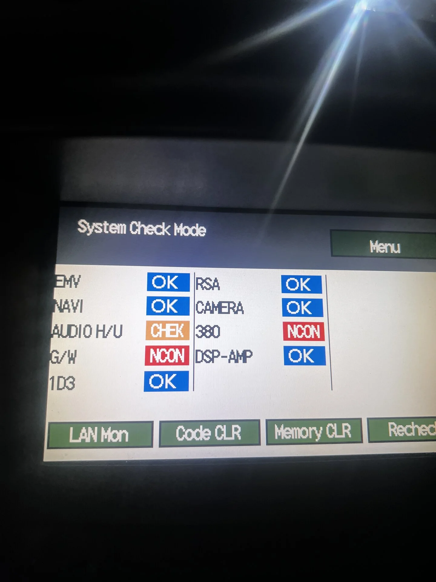

This is a long-winded way of the following: I pulled up the factory service manual and attempted to jump to wires that based on what it said, I believed, would cause the regulator to go up. What happened was I heard a loud pop and then a flash of light and then I was instantly unable to start the car

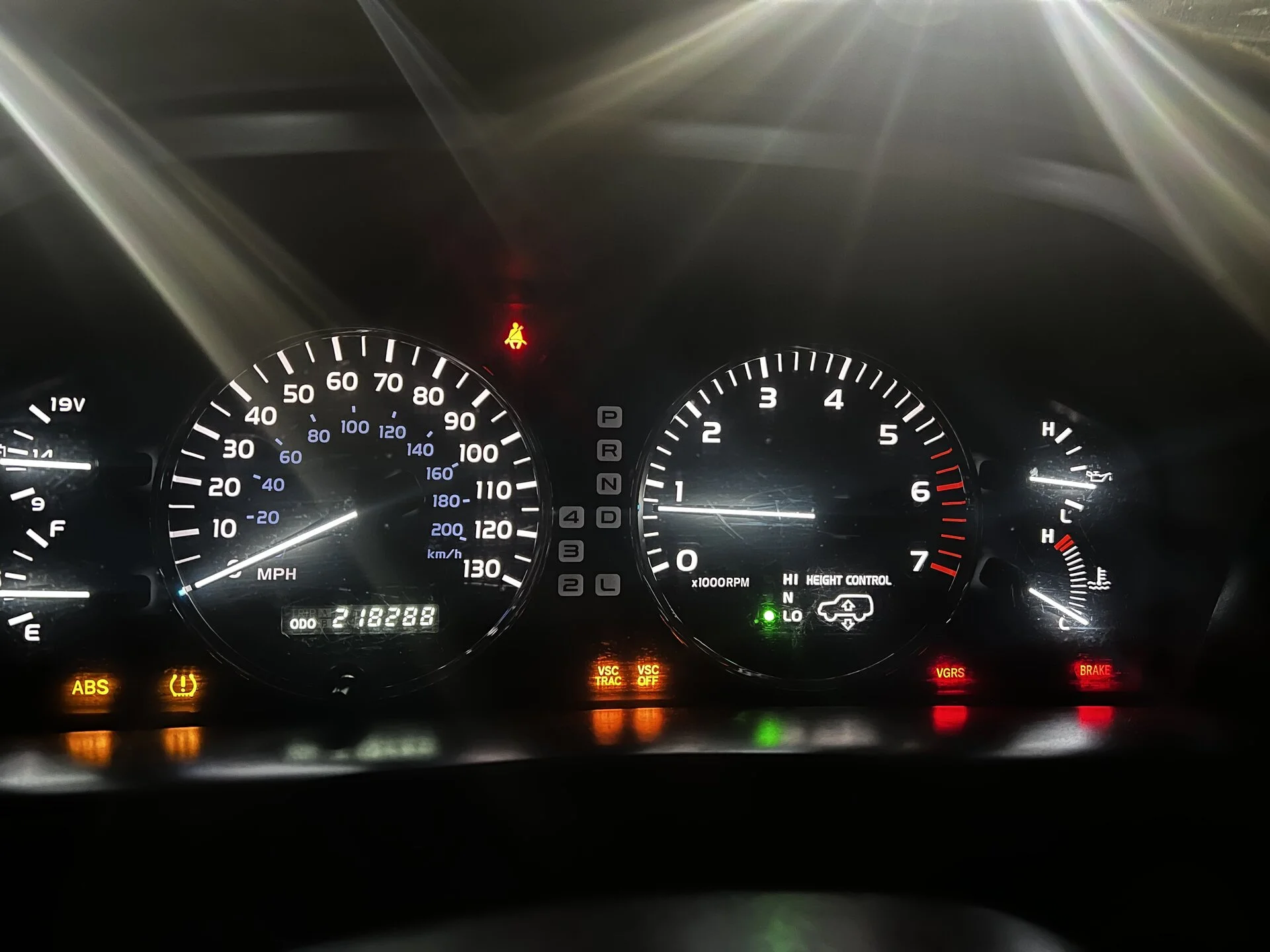

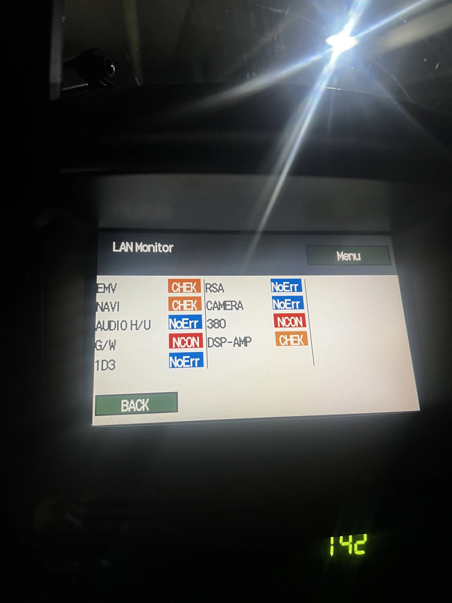

I then jumpstarted the car and was greeted with this lovely dashboard display. All of these lights are new. I was also unable to move the car out of park until I use the shifter override. all engine fuses look good and the ODB fuse also looks good. How ****ed am I

I think I blew out the cowl side l/h junction block if I had to guess. I’ll update. It’s getting towed to the shop soon
So it was 2 fuses (I only ID’d one) both ECU fuses.
