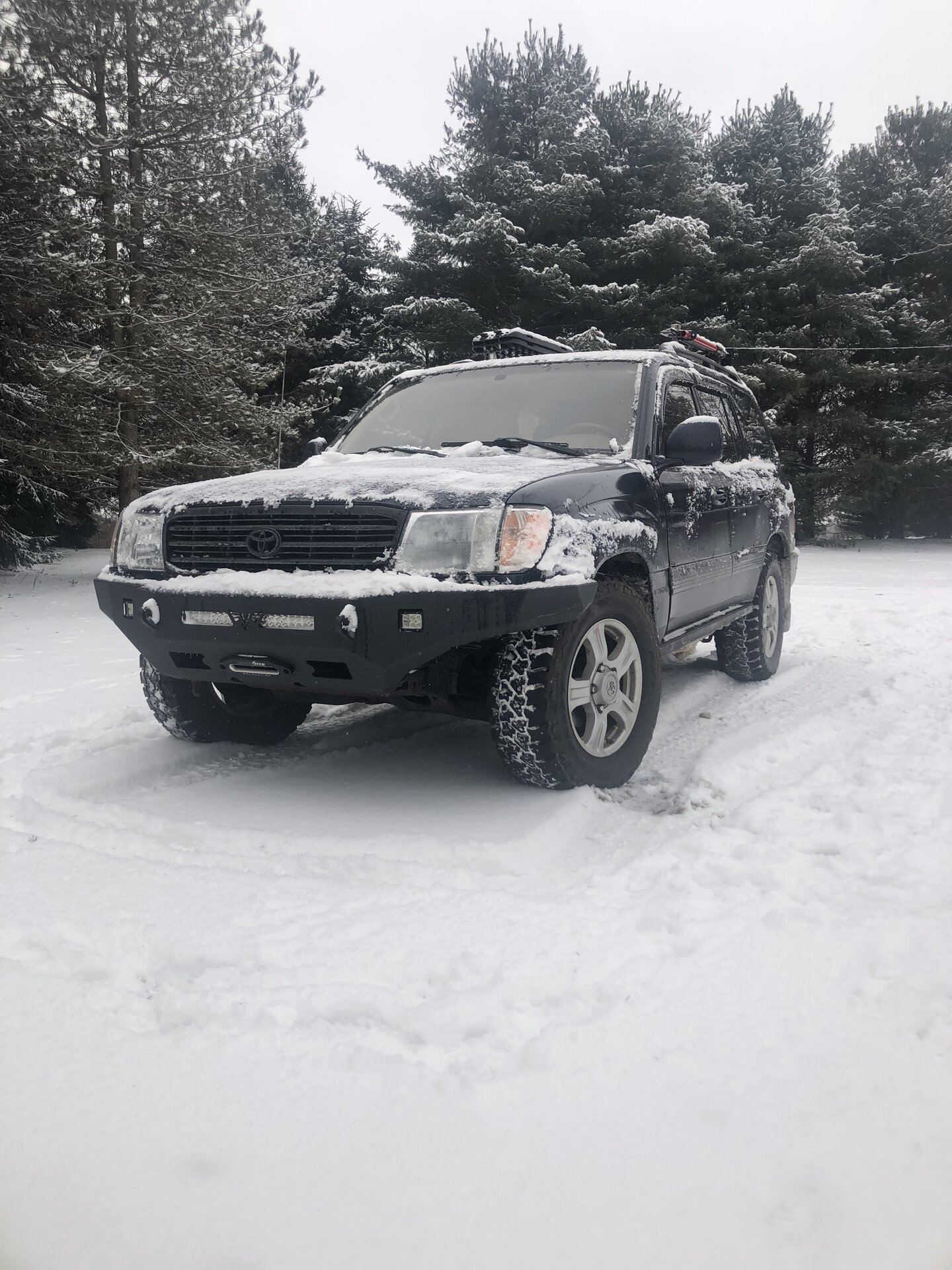

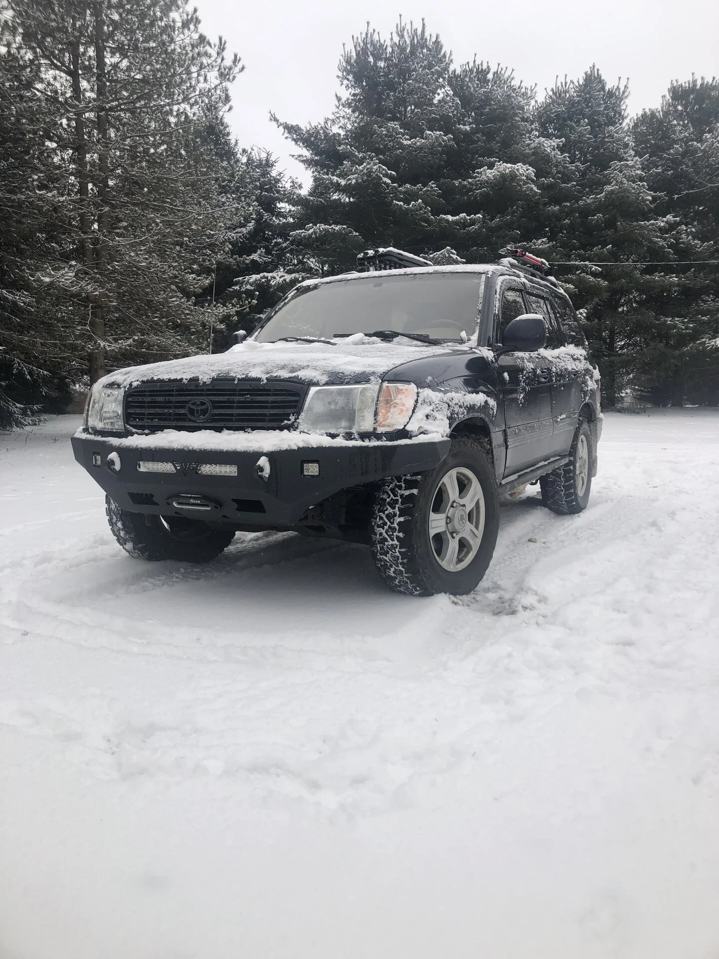

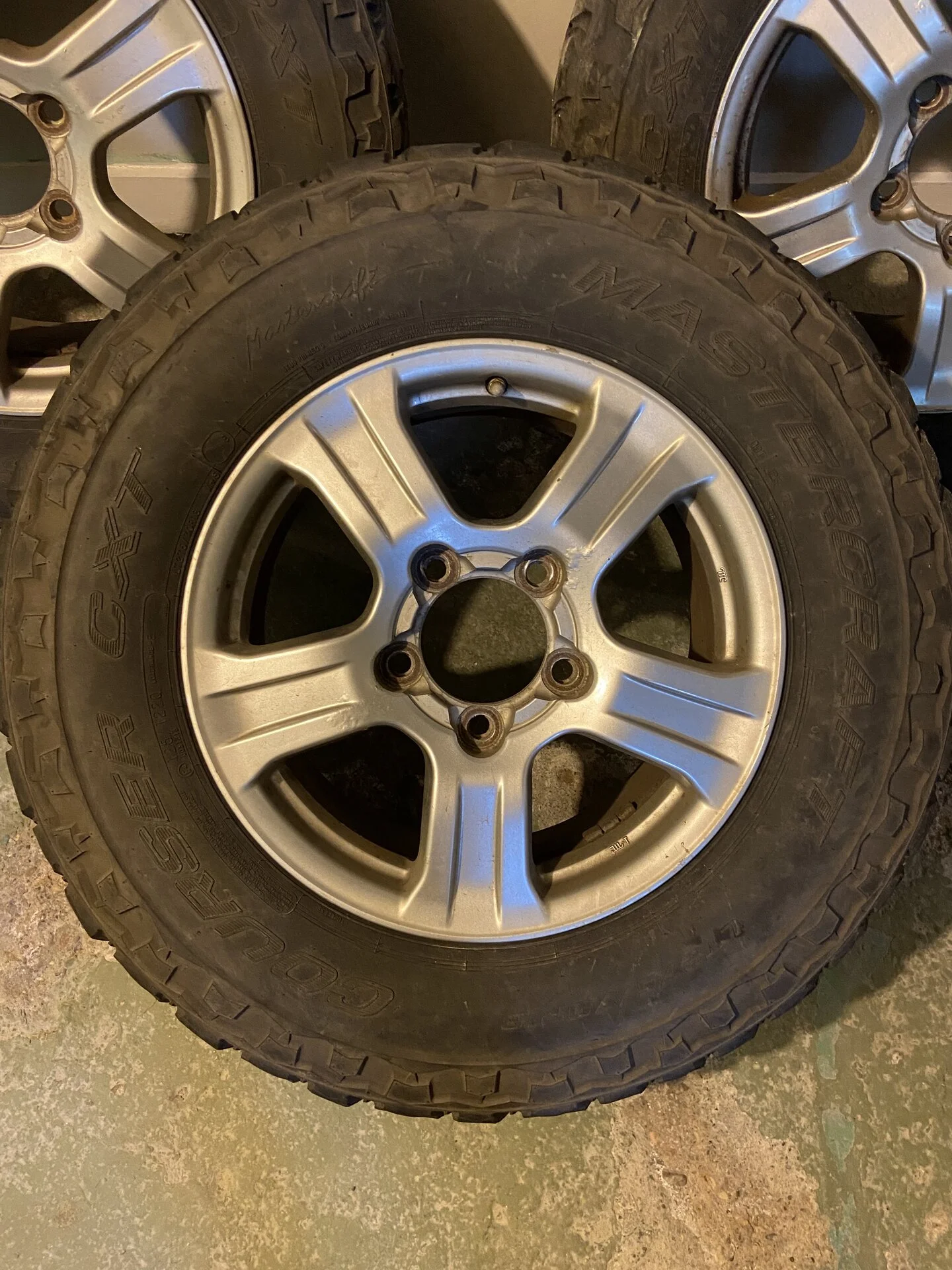

That is a 2007-2013 18- inch Tundra wheel.
It has a center cap from a 16-inch 100-series wheel to clear the front hub grease cap. The Tundra center doesn't fit over it.
Some use wheel spacers in order to fit the Tundra center caps or use a hole saw to clear the grease cap.
Search for Tundra wheels on 100-series.

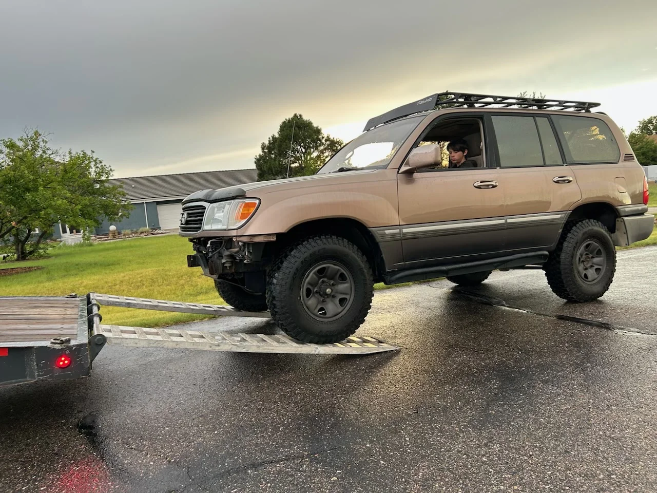

100% confirm they are Tundra rims 18” with the 16” caps. I ran them like that for a while. Pictured below on and off the truck with 275/70/18
Did you have any clearance or rubbing issues, probably want to stay 16 or only go up 17. Really not a fan of running spacers either.
No spacers and no rubbing. That was before I chopped my rockers out. If you look closer in the photos, you’ll see the rockers are now rectangular tubing. I now run 305/55/R20 with no rubbing, no spacers, and no lift. That said, if I hit bump stops up front I do scuff my upper inner fender liner slightly.

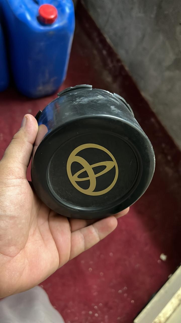

These are what I'm getting, including caps and lug nuts.
Know a guy here in the US that has a contract over in Saudi Arabia.
It will be six months before I see them as they will be in the back of a vehicle he's working on importing.

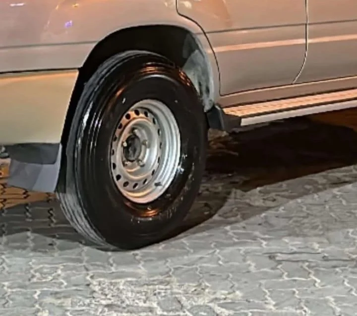

Those steel wheels you have pictured, are those JDM or European market 100-series wheels. In the Middle East, all the ones I see are the steelies like I got, or typical aluminum like what the US market has.
Don't know, PO called them "Rest of World" steelies so "Non-North America" OEM but I'm pretty sure they aren't JDM. I think someone identified them as readily available in Australia in another wheel thread. I'll try to find it...
Edit: LOL, I said the same thing about those center caps in this thread that I apparently started looking for advice on wheel spacers.
A gentleman from Brisbane ID'd them as optional on the 100 in Australia.
