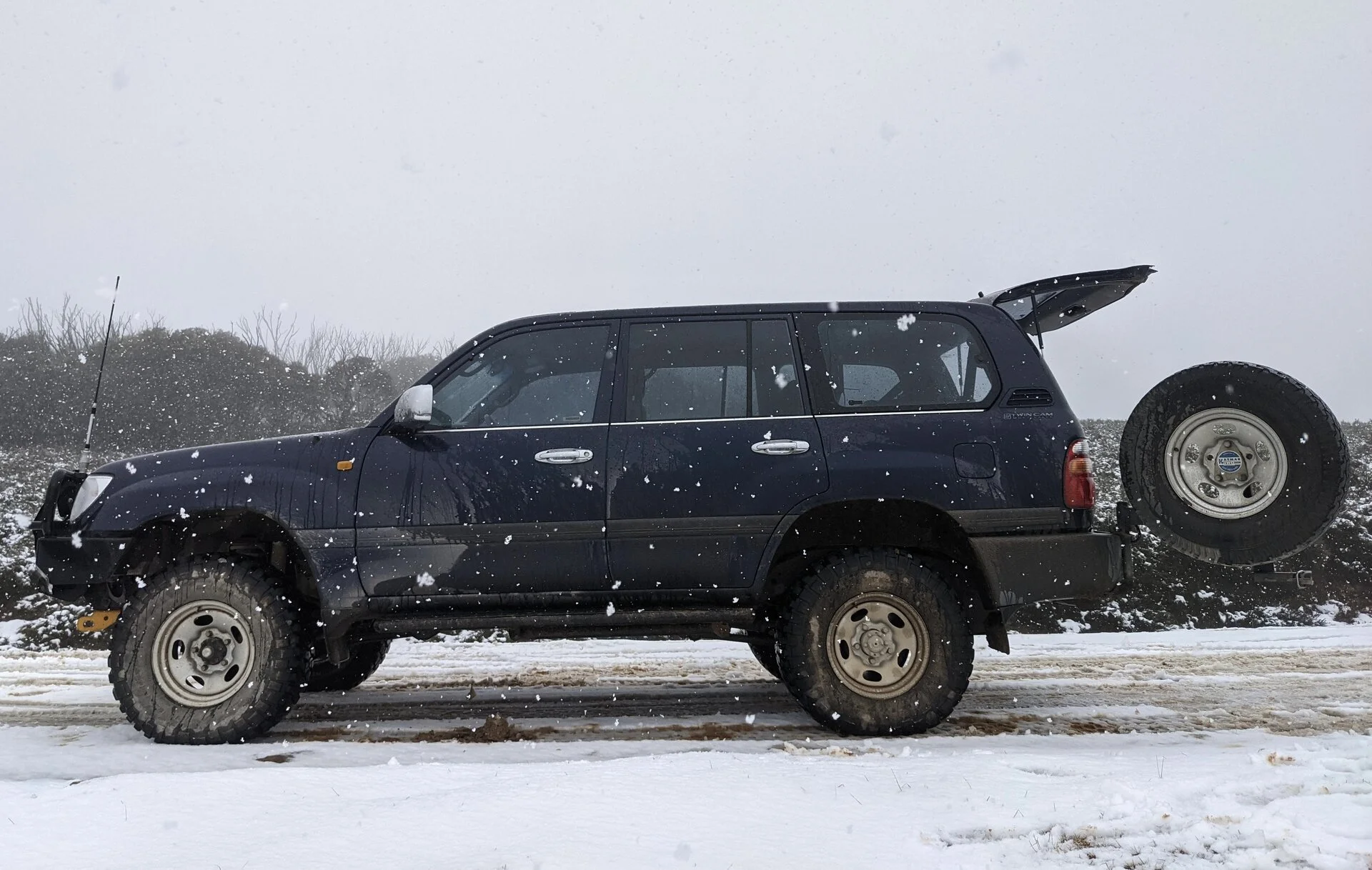

Hoping someone can point me to a part number for a 16x8 oem steel wheel.
Photo below on a 105 but I believe the wheel is a 70 series part. Any help is appreciated!

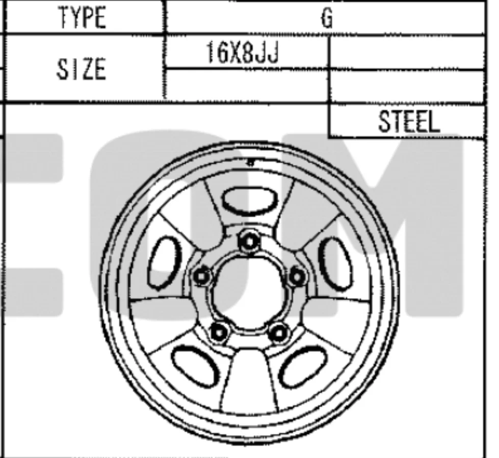

42611-60200 is the 105 wheel. There has never been a 16x8 wheel factory-fitted to any 7x Series variant.
The bolt pattern is the same as the later 7x 5 lug hubs but the offset is different.
I think you're looking for: 42611-60200
I believe these are for 105 series specifically, so the offset or width could be incorrect/different for a 100 IFS
Those are the ones, thank you! Spent quite a bit of time trying to dig those up.
