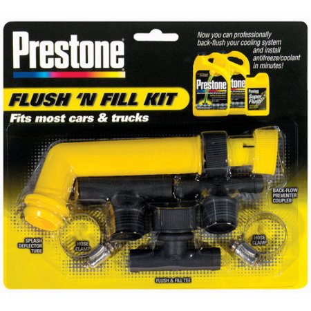

the best thing iv found for cutting hose nice and neat is a PVC cutting tool, cheap at harbor freight, looks like funny garden cutters, makes square clean cuts every time.
id pick good locations to cut each hose and install a Prestone T on the motor side. connecting your in and out into each other allowing a burp and circulation.
on the fire wall core side id just leave it open or blow it out with some air. because you will be in it soon enough

Found some antifreeze on the passenger side floor.. I was wondering if I can plug off the hoses that goes to the heater core? Would this have any negative effects??
My idea for the a plug..
