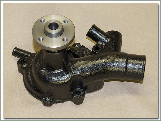

They’ve sent me two now and neither fit. The SOR One I Need is 054-024F-1b-2. That one is discontinued and they don’t have . I actually bought the one in the picture. Thanks though for the help. Sincerely appreciate it. If you have any other thoughts , I’d love to hear them.

Water pumps differ depending upon whether you have a fixed fan or a fan clutch.

59035 pump is not available anywhere that I can find. Only fits the B and early 2B engine fitted with the fan clutch.
Pumps for fixed fans are available.
I'm not currently in need of one, but looking at a rebuild as the only reasonable solution.
