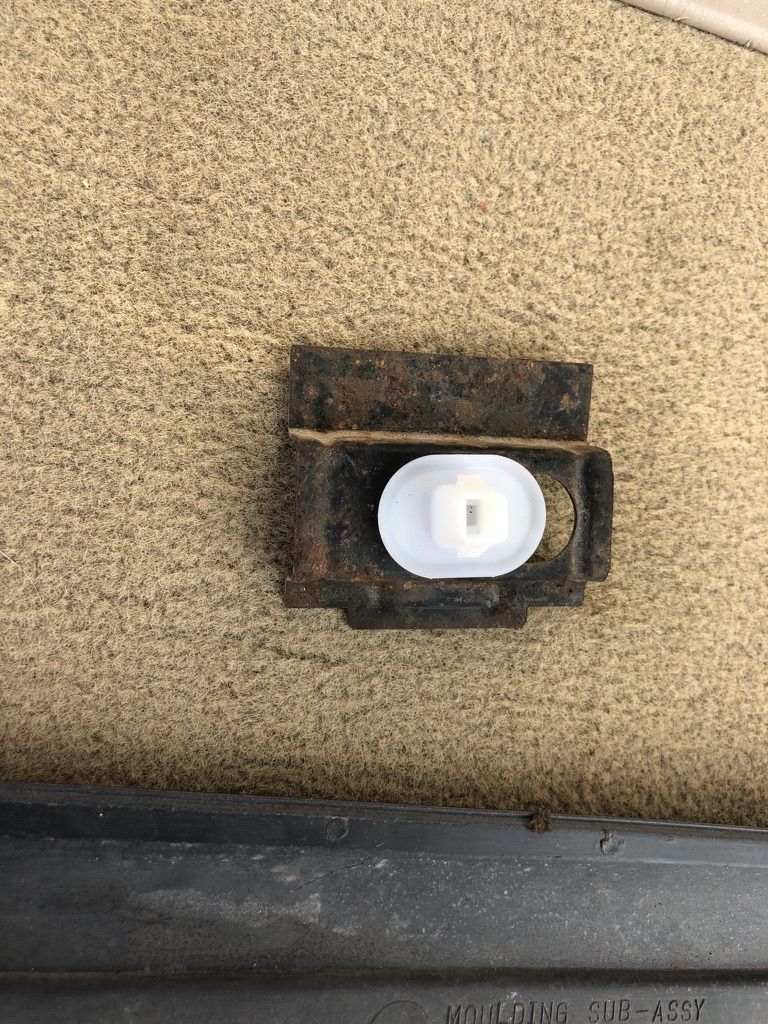

Need help finding one of these for my LX cladding, anyone know a part number?

Are you looking for the white clip? or the little tab? If it's the tab you can't replace that without getting a new cladding piece.
Ahh ok, I am looking for the tan piece! I am going to need to fab something up :)
