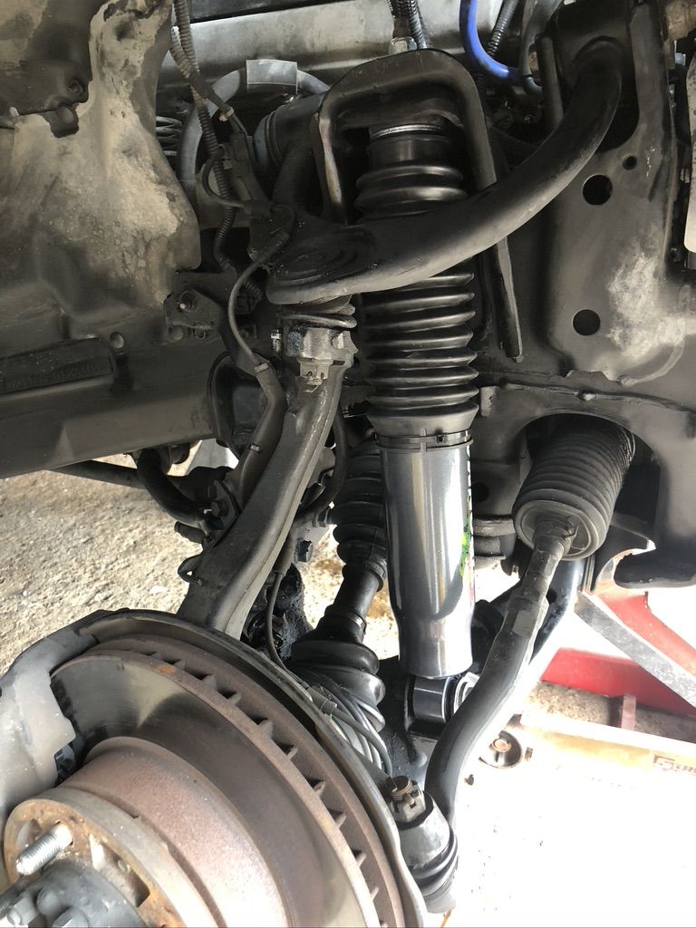

It has been a while since my last post, a ton of progress going on. First up are some photos from my suspension install and the first views before any height adjustments.

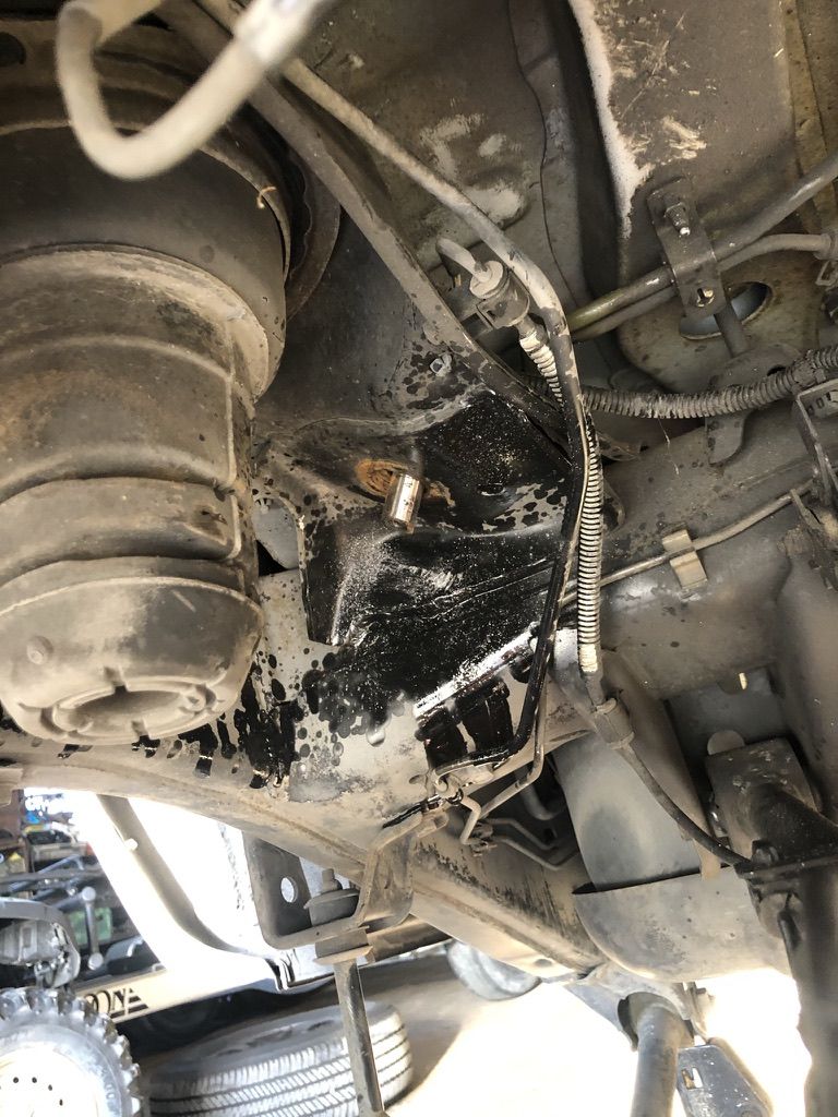

Of course, I broke off the ABS sensor bolt, been hitting the gym too hard apparently!
Got a replacement and used cocoa butter petroleum jelly for the CVs until I can replace them, everyone knows the scent makes them last longer...

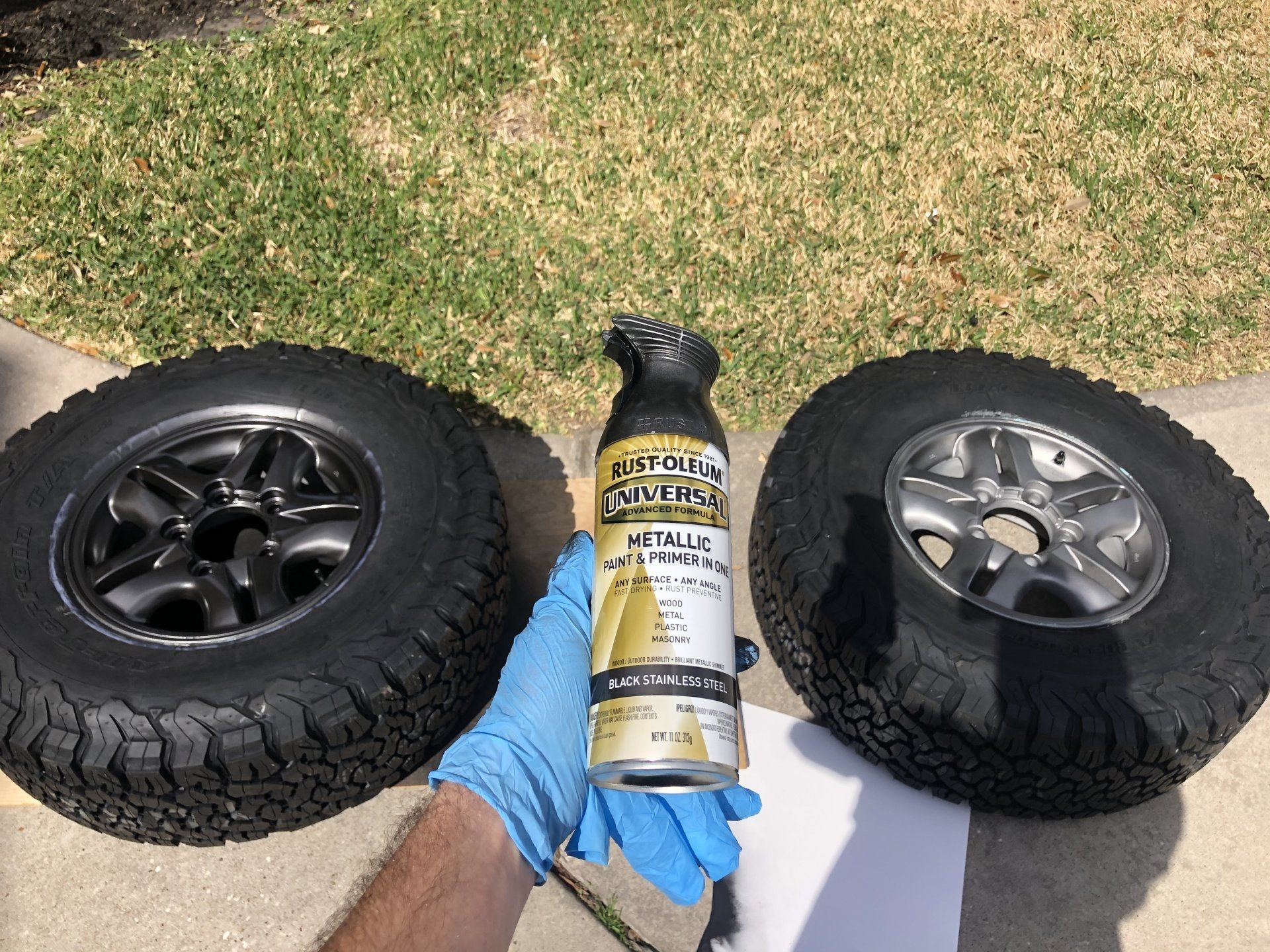

Scored 285s of a fellow cruiserhead in Houston, he had them sandblasted with a base coat of paint. I found a very close color of Rustoleum and threw on several coats. Future pictures will have matching caps.

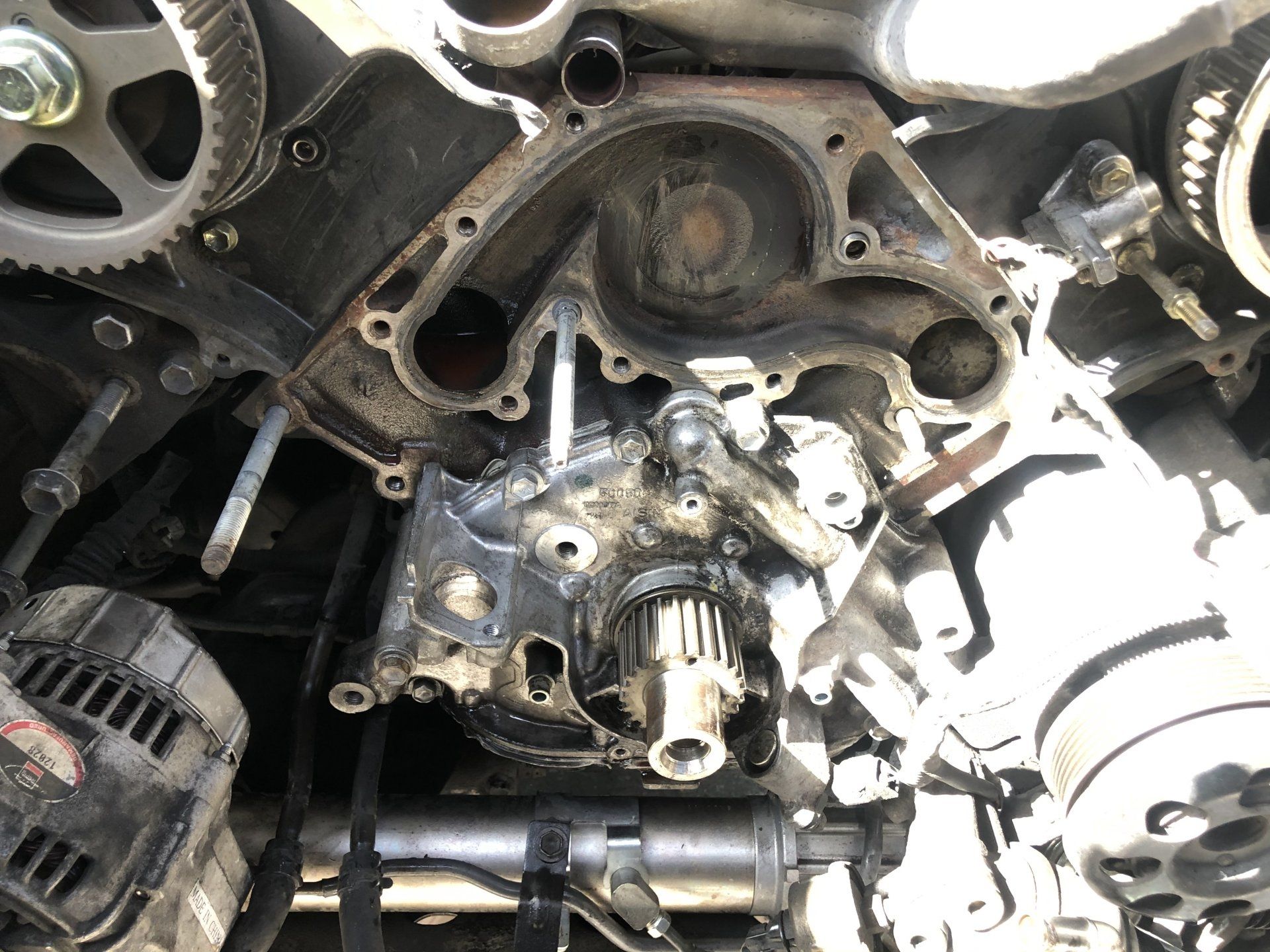

So a few weeks back the LX was out of commission for a week. When I got the truck back from alignment the guys at Bearden Automotive in Austin (great Toyota guys) helped diagnose a rattling I had been hearing from the engine bay. Turns out the Fan Pulley bearing was shot, it felt super risky driving it home, but once I made it I decided it was time to do a ton of PM while torn down. I went ahead and did the full water pump and timing belt kit, new Aisin fn pulley, and misc. hoses along the way. Sorry about the lack of pictures in many of the steps, I was more worried about getting things correct, this was a great example of how valuable the advice is from the MUD community. Super grateful to anyone who chimed in!
Here is what was replaced... would not recommend haha

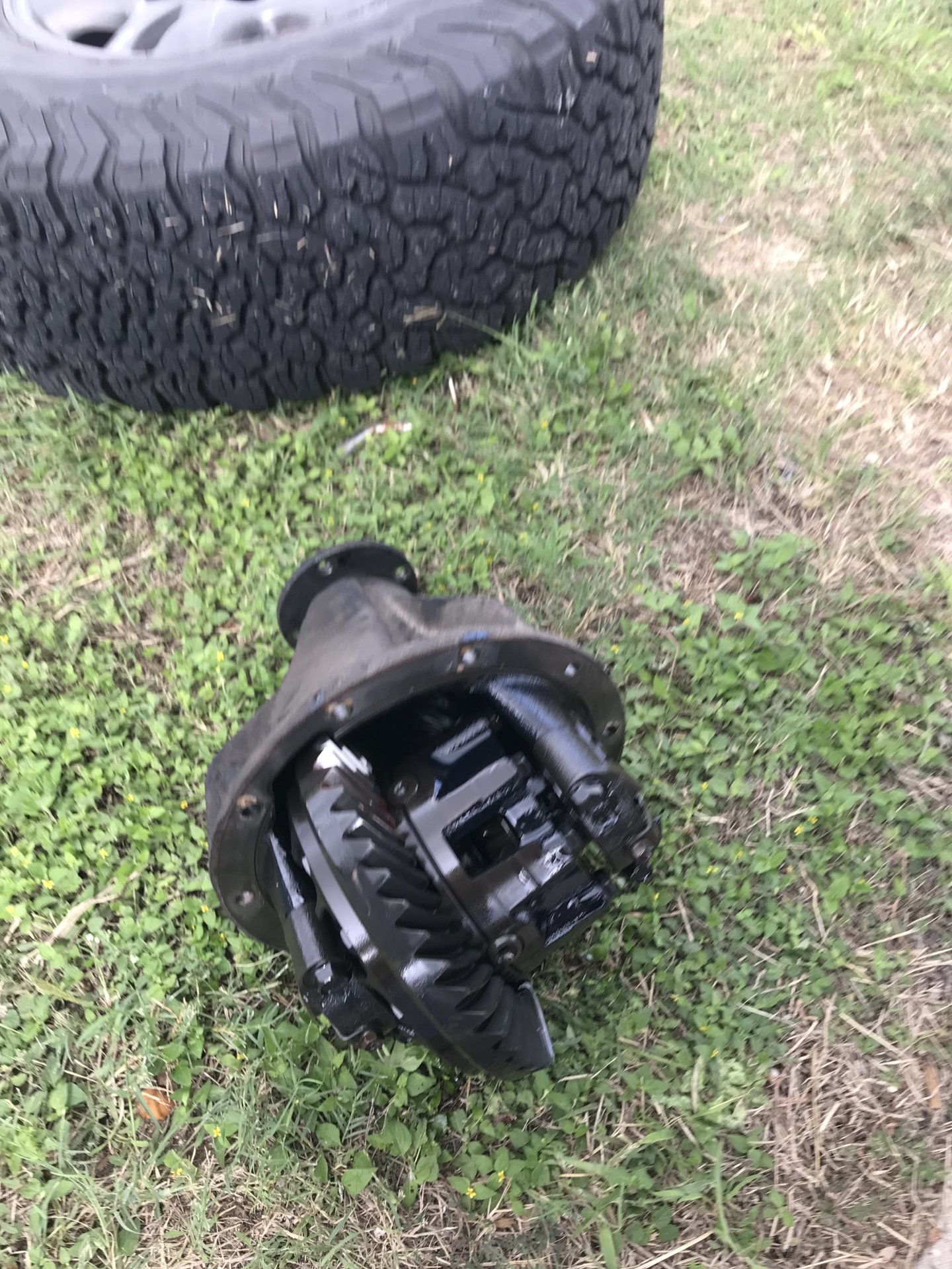

After about 3 months of whining I decided to swap out the whole third member with a gently used one. It gave me the chance to inspect the inner axel shafts and bearings as well. You can see at the top of the ring the shiny section contributing to my noise. I was very happy to find a very clean Differential housing. I plan to slow build the extra third member with a locker of some sort, recommendations are welcome!
