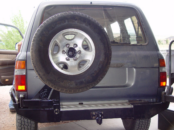

Wow, you really need to get better photos up because I could not understand this whole thread until SnakeEater posted up WildYoats photos. Now I get it and definitely a cool idea and no reason a Drawtite Hitch would't work with it for those who tow serious loads!

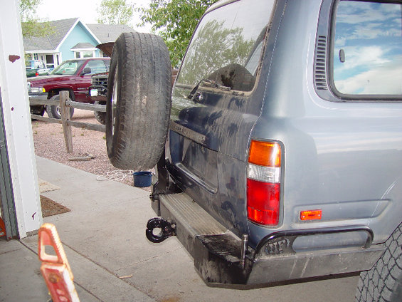

Maybe this will help. Yes the Draw tight hitch will work with the bumper wings. We test fit a 38" TSL on a steel rim on the carrier and got no flex and it didn't block the taillight. Then I stood on the arm in addition to the tire with very minimal flex while the carrier was in the full open position total weight about 400 lbs. These are stout and I have no doubt that they will hold up. I'll get more pics soon showing the testing as well as with a tire mounted and the other side swing out. Ran out of time today to get it all done.
Got a pic with the tire mounted as well.

I'm loving this thing! I'm really amazed by the fact the my view out the rear window isn't completely obscured. I could still see the passenger of a 90's camry behind me at a stop light. Some of that will change when I have a 37" spare and I'm lifted, but this thing is great. I'm excited for the passenger side accessory bar to be completed too!

Can you post some pics of what the jerry can holders and the ladder look like? Also what a pair look like without the hoops and the rear mud flaps intact for those wanting to maintain the stock look.
I will post up pics when they are built. As far as one without the side hoops and with factory flaps and fender flares I can when someone orders a set and takes pics. Since I don't own an 80 I am stuck waiting on other peoples vehicles for pics. Sorry

I am sold on the strength of the wing, no question there. Can those 4 mounting bolts handle the same abuse that this wing gets? Are those 4 bolts the weak link?
Yeah the 4 bolts would be the weak point but they will hold up to beating on the bumper. All hardware is included and all hardware is grade 8 for maximum strength. Part of the strength is that it is bolted on three different planes. Basically it would require a tremendous hit to sheer 4 bolts that all are mounted in different directions.

I paid about that for an entire IPOR bumper - and it is as solid as you can get. No comparison, in my opinion. Whatever floats someone's boat though. Hopefully these satisfy a need in the marketplace. For half the money, I think they'd be a reasonable solution for lots of people. I agree with others - at that price, you might as well go with a full bumper. I'm not an engineer, but I have to imagine 1/4" steel all the way across bent around and bolted to the factory cross member is a little stronger than the handfull of bolts holding those winglets to the cross member. They make nice levers though. :-)
