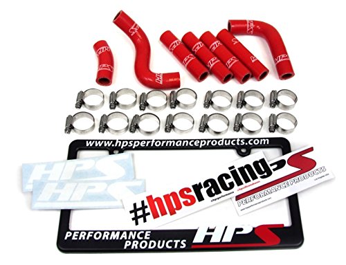

  • Replace FZJ80 stock OEM rubber pesky heater Hoses (aka phh) and the firewall heater Hoses which can eventually weaken over time, leading to premature failure
  • Withstand the harsh high temperature and high pressure operating conditions of the engine yet still maintaining peak efficiency during competition or daily driving. Max Temperature Rating: 350 deg. F (177 deg. C)
  • Perfect fit replacement for your OEM rubber Heater Hose, it is not a cheap one size fits all universal hose you get at the local parts store that you have to fight with to install
  • Includes 100 percent stainless steel industrial grade liner clamps which would not cut thru the silicone hoses.
  • Vehicle Application: Lexus 1996 1997 LX450 FJ80 4.5L I6
