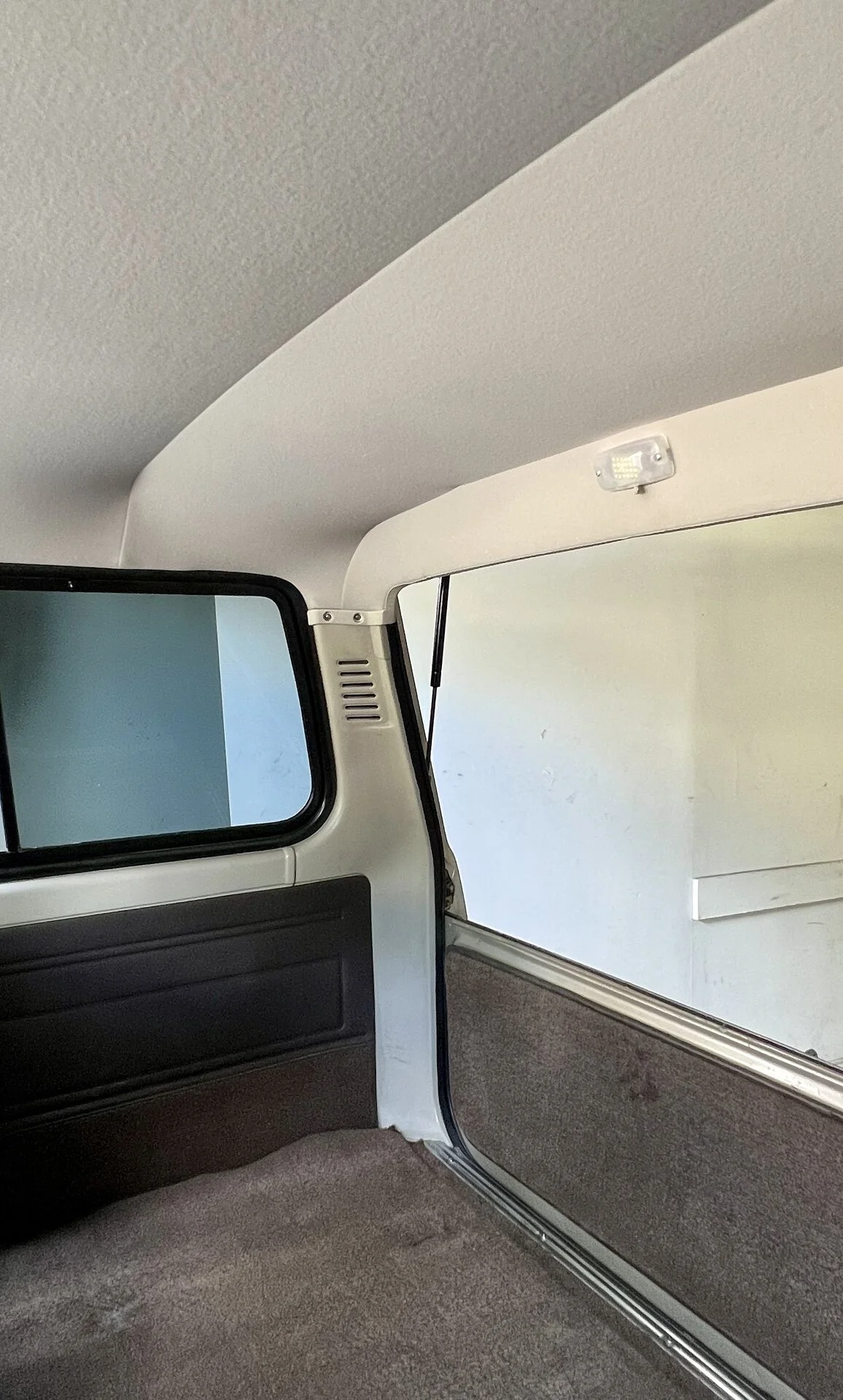

I put in one of their vinyl headliners and am very happy with the results. There was no odor and easier to install than I thought it would be.

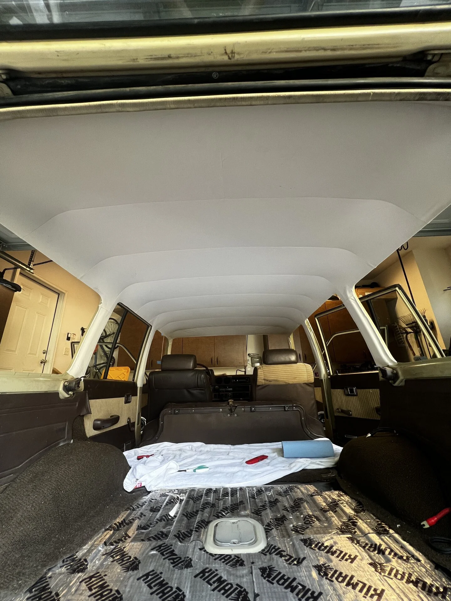

Looks great. Did you install yourself? If not, what did the shop charge? I have a separation at the back window and was told the whole thing has to be replaced and was quoted $2k plus material at the first place I went to. Getting another estimate.

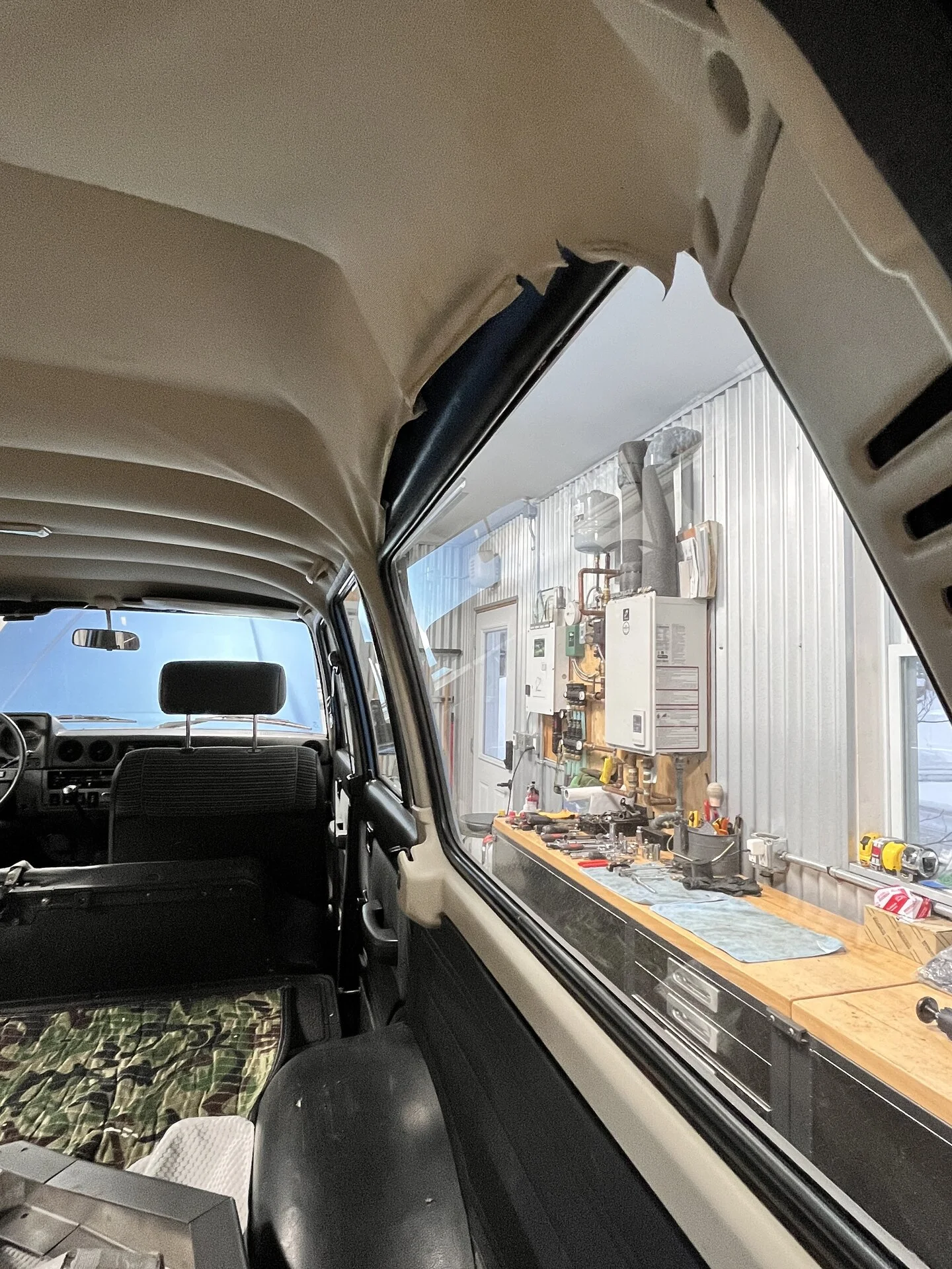

@Dekeman, yes CC has both vinyl and cloth. On sale 15% off until tomorrow but they seem to run that deal a few times a year.

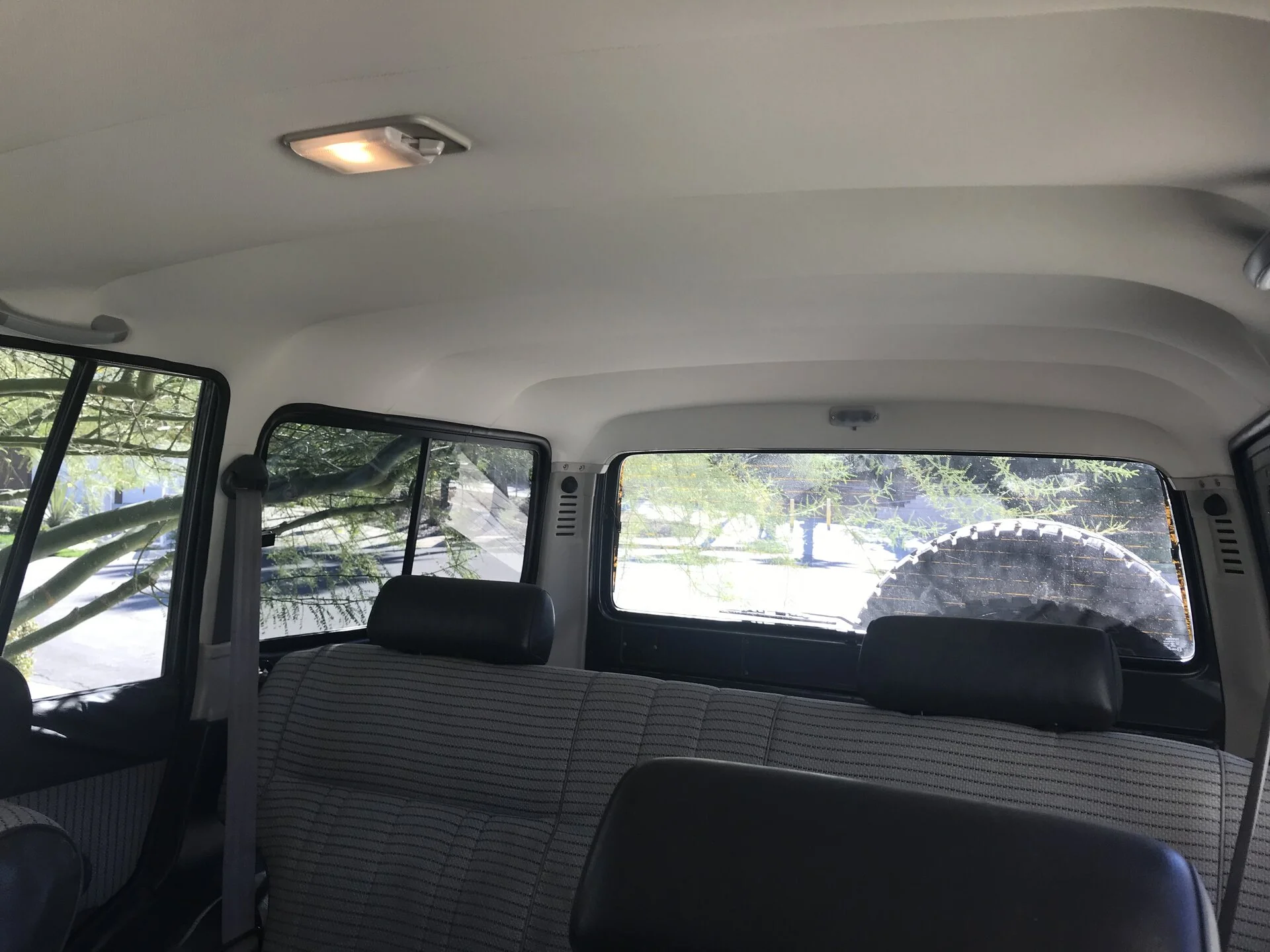

I ordered my SOR headliner last year and was very pleased with it. The pattern is cut well and I had plenty of material to work with and trim off. I have not experience with the CC one. FYI you can also buy new plastic fittings from Toyota for the headliner bows if you break any. Some of mine were old when I pulled them, so I just replaced them all since they were cheap.

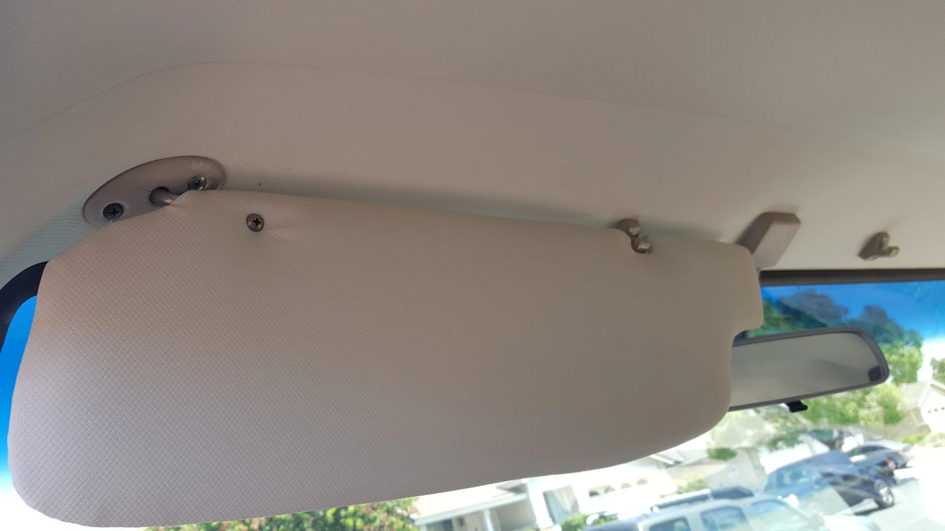

Here's a pic of my SOR one. My first attempt at ever installing a headliner so excuse the amateurness of the install.
