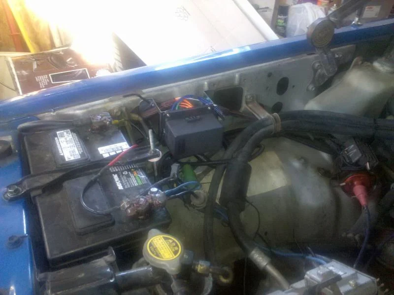

I got my harness within two days of emailing. It came with one of the aux relays wired to the high beam switch - just like I wanted. Clean and quick install. Very high quality materials and construction and a great seller to boot. My stock sealed beams are much brighter- now I just need to get some real headlights. Pics attached.
