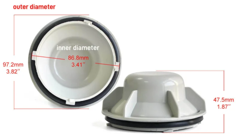

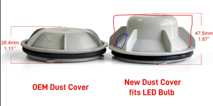

So, the bulb fits, without a cover it moves fully and no issue. With the cover i bought, the back of the bulb hits when it's at the extremity of the aiming on the bare edge where I put blue circle. it would need to be more like where the red is to actually allow the back of the much larger fan housing to sit. (One nice thing is the new design does not have the separate cable and such, it's all-in-one.). i'm still searching for one that is more square and still has a 3.41" diameter.

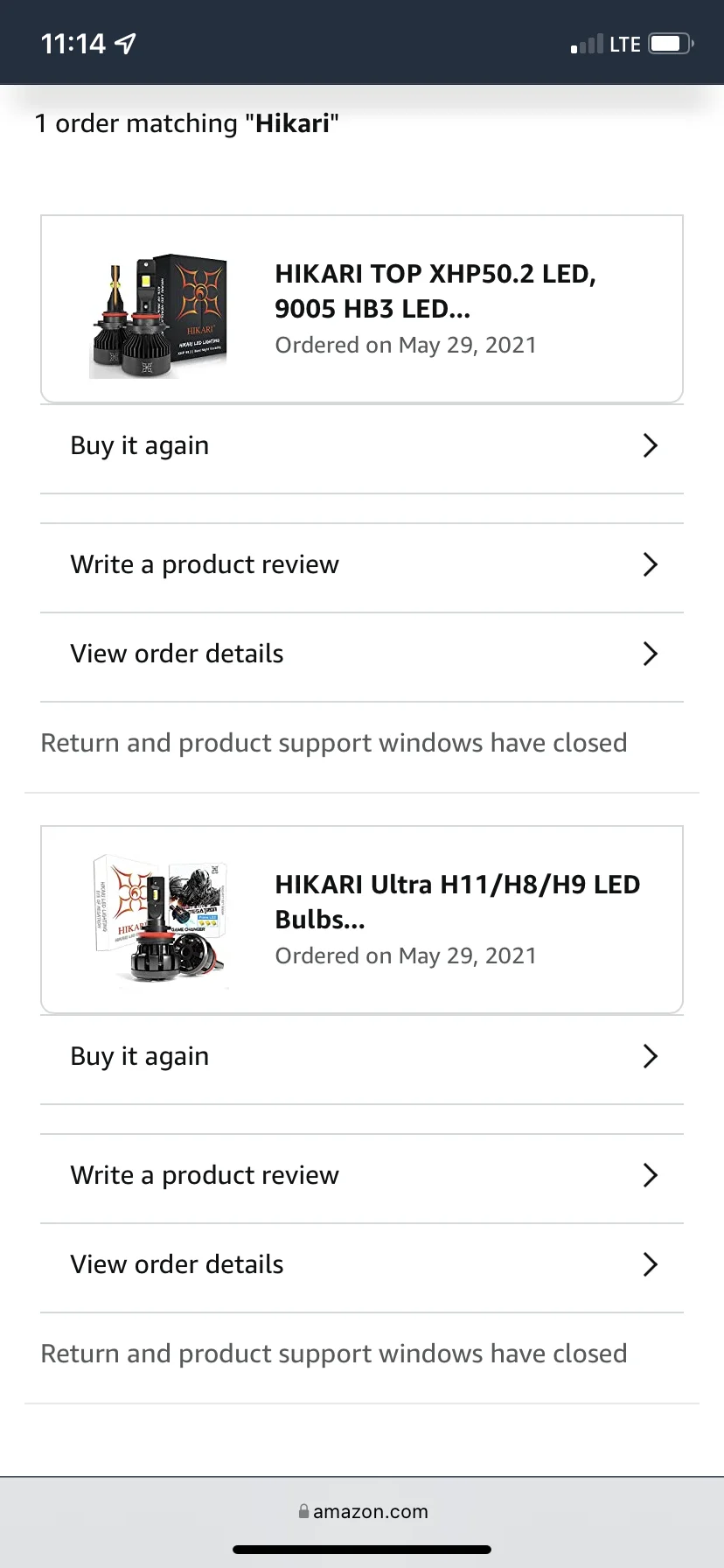

The hikari bulbs work without having to change the cover.
