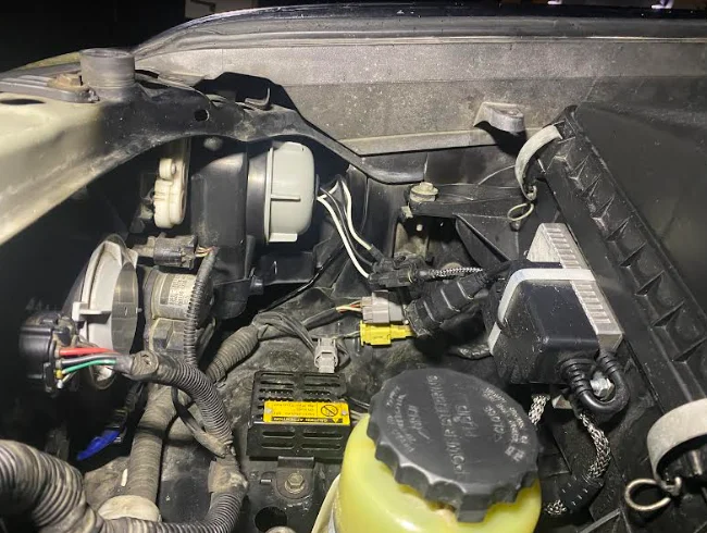

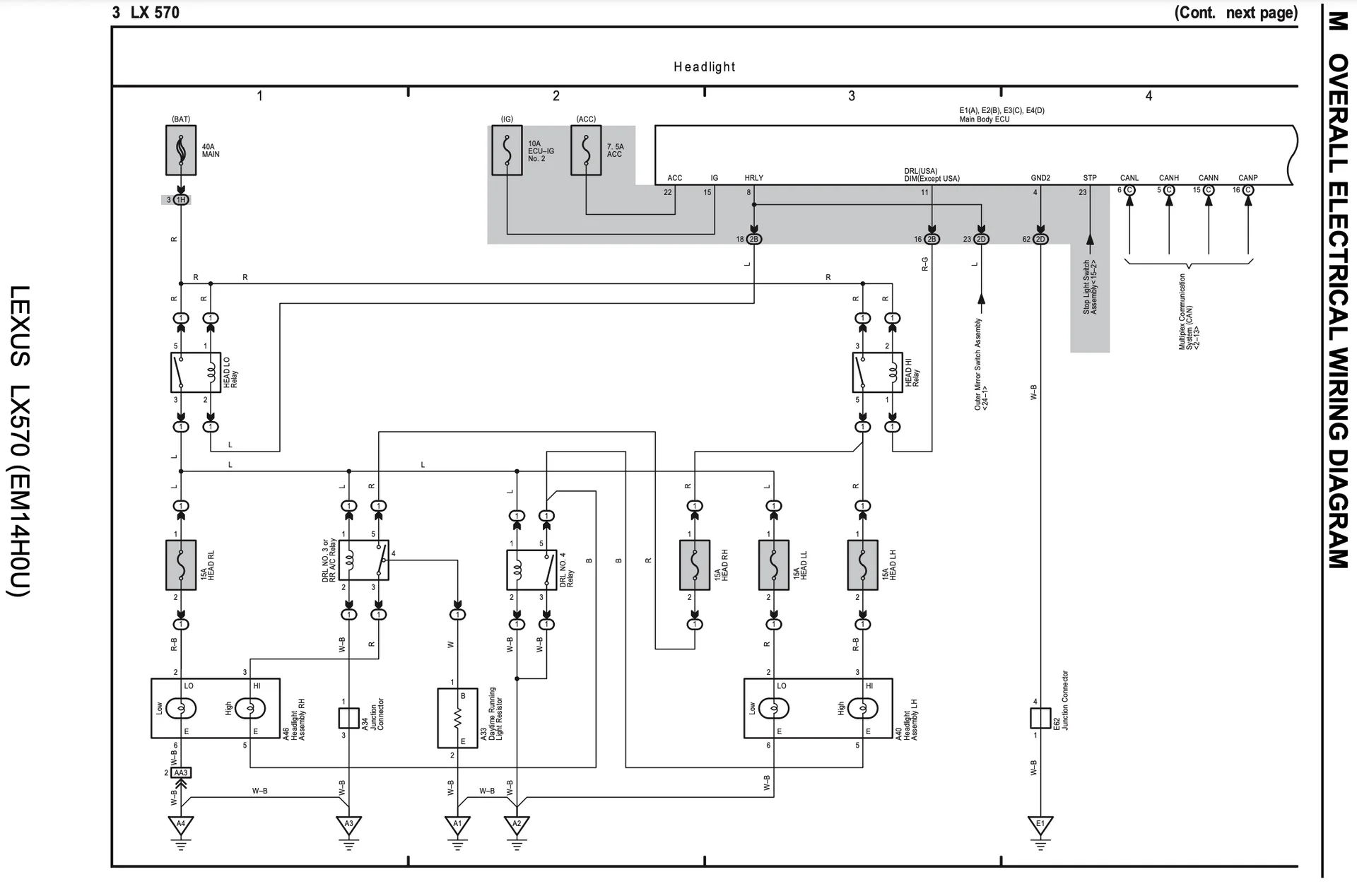

Which wire is positive and which is negative? On the Pass side the wires are blue and white. The LED bulbs I got will plug in either way.

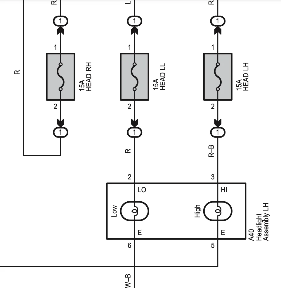

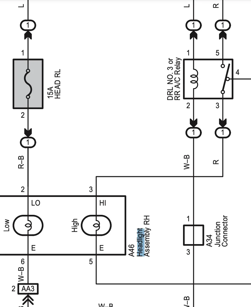

Here are the 2010 schematics @raincityrider
According to these the bulb wire colors are Red/black stripe (pos) and White/black stripe Negative for the RH (US Passenger). There is a Blue upstream of the Red/black stripe, but it's on the other side of the fuse, so probably not where the bulb actually is.
The driver side has Red (pos) and White/black (neg). It ties into the same Blue as the other side, before the fuse.
LEDs are polarity sensitive, but sometimes they will do some shunting to avoid blowing the LED when hooked up backwards, depends on the brand and cost.
Seems that Blue on mine is POS.

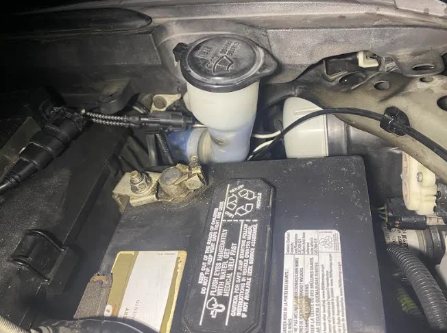

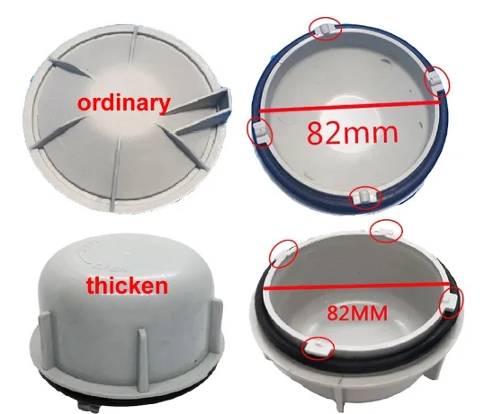

I took a chance and ordered these dust caps, and they fit. It was actually my first time ordering anything from Aliexpress but it was fine. Took about 10 days to arrive.
For Ford Mustang Headlight Bulb Dust Cover Waterproof Dustproof Lengthened Headlamp Rear Seal Shell Lamp Access Cap 82mm

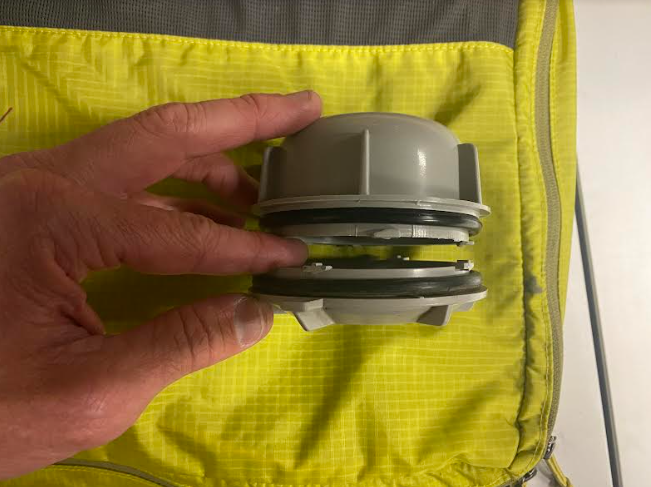

The covers themselves seem to be of decent quality, and the o-ring/gasket is nearly as thick as the OEM gasket so I think it will provide a sufficient seal against the housing. New on top, OEM on bottom.
Install was a bit tight. On the DS I had to take the battery out to install, but it all fit. No AFS warnings while driving around today!

What year is yours? I see on Ali there are also ones listed for the LX570, but they list a 72MM diameter
