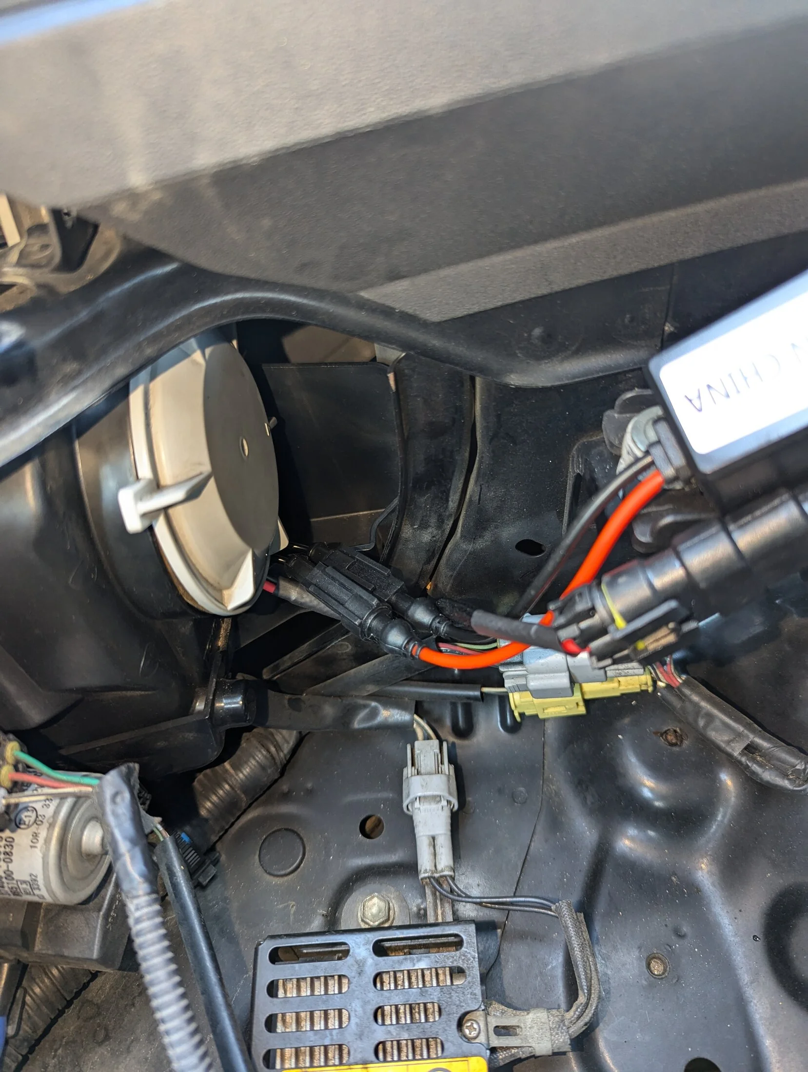

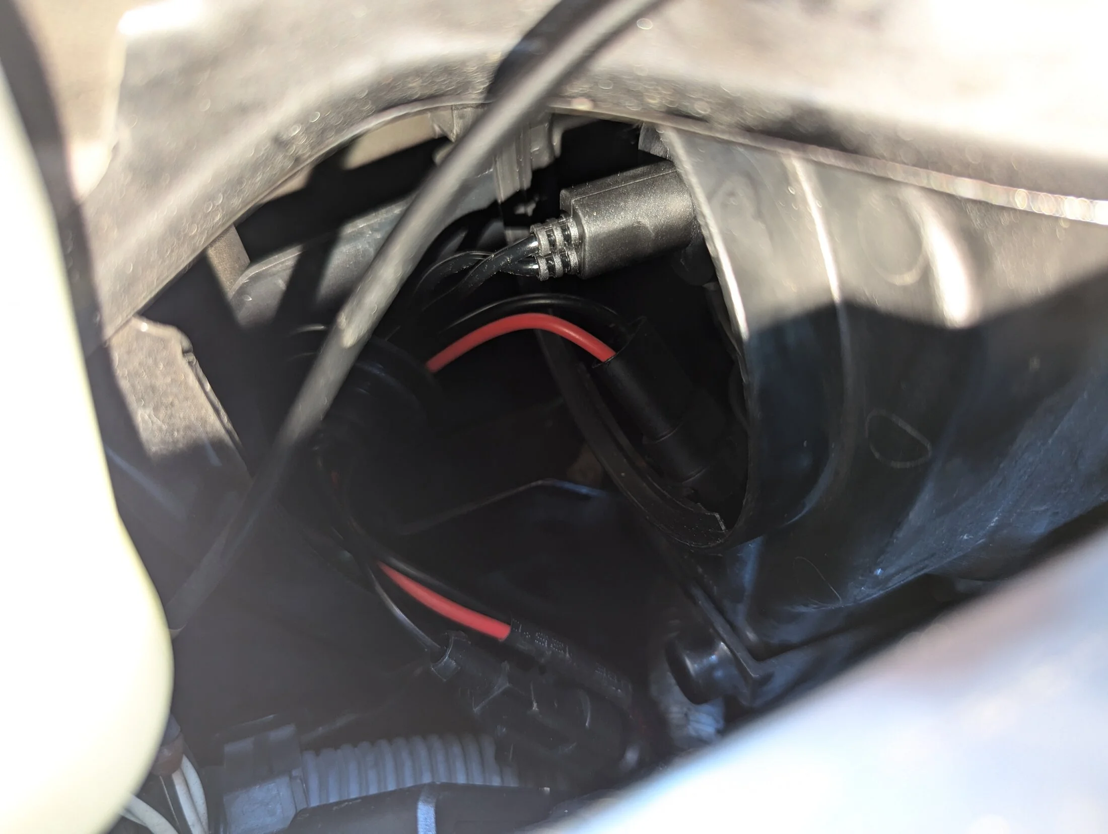

Hey Grinchy, to add to this did you stuff the rest of the wiring behind the extended dust cap? Still waiting on those to come in and tried to leave wiring out and AFS acted up since I guess there wasn't enough play for the wires.
Ballast I get won't fit, but guessing you got more of this wiring I have outside of the housing in the dust cap? Also did you cut a slit in the dust cap or just have a gap where the wires are coming out?
The lights I got have a circular grommet on the wires. So you drill that size hole in the extended dust cap, feed only the bulb side connectors thru the hole (it's a tight fit) and then the grommet seals it up. Most of the wiring is outside the 'light container', outsde the dust cap. so you can put the ballast quite far (8-12")? from the dust cap. there is only enough wire to allow slack for afs inside the light container. It's hard to tell from the picture, but those extended caps may not be deep enough? Here are the caps I used.
I'm still on the original dust caps. Waiting on the extended to show up.
That's make perfect sense! Didn't even think about drilling a hole to the size of the grommet all the wires go to
