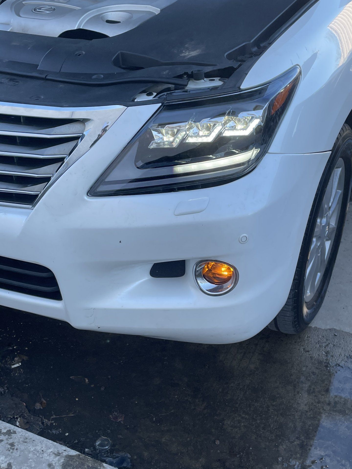

I finished the replacement today, it has a little gap, but it looks really cool now. (The headlight works good, I don't know why I cannot take the photo with that is whole light up)
Looks great! Can u pls post a picture showing the whole front end? Btw are u happy with them?

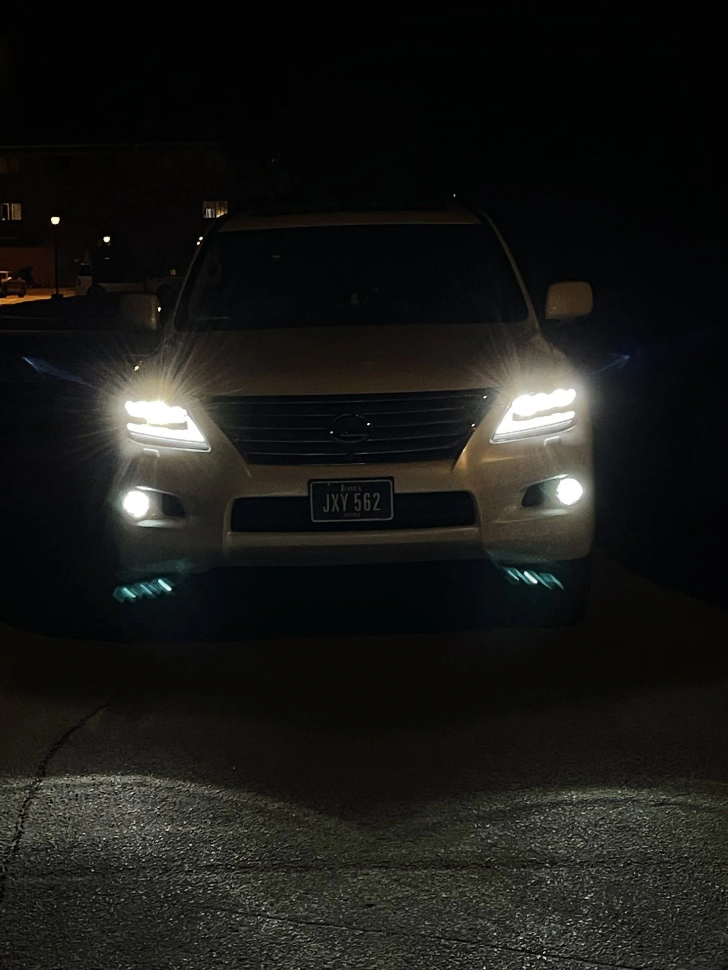

Here are photos. I also replace the fog light to the Xenon.
The light looks great. The gap is a deal breaker for me though :(

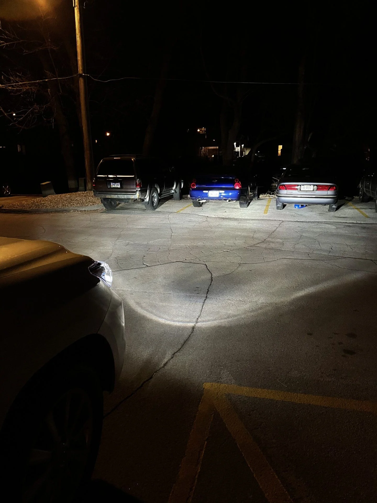

Tonight was the first night I drove at night. They're definitely brighter, but idk if the throw is as good as I would have thought. I'm wondering if that's partly due to the afs, and maybe it not being pointed high enough. These are all just thoughts I had. Any input would be great.
