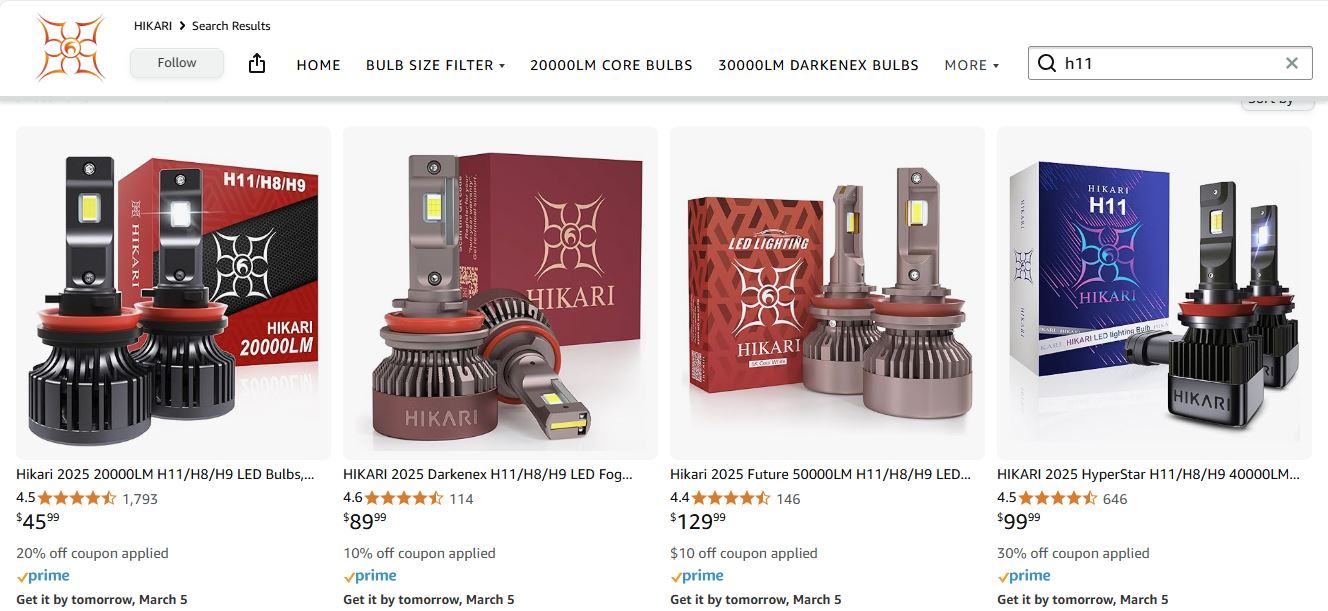

One of standard/OEM low beams on my 2011 LX570 burned out and I'd like to replace it with a Hikari bulb.
I searched for "H11" in the Hikari store on Amazon and came up with four options.
(1) $45.99: Hikari 2025 20000LM H11/H8/H9 LED Bulbs, 45W Upgraded Core-12 Chips, High Lumens Kit, 6000k Cool White, IP68 Waterproof, H16 Foglight
(2) $89.99: HIKARI 2025 Darkenex H11/H8/H9 LED Fog light, 30000LM Pure White 6000K LED Bulbs, Plug & Play IP68 Waterproof Pack of 2
(3) $99.99: HIKARI 2025 HyperStar H11/H8/H9 40000LM Wireless Fog Light Bulbs, 32W Acme-X, 6000K Cool White, IP68 Waterproof, H16 Foglight,Plug & PlayPack of 2
(4) $129.99: Hikari 2025 Future 50000LM H11/H8/H9 LED Fog Light, 65W Titanova LED, 6000K Cool White, IP68 Waterproof, H16 Foglight,Plug & PlayPack of
Question 1 = Would the 50000LM bulbs be too bright (annoying to other motorists) for low beams?
Question 2 = All four of these options say "Fog Light" in the description. Am I looking at the correct bulbs for my low beams?
The OEM low beam and the OEM fog light use the same bulb.
If you can still find them - there was a Phillips
Osram somewhat OE HID in h11. They are "true" OE 4300k but w an H11 base. After reading all these LED burnouts, I'd stick w HID.
And, If you decide to pop an uber bright H11 into your fogs just know, they are ridiculously bright, "spray" everywhere and really pooch oncoming traffic. I mean, do as you wish, but you're pretty much profiling like "that guy" running them in his/her Silverado reflector (vs projector) housing.

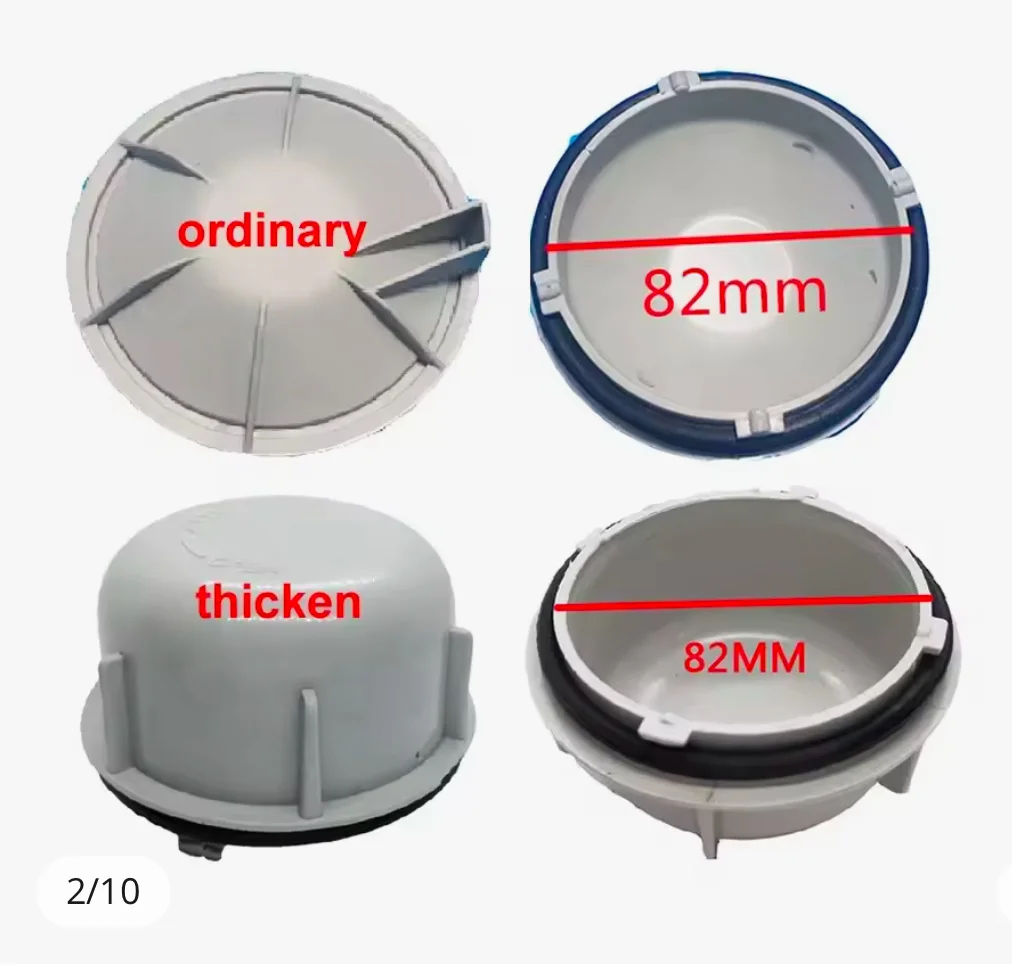

Regarding the extended headlamp dust caps, these are proving difficult to find. The Lasfit DC1012 model is currently sold out and I didn't have much luck finding a substitute. I think I'll roll the dice to see if they fit. If not, I'll likely cut/modify the existing dust caps to extend them (3D print a dome and epoxy it on or something).

Won't need extended caps for a stock size halogen bulb. Do need extended caps for the HID conversion, to provide space for the AFS headlight moving servos as the bulbs are longer behind the fitting.

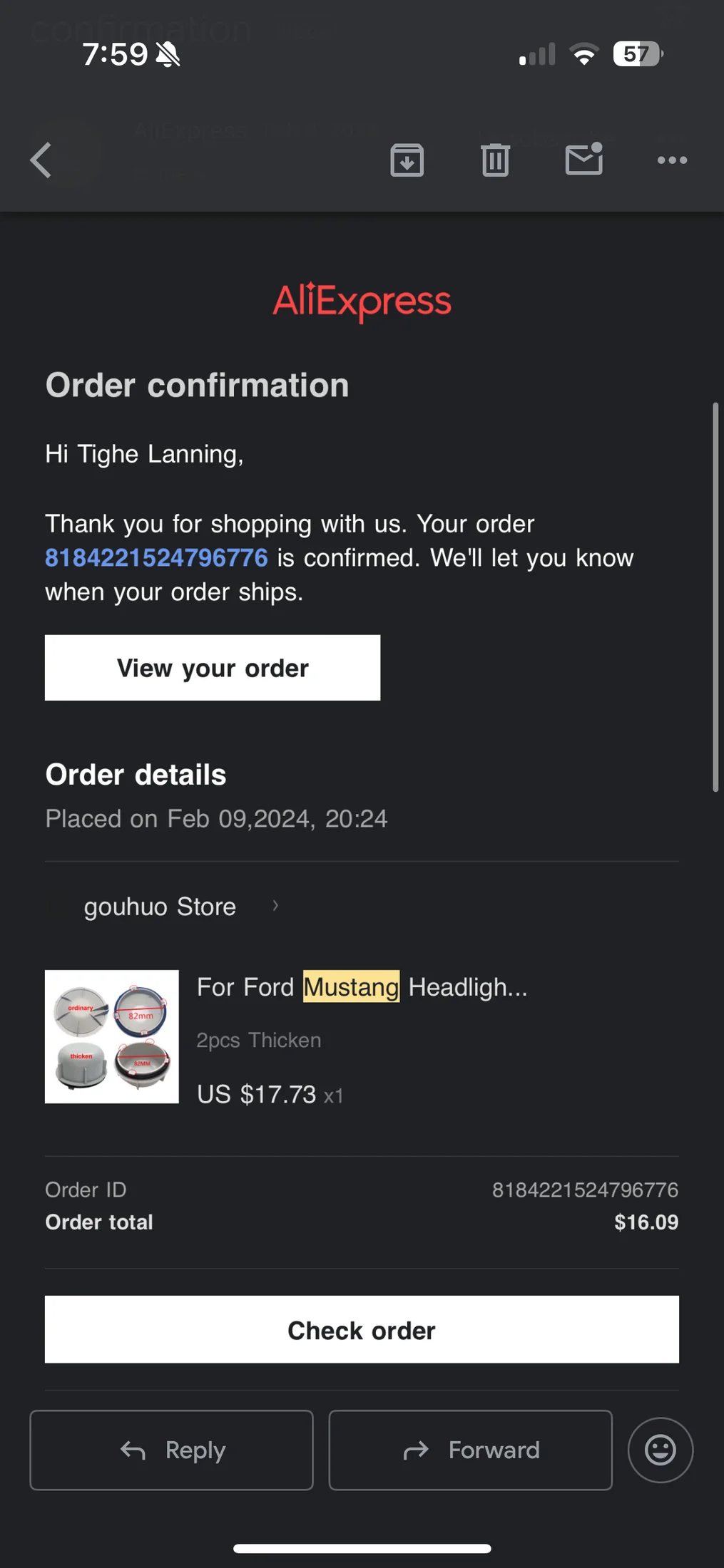

The dust caps I sourced from Alibaba are working fine, and appear to still be available.
I'm just curious here; this link takes me to a 'Ford Mustang' product. Obviously, its Alibaba, but were these exactly what worked for you? Having looked at the Lasfit links both are an 82mm cover. Just wanting to check before I pull the plug. I just bought new lens and butyl rubber and am planning to swap those out, so want to go to HID while I am at it to get a nice clean overhaul.
I'm just curious here; this link takes me to a 'Ford Mustang' product…
Yep that’s what I ordered. Here is the receipt- no issues with fitment (screenshot below).
