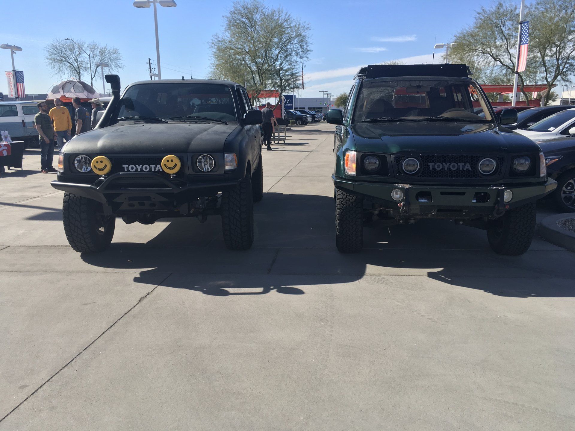

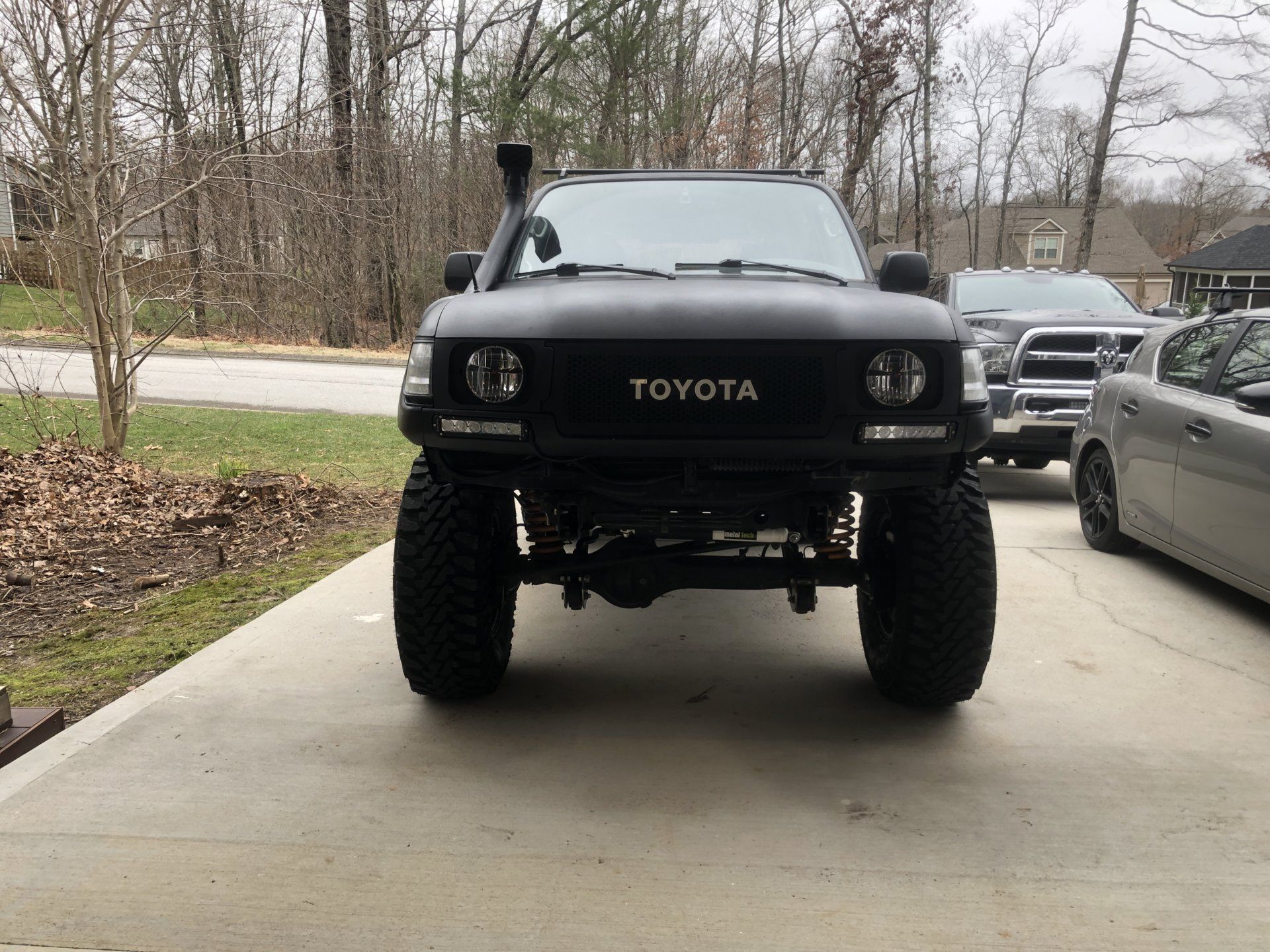

went with lx450 side marker lamps with switch back led bulbs. I ended up blacking out the lowers. I got plenty of light from the led bulbs in the side. Just wanted to show some different ideas for everyone. I like this set up the best.. Just need my bumper back from paint!

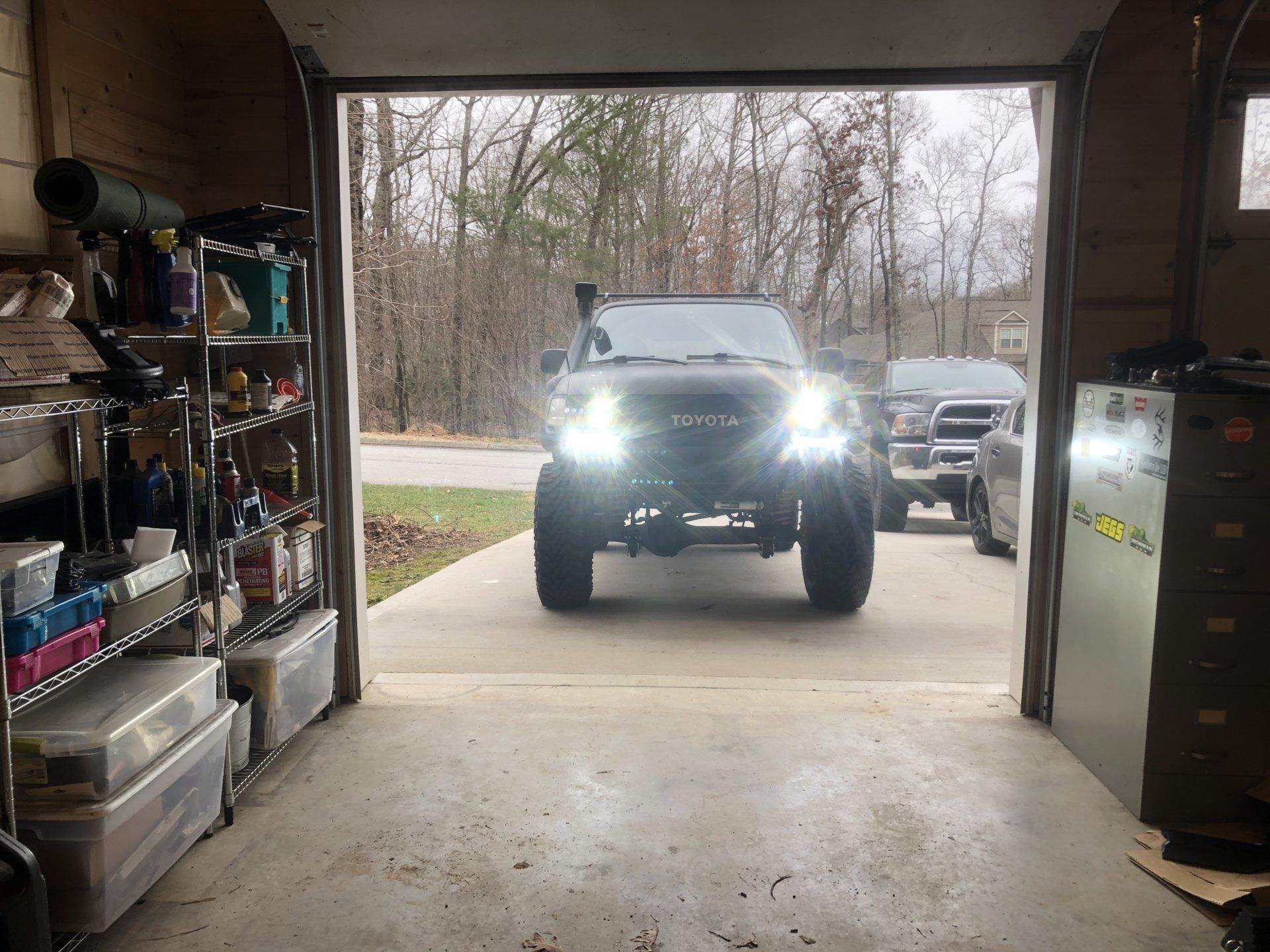

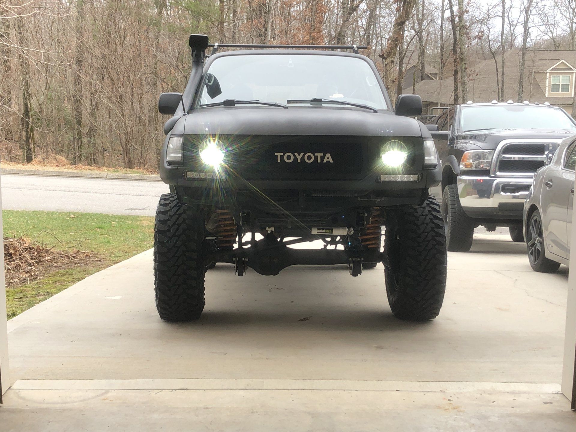

For the 7" headlight I went with Dapper Lighting V2 HID.
Fit and finish are great. Thanks for the outstanding work, Kelly.
I still need to adjust the lights. ~ -5f at the time so "good enough" worked.
Looks great! That is one crisp cutoff line on those headlights!

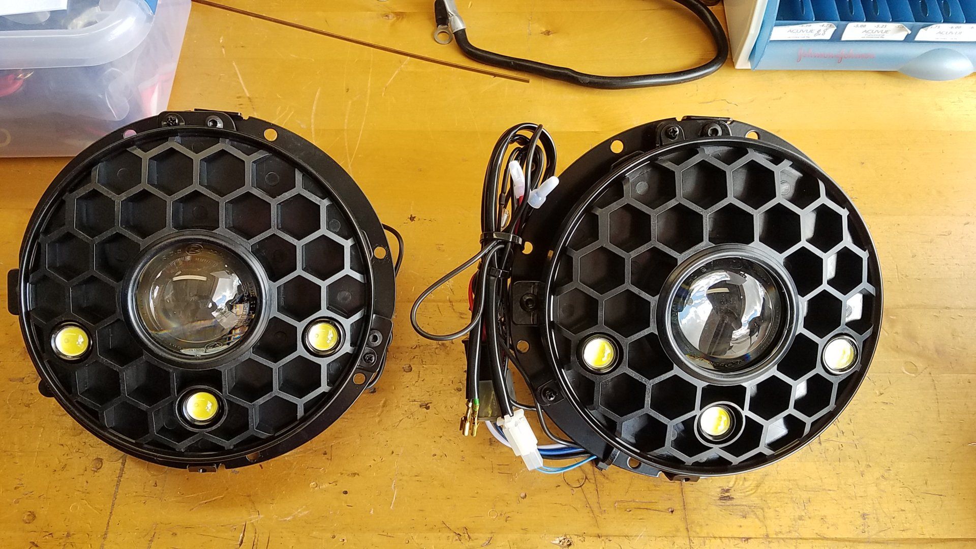

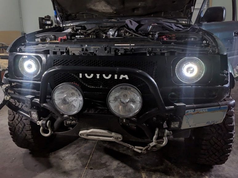

Did my final fitment today. Looking forward to getting mine to powder coat soon. My HID projector is just sitting the the bench mocking my sad halogens like a spiteful cyclops.
o_O

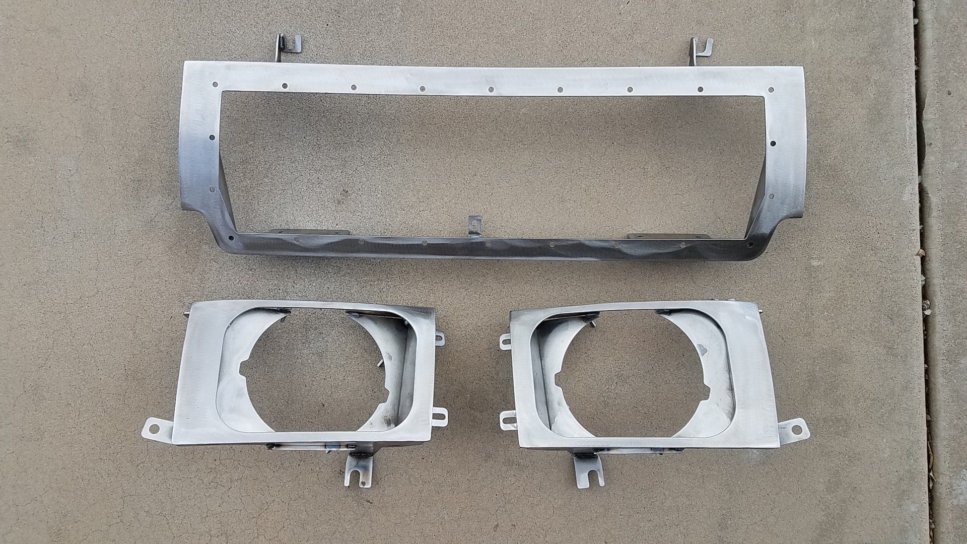

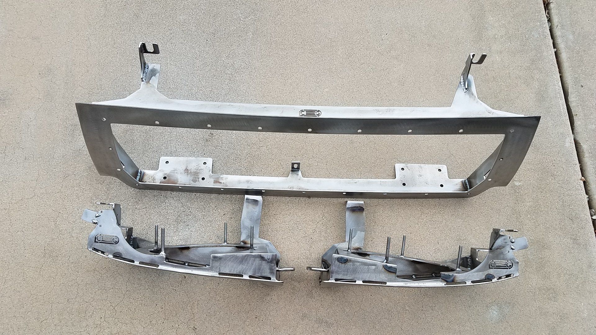

All deburred and ready for powder coating. Assembled the headlights, just waiting on the HID bulbs and ballasts.

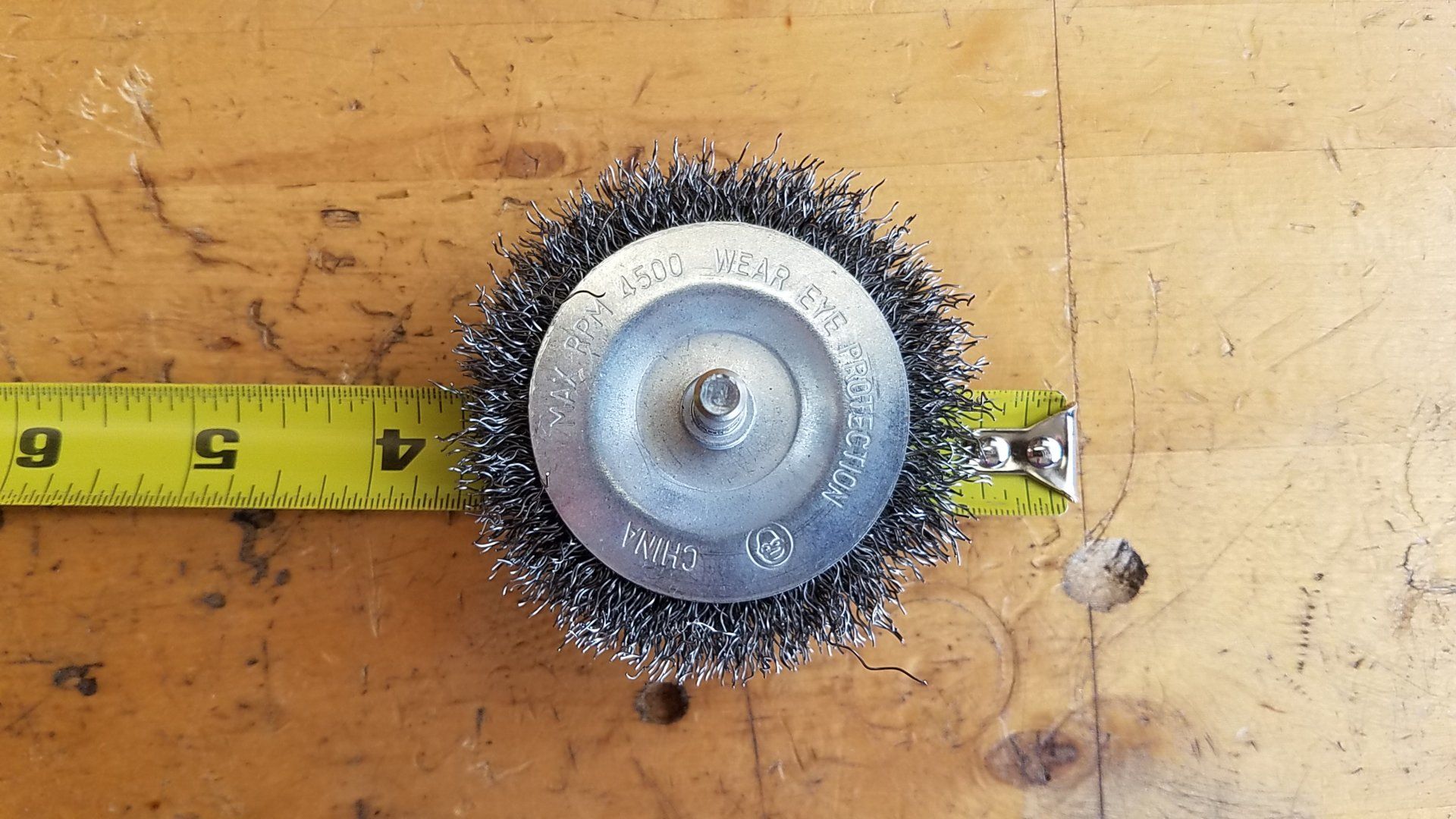

I killed my 4" wire wheel and went through 4x Dewalt 20V drill batteries. :) I'll be finding wires for the next 4 years.
Can't wait to get these installed!

Normally sandblasting before powder will prep it very well. Other than some stubborn slag, it turns out nicely after my final 120 grit that I finish them with. Although, if you were using auto paint, then you would need to prep more. Be careful that the wire didn't dig in and cause deep scratches or gouges because those are quite aggressive. Hit the faces with some 180 grit on an orbital or palm sander before powder.
I'm excited to see those crazy honeycomb lights!
