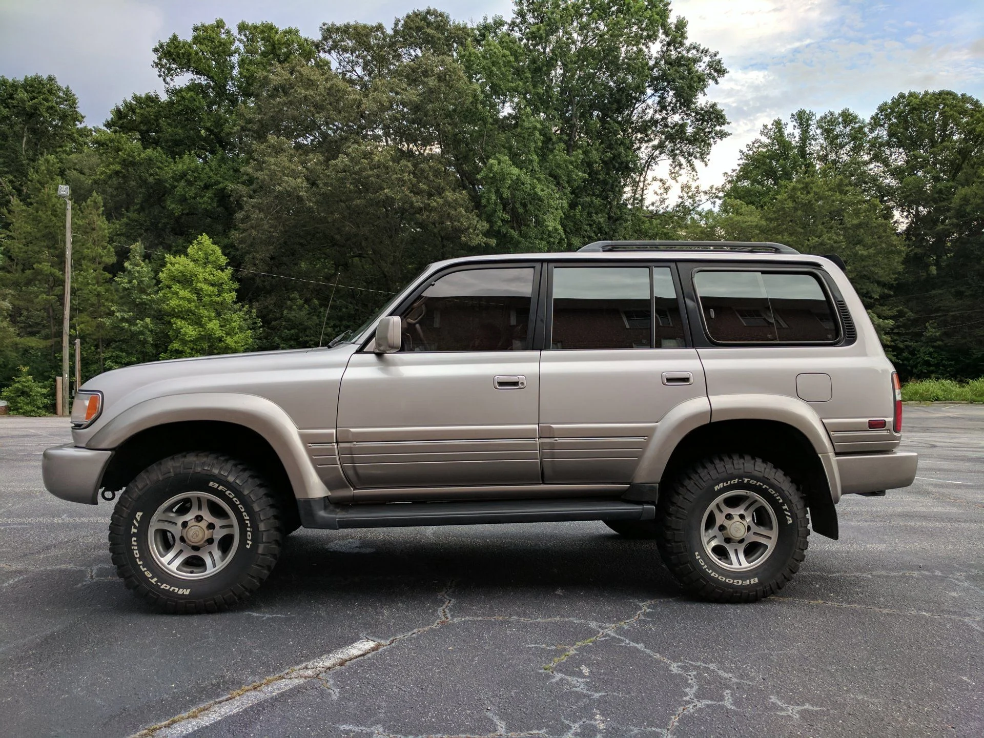

I just installed my OME J Springs and L Shocks. I immediately experienced front driveline vibes and noise on deceleration. I had the alignment checked and my caster is -2.60. I have the Dobinsons adjustable caster bushings that are rated from 0-3.5 degrees. I was told by them that this will work and other members said I will need plates. I will be installing the bushings on Monday set at the max 3.5 degrees and have it aligned again to see what my caster reading will be.
As for the vibration/noise issue from the front, I went and had a custom DC shaft made from Carolina Driveline: Driveshafts Speed Balanced Steel and Aluminum turnaround time is 1-2 days right now.
Here's a picture right after I installed the lift.
