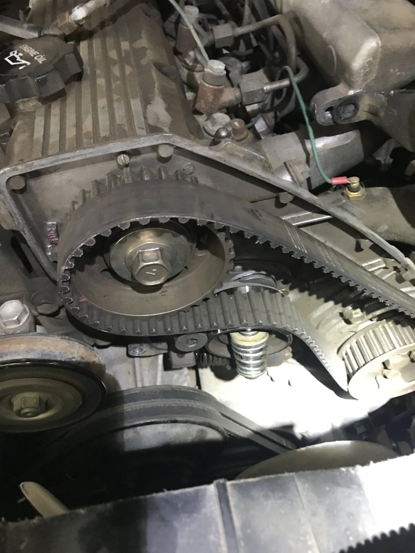

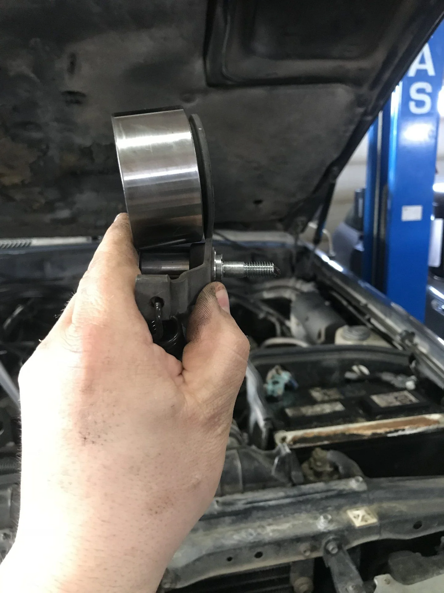

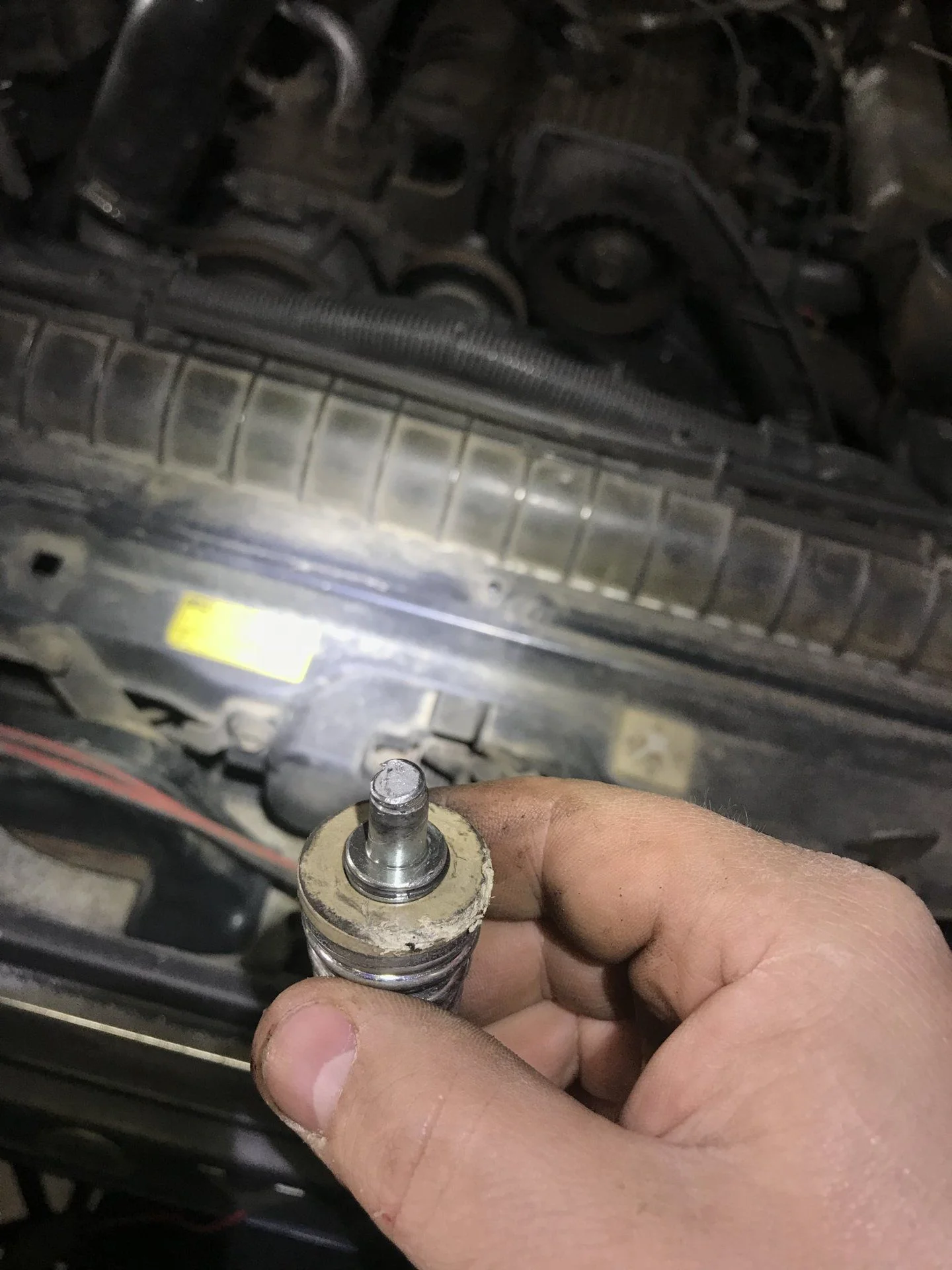

I read this thread last week and thought what bum luck. Then this happened to me:
Looks like you might have caught it in time? Or did you suffer damage?
No she's bad. Lifters are jammed and cam lobes hurt. Not pretty
