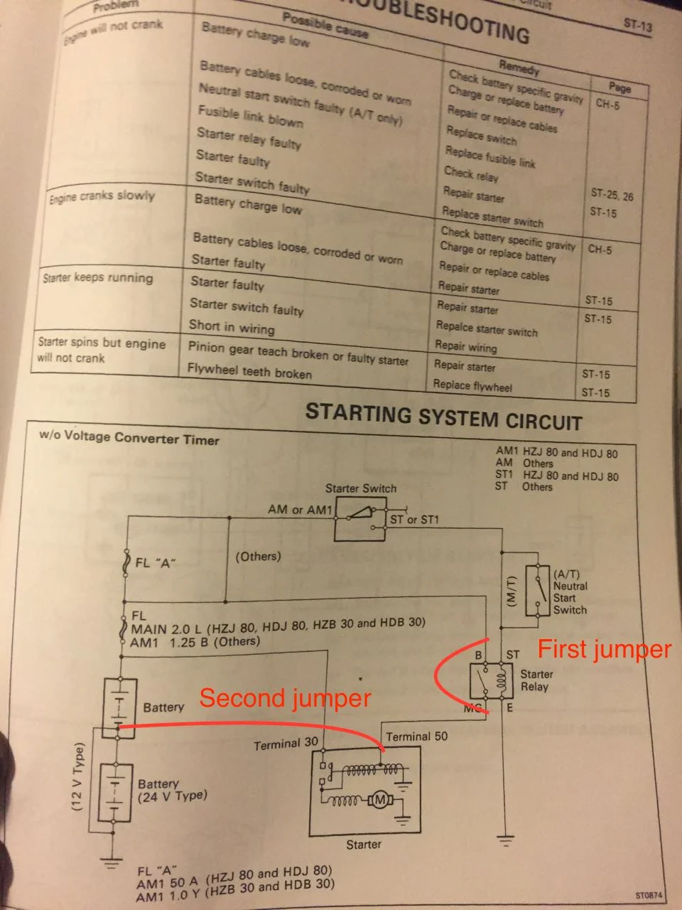

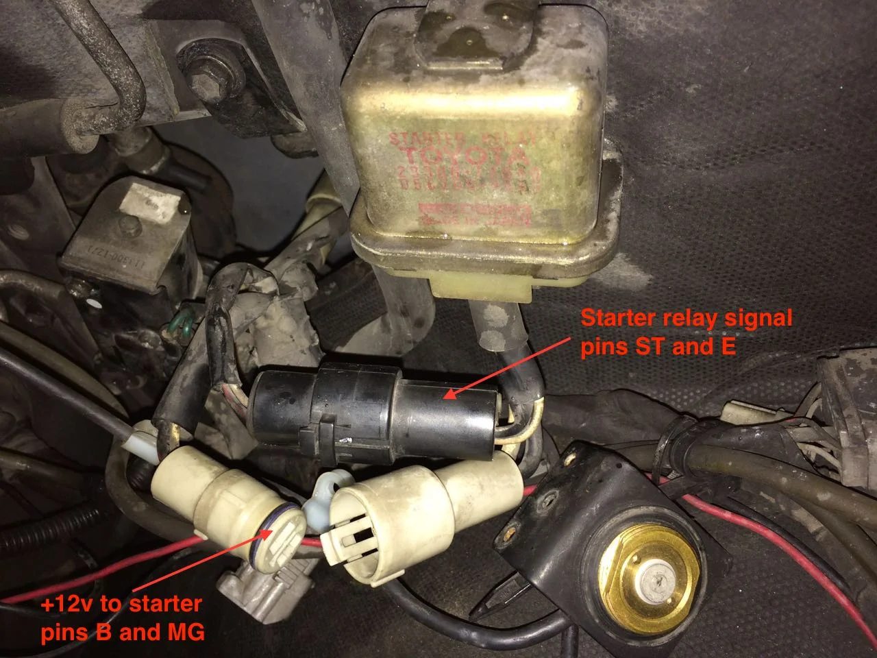

Thanks for your suggestions! I went ahead and tried to hotwire the starter by putting a jumper across the white plug that goes to the starter relay. (12V power, not the relay signal plug) Nothing happened. Then I unplugged the connection that is right at the starter, and jumpered from the +12V at the white plug. Still nothing. So I ran a wire from the battery directly to the plug at the starter and it cranked right up. Out came the voltmeter. While there was ~11.5V across the battery terminals, there was only 10-10.5V at the white plug on the starter relay.
So the starter works fine, the relay works fine, but there is not quite enough voltage in the system to get the starter solenoid to engage. Any tips on how to track down the voltage loss?

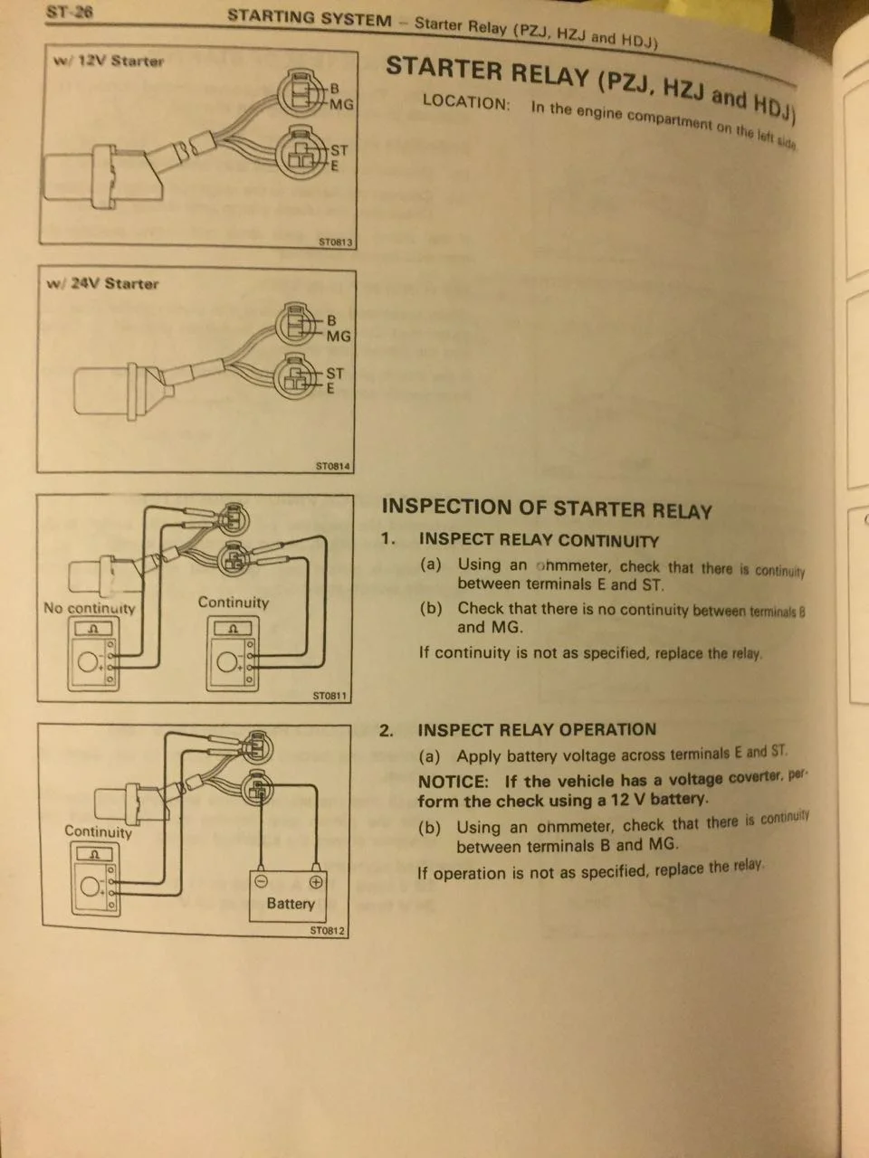

Sorry, let me clarify. The starter relay does work properly, and it is getting signal from the ignition switch (ST and E). There is power to the white plug (B). When I put a jumper between B and MG, I got nothing, but when I ran +12v to the black plug on the starter (terminal 50) the engine cranked. I think there is not quite enough voltage at the B/MG plug to engage the starter.

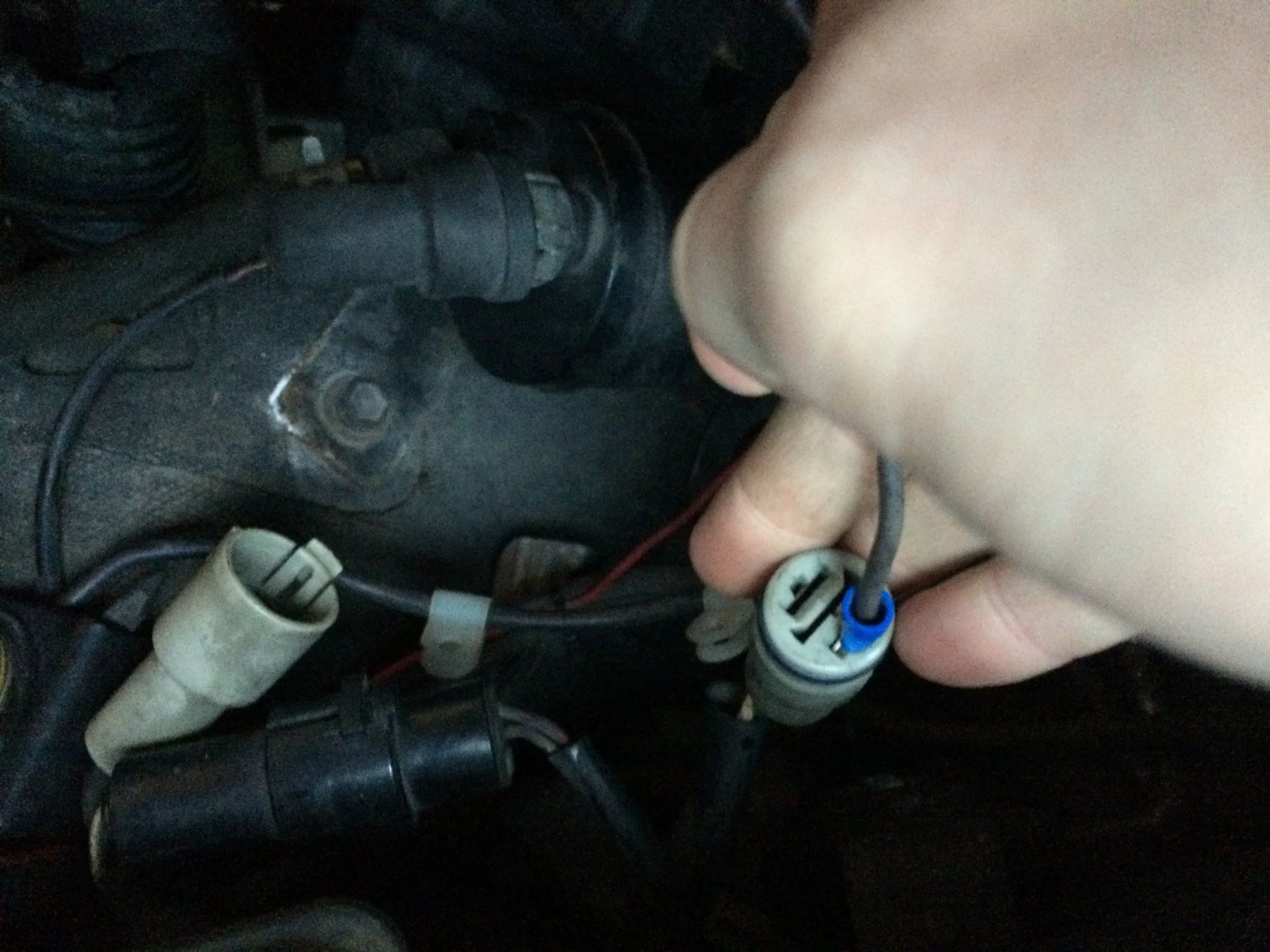

Exactly. I will probably start with the MG-Terminal 50 wire as that is where I think the problem was the first time, most likely in the black plug at the starter. I will also see if I can get a different voltmeter to compare results with mine.
So I've just done some more testing: I have finally made a good, reliable connection at the black plug near the starter, but that didn't fix the problem. I tried putting a jumper between the B and MG terminals at the starter relay again, but still no luck. I then put a jumper from the battery to MG, and it cranked just fine. Conclusion: there is just not enough voltage/current at the B plug to get the solenoid on the starter to engage. However, I am not sure where to look to find a bad connection before the plug at the starter relay.
Here is the current jumper. I tried a jumper between the two sides of this plug, but nothing happened.

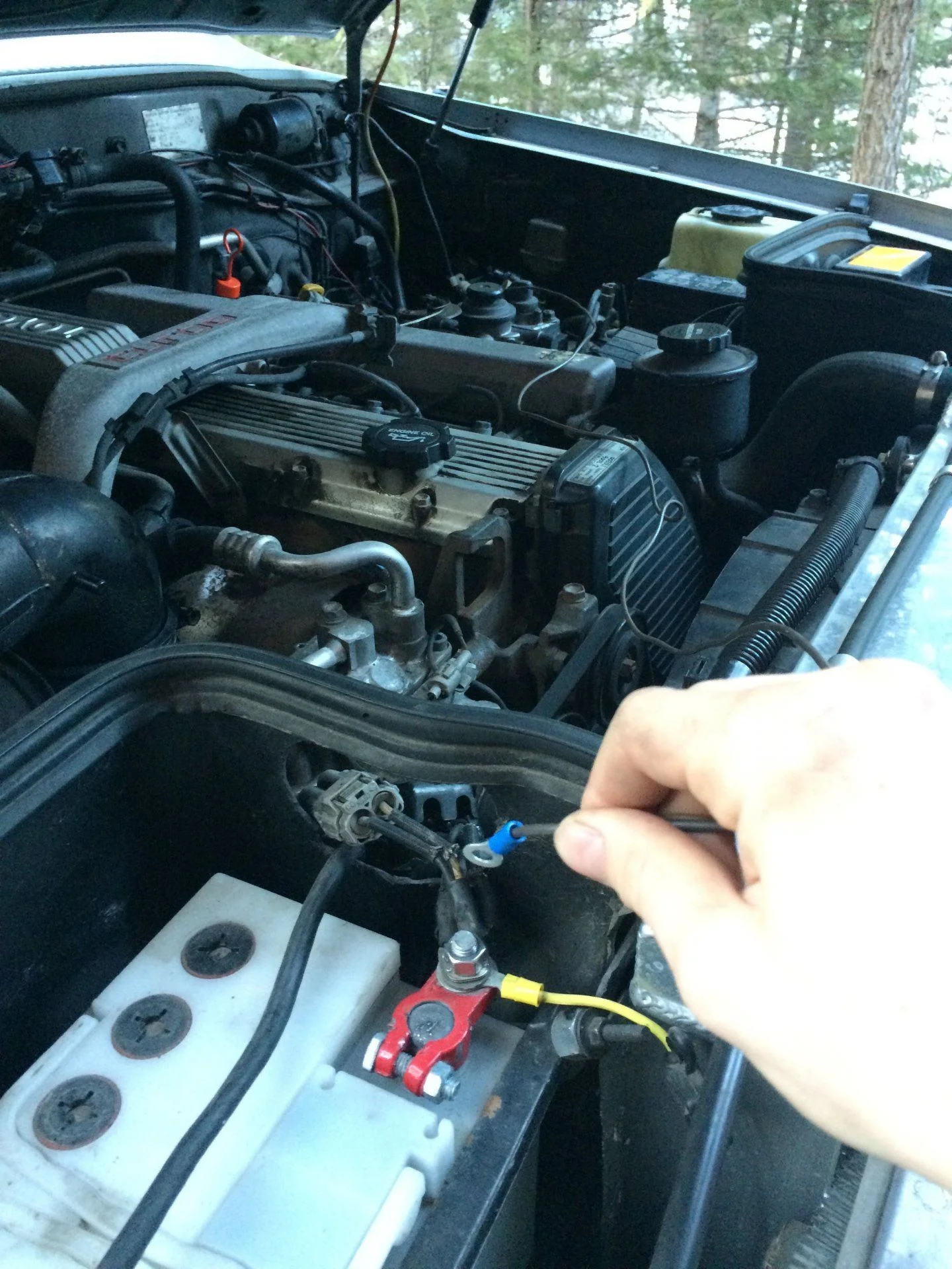

Well, to wrap up, rather than tearing apart some of the dash and a bunch of the engine electrical trying to trace the wire I just ran a new fused wire from +Battery to the B/MG plug. It starts with the key now!
Had someone asking about this problem, so I figured I would post some updated wiring diagrams I made to illustrate what happens in the 24v start system when the key is turned:
Diagram 1: key in RUN position, red is hot and blue is ground
Diagram 2: key in START position, red is hot and green is the circuit I had to fix by running a new wire from the fusible link to terminal B on the starter relay
