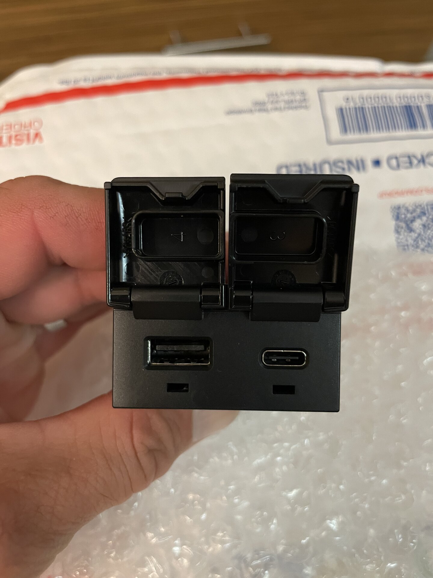

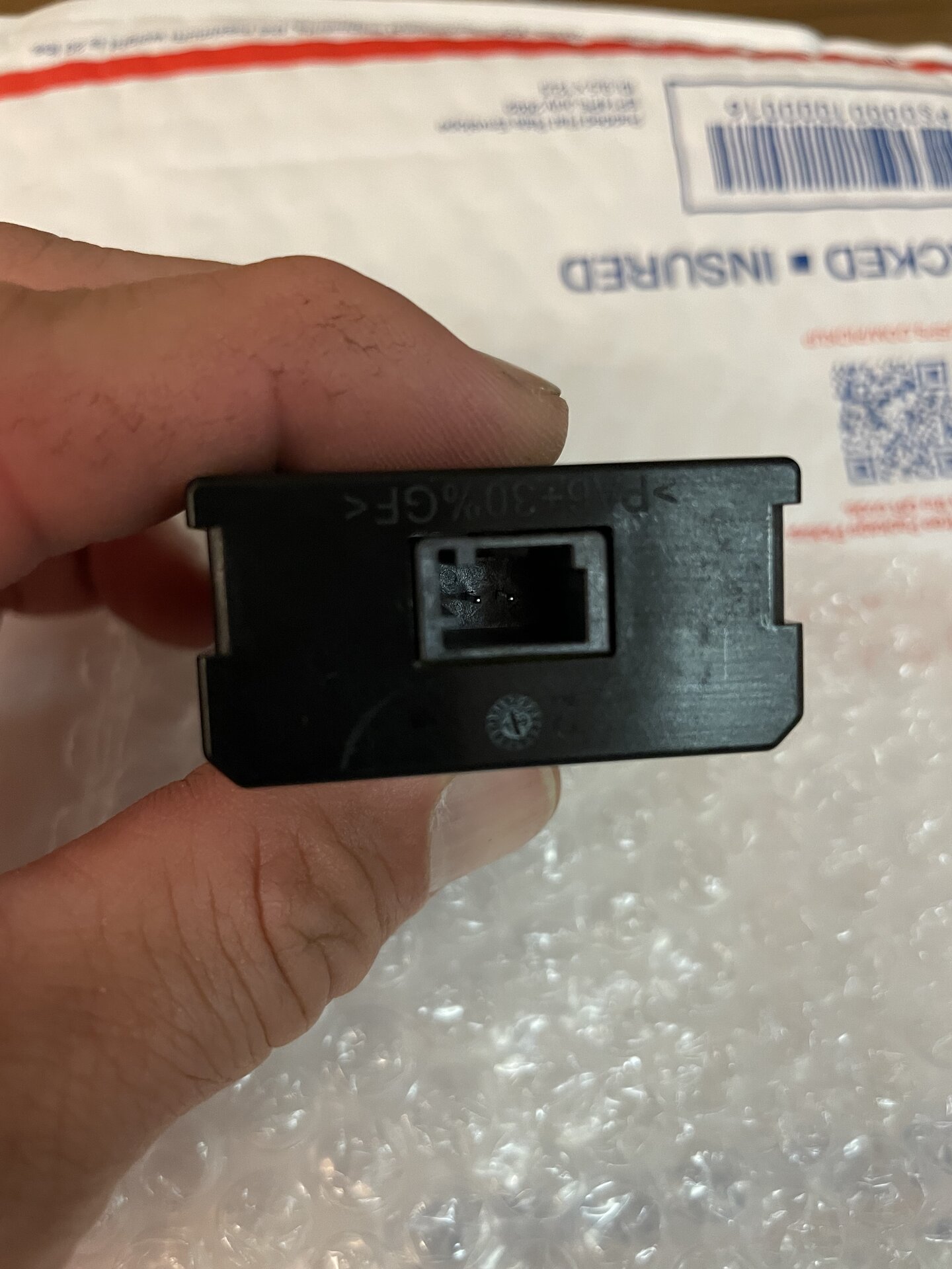

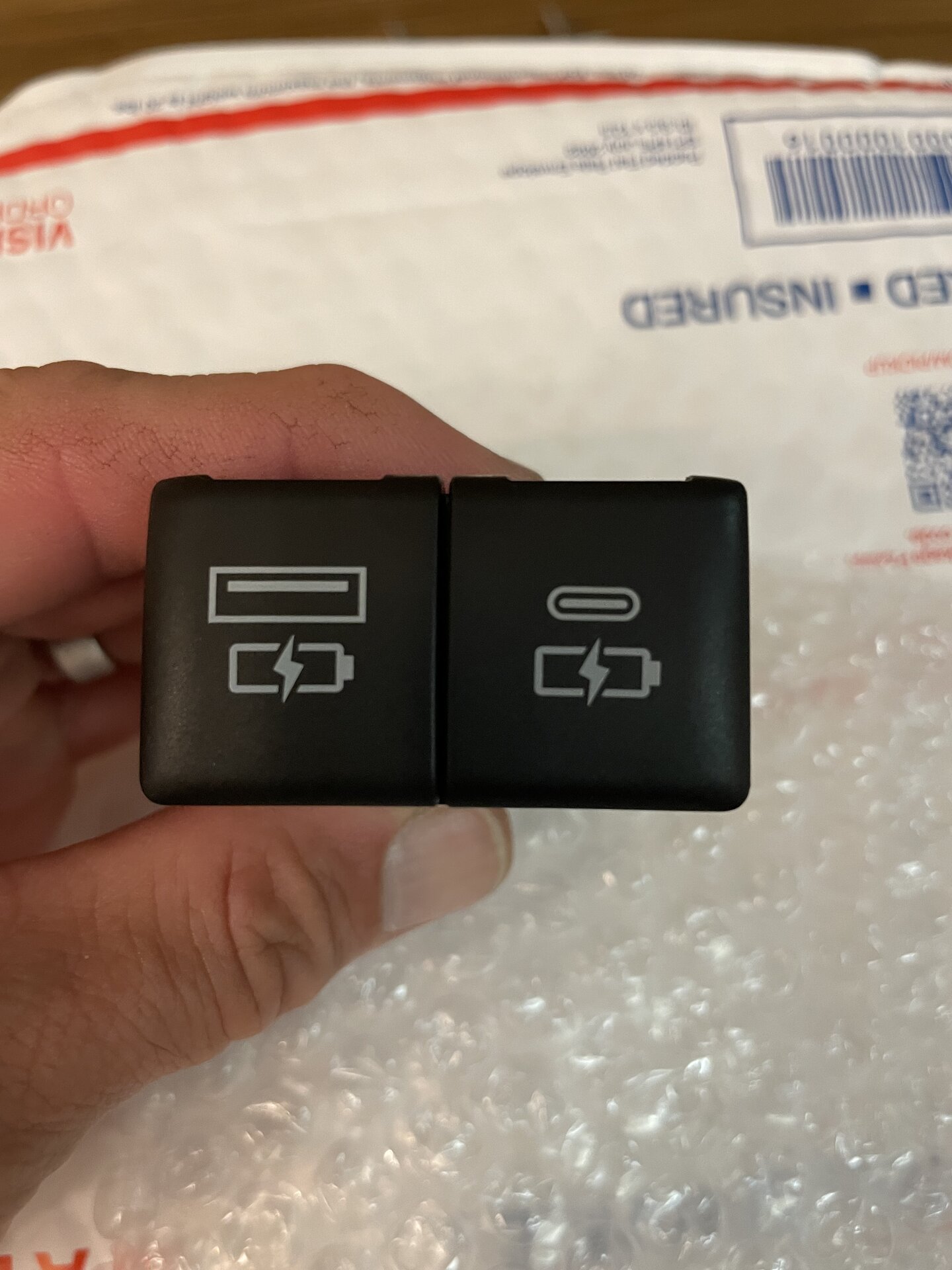

In small parts news, I found these on ye olde eBay. I need to see if there is a suitable connector in the harness. Otherwise I need to find a suitable pigtail to wire it in.
I think I've tracked down the matching plug and pigtails for that charger:
90980-12D25 plug
82998-24290 pigtail x 2
I'll be ordering soon and let you know if pans out.
View attachment 3365424View attachment 3365426View attachment 3365427
I like the fact that the example you ordered has a "USB-C" smaller style plug as I recently had to replace my 5 yr old phone with an s22 and it came with a charge cord (no charge block) with the smaller connector on both ends. I was like - WTF am I supposed to do with this?? lol
I also happen to have one spot on my 70 series panel that has a blank that might just fit that. Will be watching with interest.... thanks for sharing!

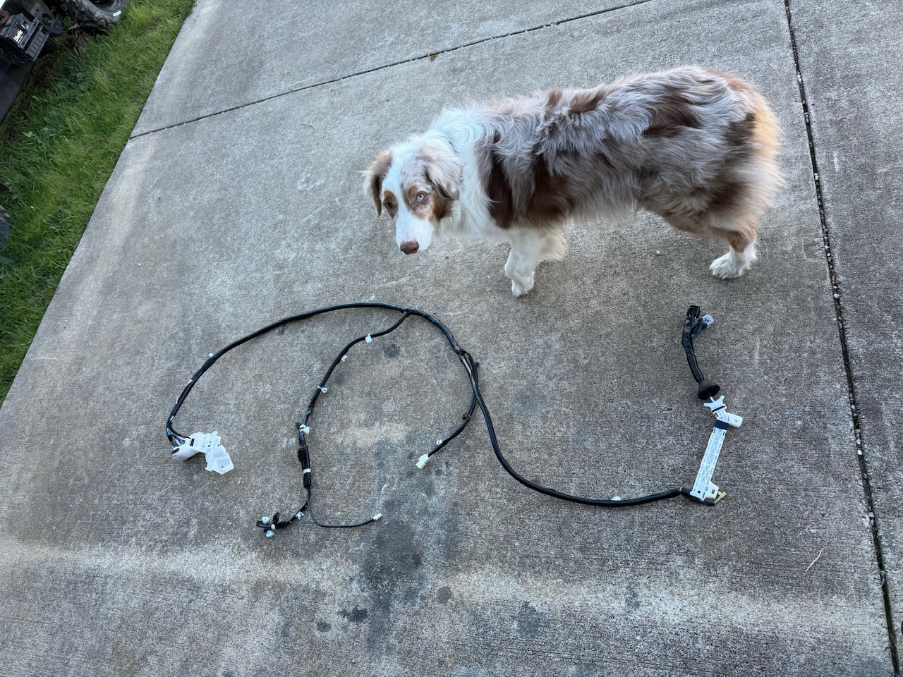

Lots of stuff has happened this summer. But today a friend in Canada took delivery of the floor wiring harness that I literally couldn’t find in about 15 other places around the world. So stoked.

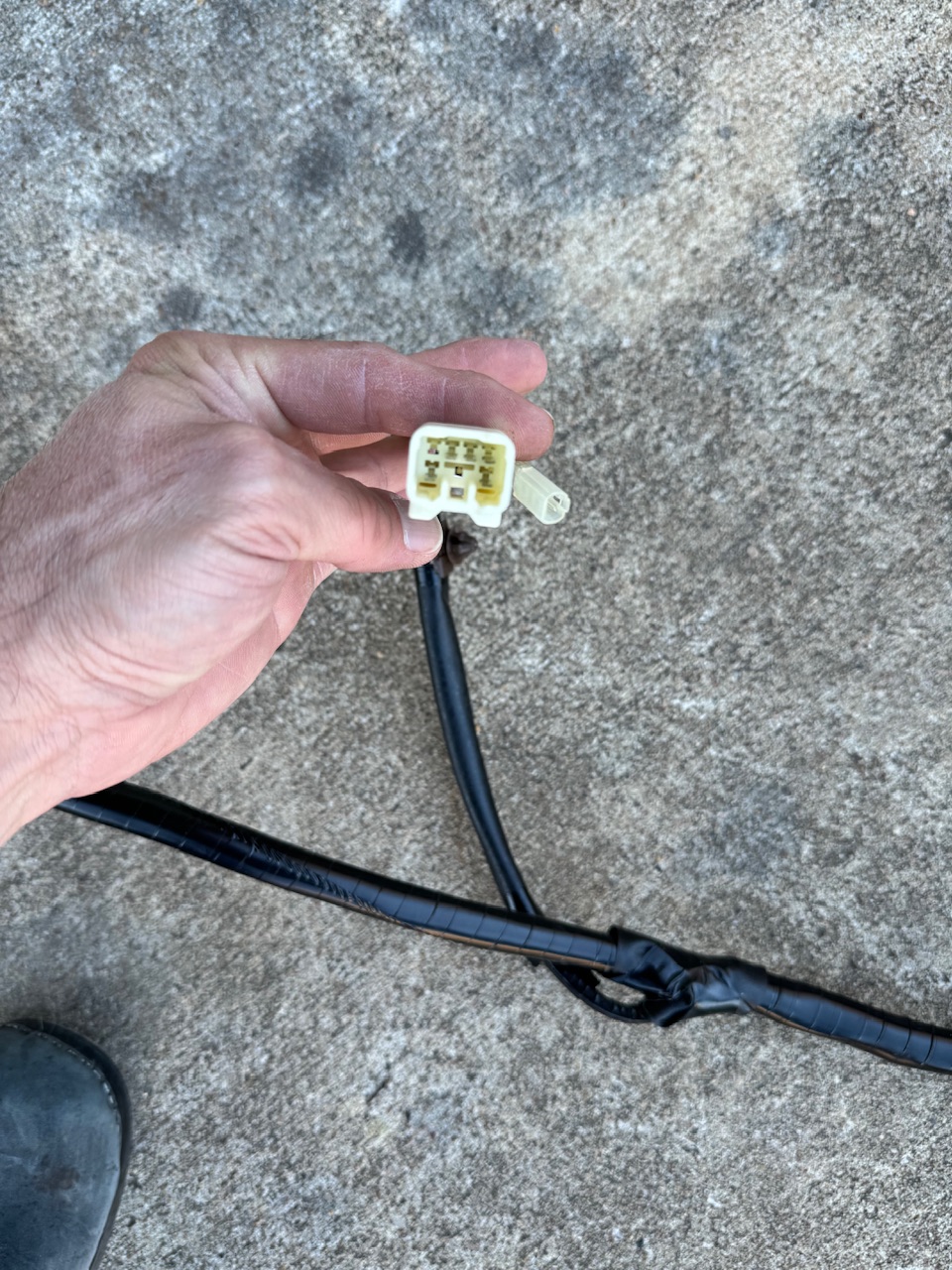

The plug I am holding is the vaunted right rear door power window switch. Now the real question, is what powers the left rear door switches? I will look into that this weekend.
Solid work buddy! Love the double cab 😍
the left plug should be very similar to the 6 pole your holding coming out the front cowls near the fuse boxes on mine that’s where it’s located driver side
Looks like it may be
82163-60482
WIRE, FLOOR, NO. 3.
