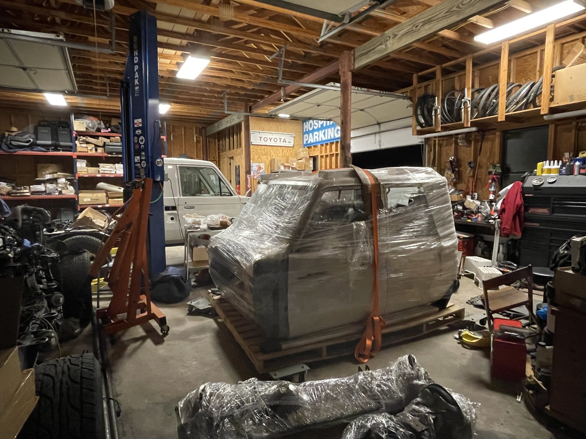

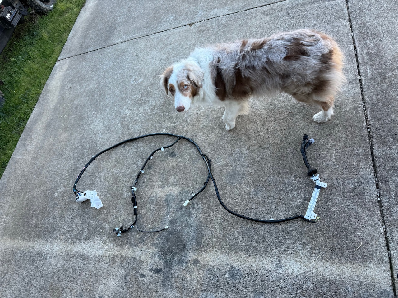

View attachment 3520108View attachment 3520109View attachment 3520110THE EAGLE HAS LANDED.
Nate is not impressed.

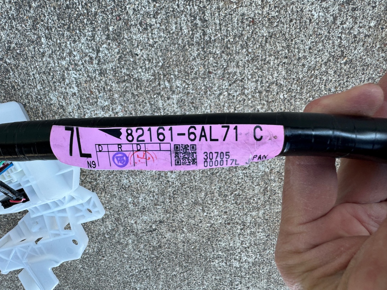

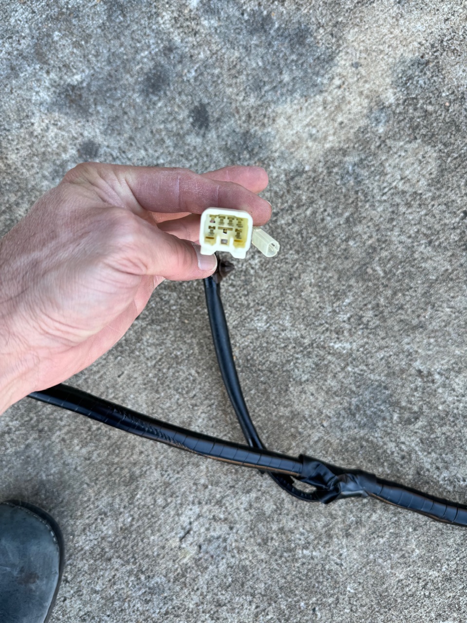

The plug I am holding is the vaunted right rear door power window switch. Now the real question, is what powers the left rear door switches? I will look into that this weekend.
So this is the actual connector showing in this picture :
●[yazaki] 090II series 6 pole non-waterproofing M connector [2+4 type] (no terminals)
●[Yazaki] 090 type [Sumitomo TS/ Yazaki 090II] series male terminal non-waterproofing
You will need the counterpart female connector and female terminal to completed your harness
[yazaki] 090II series 6 pole non-waterproofing F connector [2+4 type] (no terminals)
●[Yazaki] 090 type [Sumitomo TS/ Yazaki 090II] series Female terminal non-waterproofing
I am not sure about the other connector needed however in terms of wire you can chose the colors needed appropriately size is .085MM and 1.25MM I like mostly the 1.25MM
AVS or AVSS depending on your preference :)

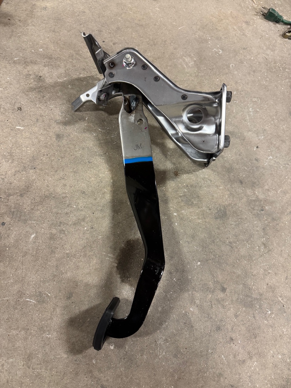

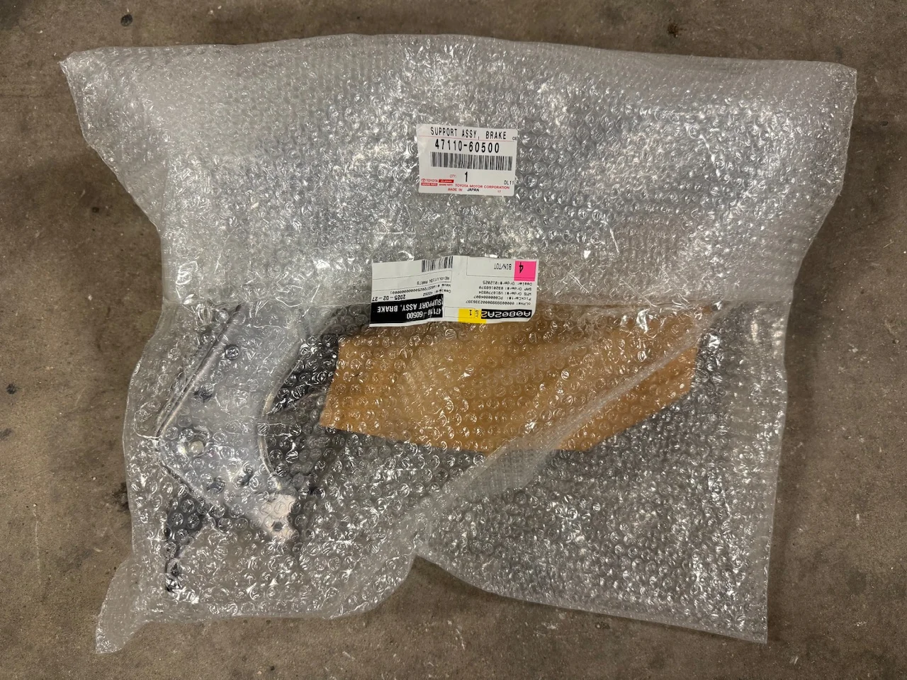

Look what you can buy from Toyota USA: new style 7x series brake pedal assembly. Shiiiiny.

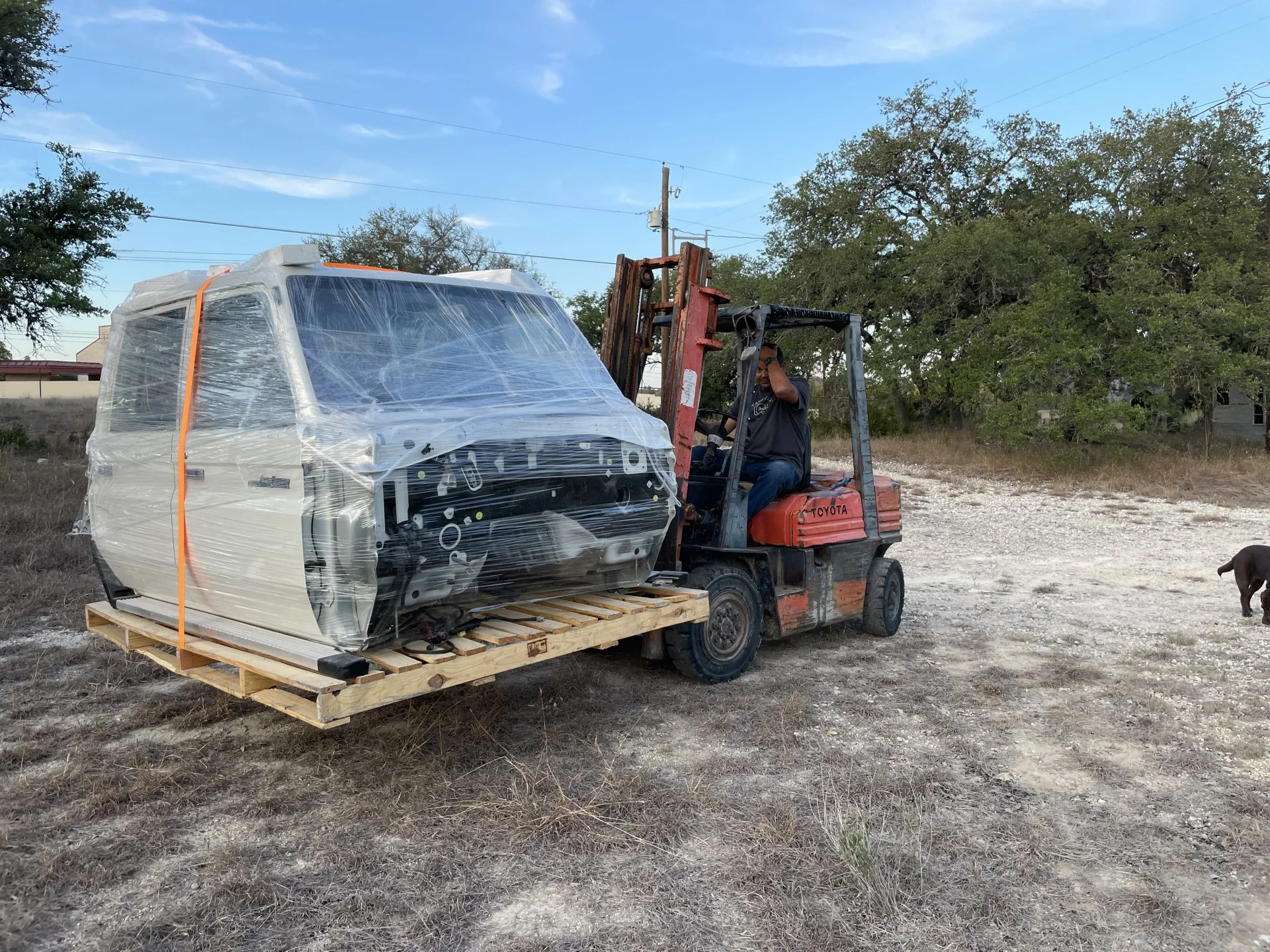

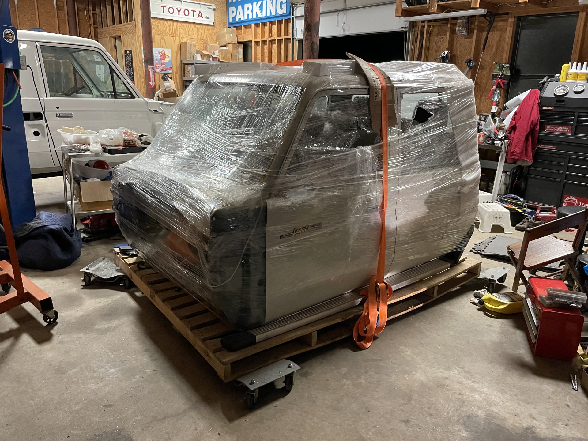

Since Austin was the closest to the port of Galveston, and I have a little bit of room at my place, we parked a 40 foot container full of magic, and Frank came down to open it up Thursday night. @Fern1109 coordinated the delivery and made sure that an 18 wheeler got in and out of the ranch safely. Lola and Murphy approved.

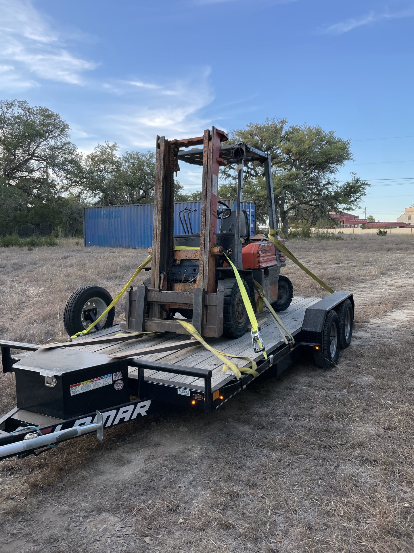

@Spallet loaned me his (Toyota diesel) forklift and Tetris forklift wizarded my cab and bed out without a scratch. View attachment 3141121View attachment 3141122View attachment 3141124View attachment 3141125
Happiness is about managing expectations. I am absolutely elated. Frank did such an amazing job with this.
Amazing that this container is now at my place. 79 Double Cab work finally started today!!
