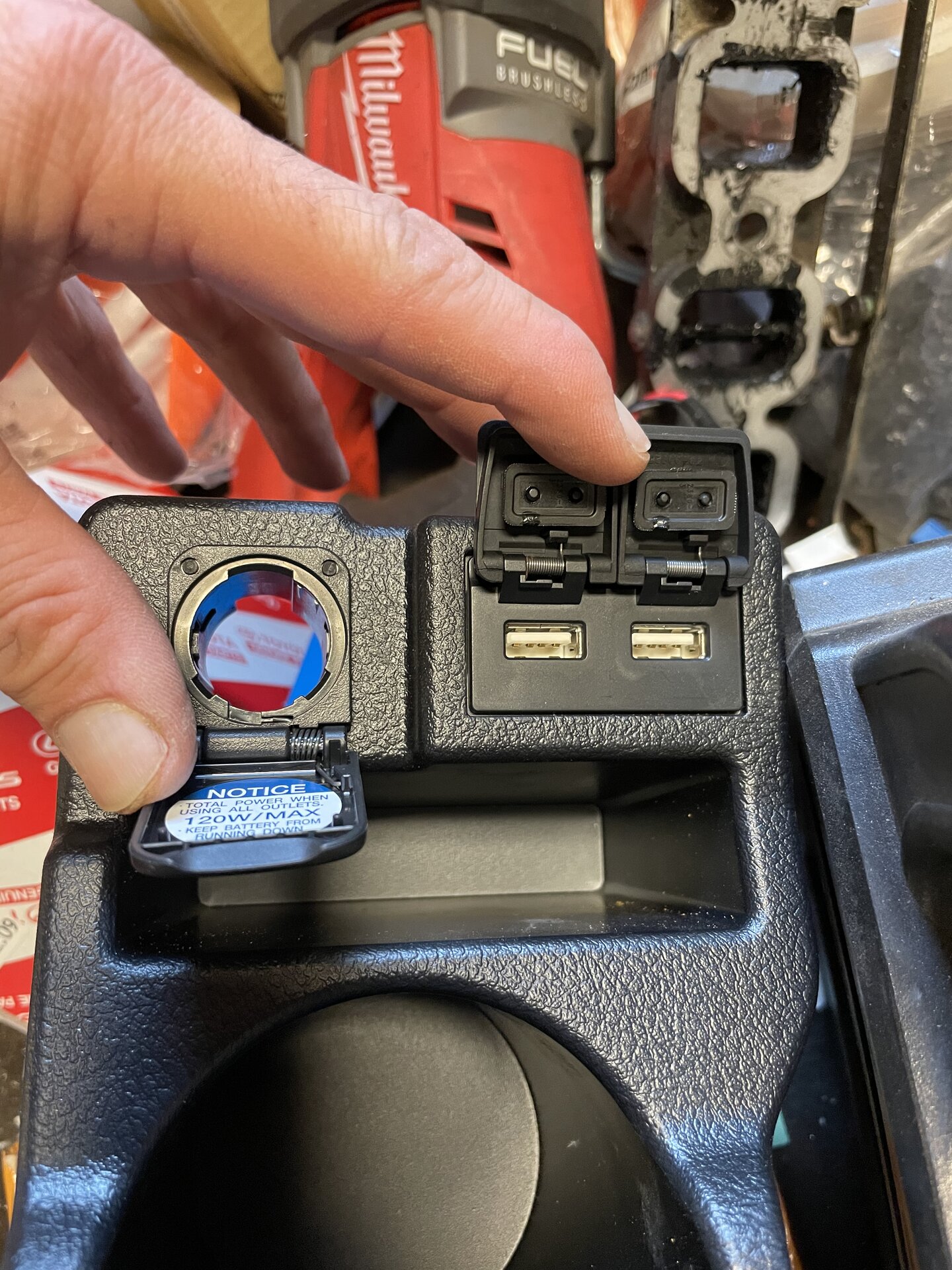

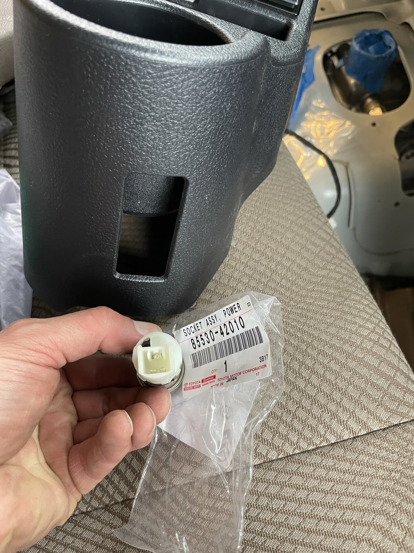

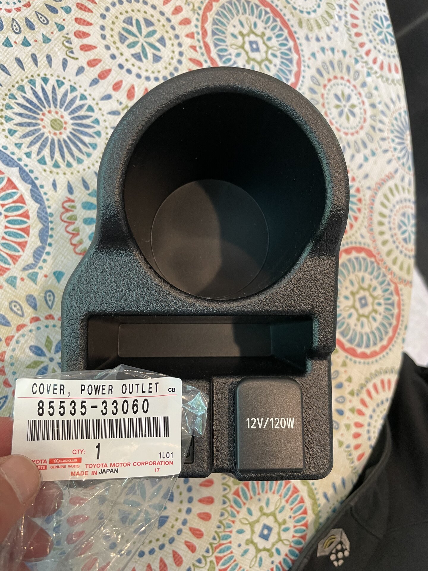

A little thing, but I love these OEM cup holders with USB chargers, and a friend in Australia shopped me one. It didn’t have electrical parts so I am tracking them down. eBay provided the USB chargers. I need a cigarette lighter charger now…unless I just leave a bare cap.
Boujeee!
CD, you know me: fancy AF!
Andrew, there is an OEM part and I have not been able to track it down. It seems to be a dealer only item in Australia, and I just could not find one, even with friends on the ground there.

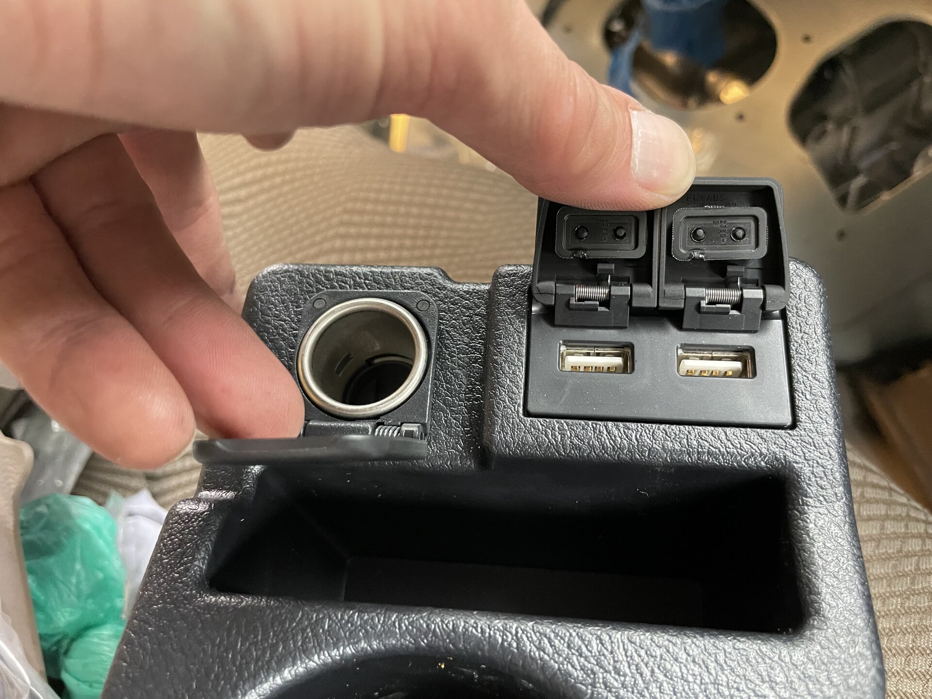

I used this one from eBay:
Much appreciated. I looked as well, and your cupholder appears to be an Australian market only part, it doesn't show up in any of the usual places. (toyodiy, partsouq, toyota USA) I have the part number for the OEM single USB charging port here somewhere...

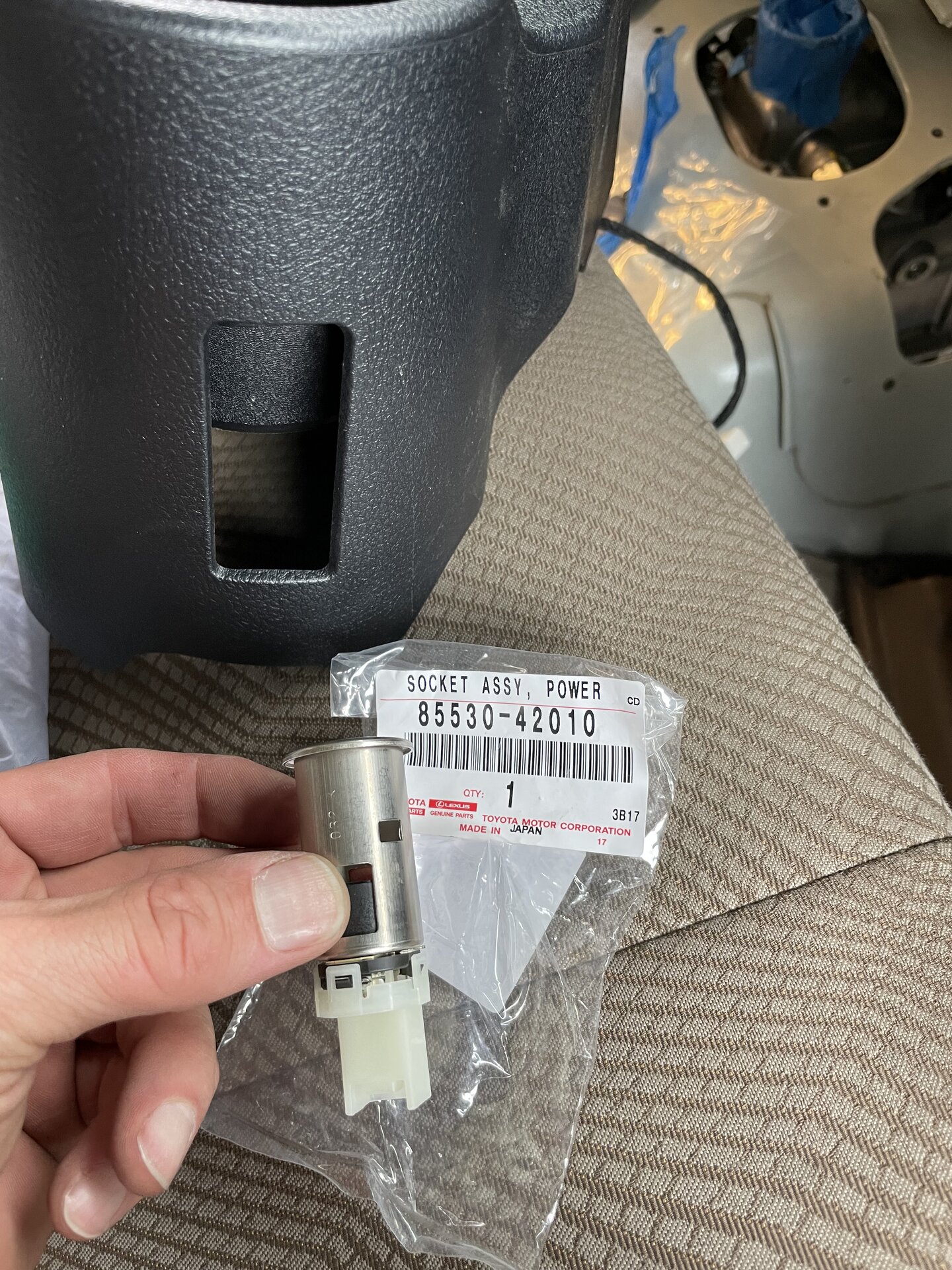

Crap. Minutes before seeing this I grabbed an 85530-42010. Guess we will see.
That should still fit, but it has yet another different electrical connection than the other two I found. The pigtail style is probably the lowest profile depth-wise, in case you're tight for space behind your cupholder.
Andrew
It will be interesting to see what connectors the dash harness has….
@Andrew S - update time!
The cigarette lighter (power outlet) arrived, and plugged right into the USB charger wires. In the next couple of weeks, I should be pulling the dash apart to put in my new harness. We will see if the dash harness has the proper connectors for this charger. It better!

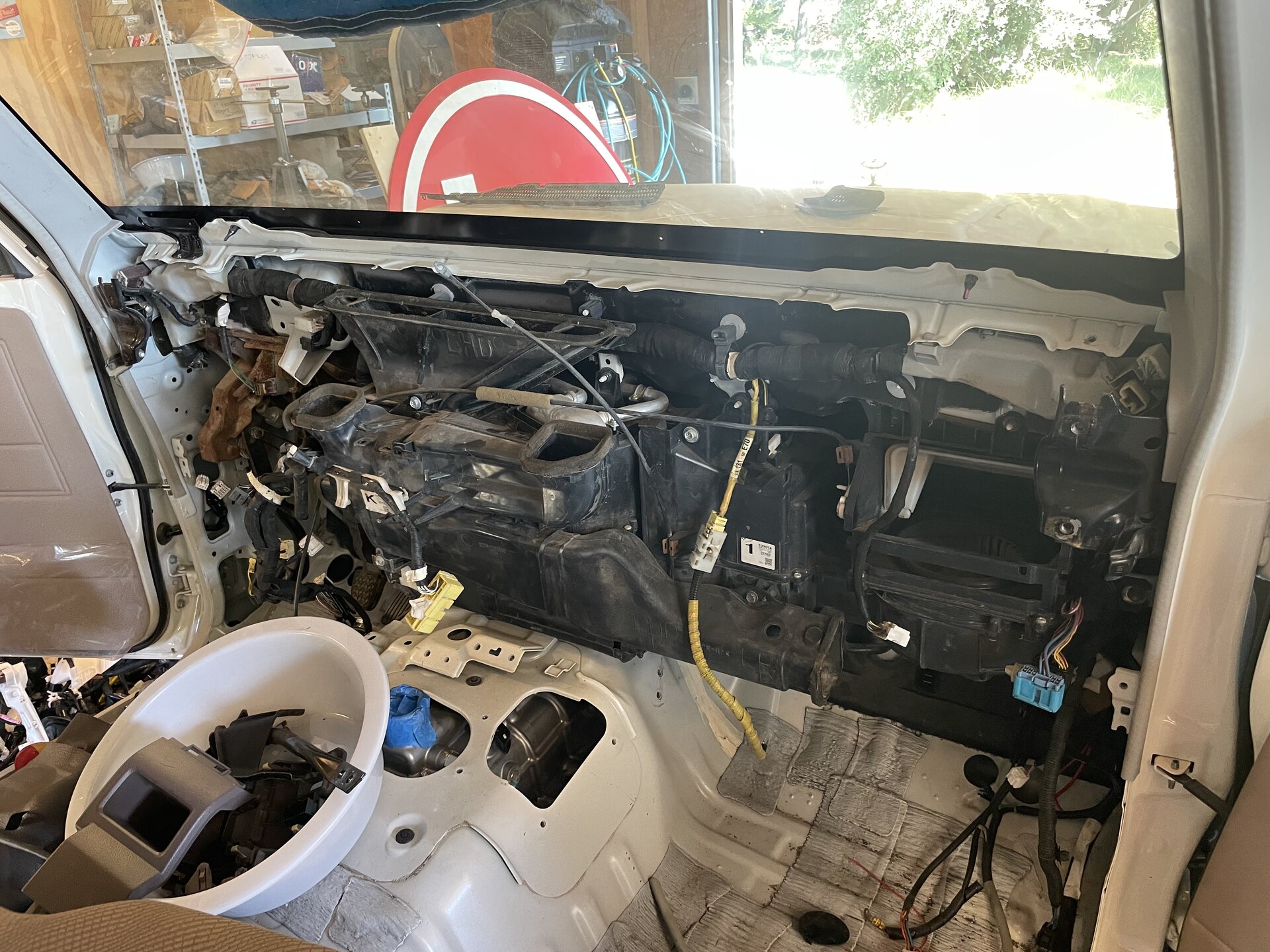

So, a little bit of progress. The wiring harness that came with the truck had seen better days. I obtained a new one from a single cab HZJ79 and I can definitely say that the new style cowl harness is much more cumbersome and complicated than the old metal dash style. I cleaned up the a/c ducts, tore it all apart, and washed out as much of the fesh fesh out as I could. It’s amazing how hard it is to get rid of.
