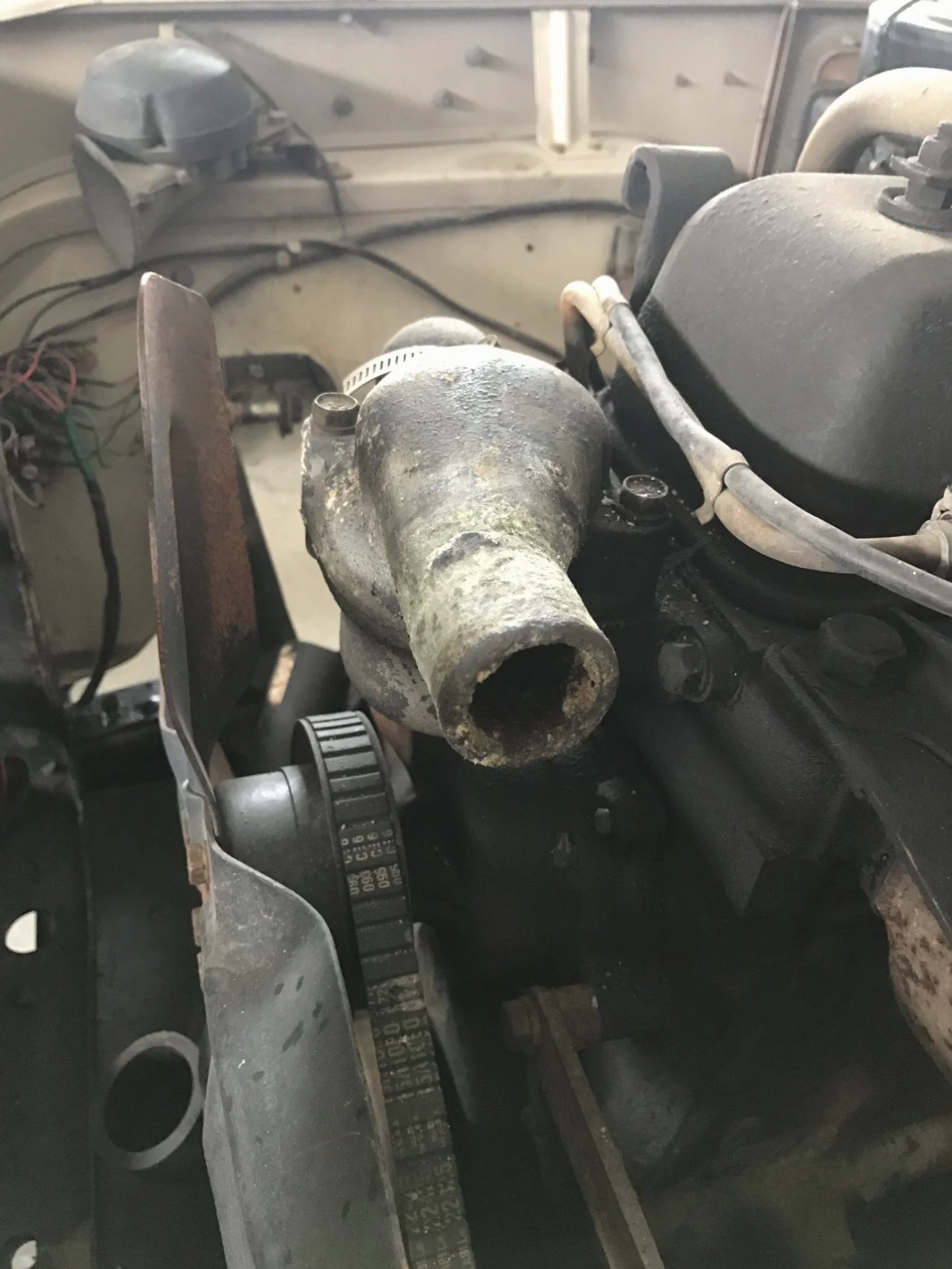

I've got a new radiator coming. Thanks @beno. Look at the housing in this pic. There's crud and sediment in the cooling system. Should I do some disassembly and try and clean that out? I hate the thought of clogging my new radiator with this crud, but I can't possibly clean it all out of all the passsges, either.
What say you?

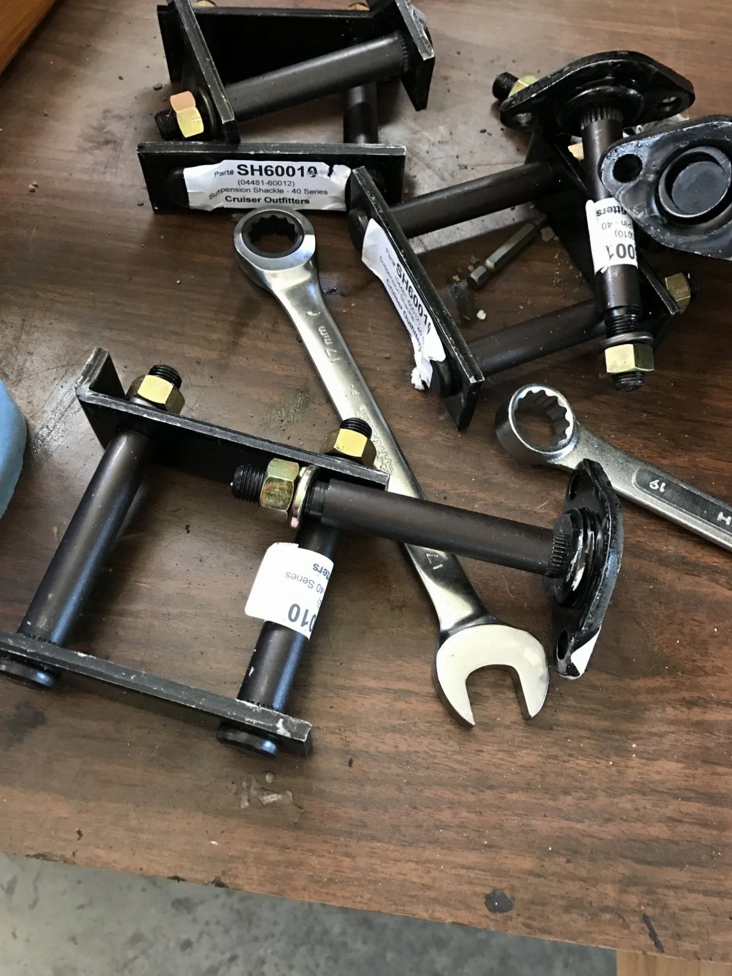

New shackles and pins from @cruiseroutfit arrived today.

Anyone have any comment on the cooling system? How should I clean that out?

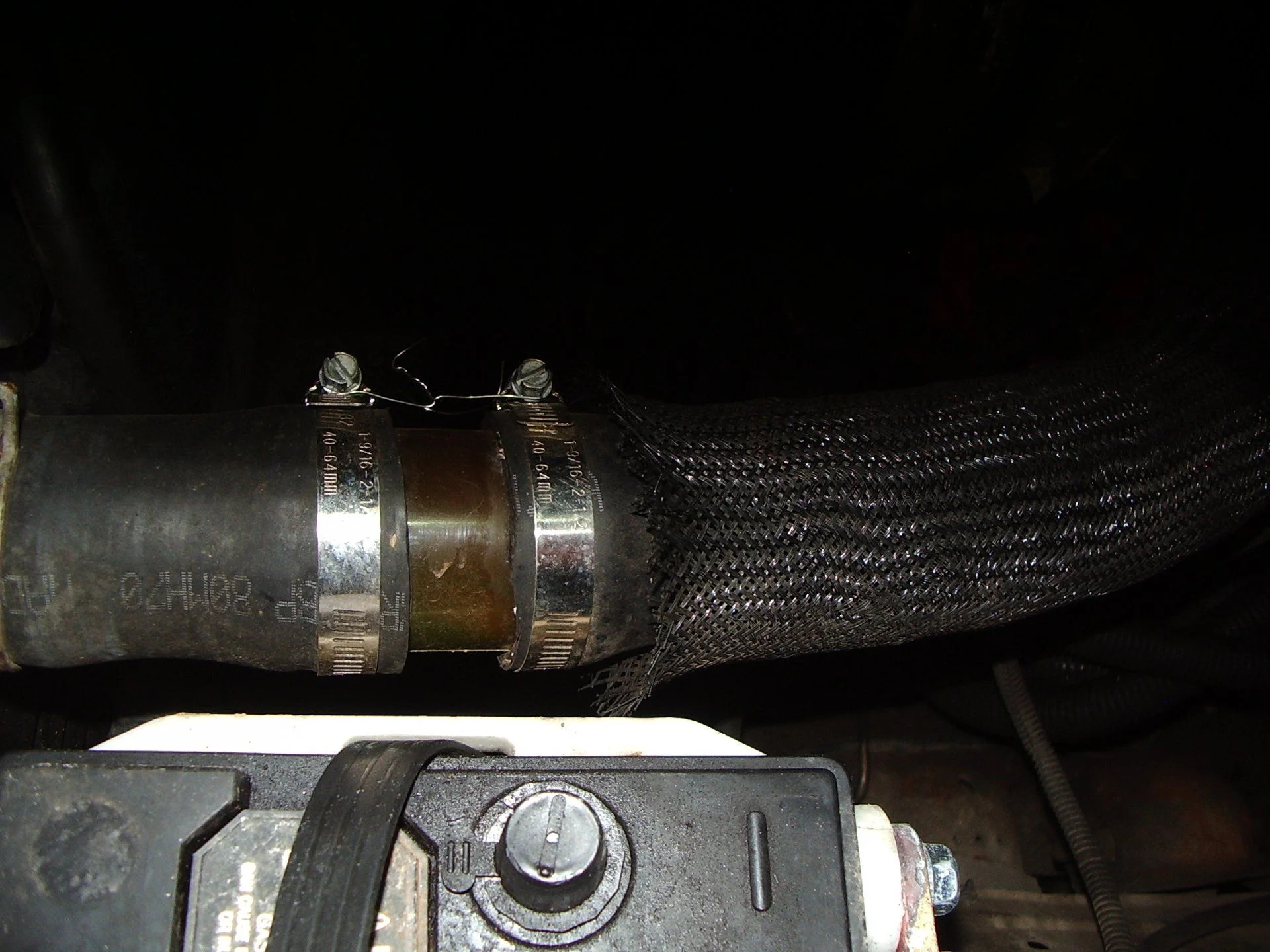

I have a 94 Chevy K2500 with a diesel motor. A little over a year ago I combined my very tired 6.5 with a 6.2. When I did this I didn't know how clean the bottom end of the 6.2 was, so I added a clear tube section, with filter screen, to my top radiator hose. The name of the company that sells this kit escapes my memory at the moment, but maybe this will jog somebody elses memory, or mine. I am a bit leary of plastic parts, but this has been in my pickup for about 1 1/2 years now with no problems. I will try to add a picture, however I haven't added a pic since before Mud changed their programming, and I definitely am far from up to date with today's technology.
Well, in the past few minutes I was able to figure out how to add a picture. I'm amazed at how easy it was compared to the old Mud program. Anyhow, here is the top radiator hose on my pickup with the clear tube and the filter screen inside it (barely visible in daylight because of the green color of the anti-freeze). All the coolant is run through that screen, catching all the junk that is in the coolant passages of the block. You can see the junk caught in the screen IF you are in daylight and look very carefully. As you can see there is a safety wire, included in the kit, that holds the two radiator clamps in place. The kit includes the tube, two clamps, the filter screen, and the safety wire.
I'm still drawing a blank on the name of the company, and have been unsuccessful doing a quick search through my notebooks. I know I saved the information, but put it in a very safe place. So safe I can't even find it. It is past my pumpkin hour, but I can guarantee you I will stay awake for a while trying to remember. Then when I do fall asleep I will have nightmares about my failing memory, only to awake in a dead sweat because of my failing memory. Zzzzzzzz.
Don
Amazing! I remembered during the night (as I was going to bed) that I had a second filter kit for a Nissan SD-22 motor I have. So I went out there this morning and got the info and some pics of the kit.
It is a Gano Filter, from ganofilters.com in Escondido CA. Sorry for the fuzzy pic. My little camera doesn't like close ups very well, and I wasn't going back outside to retake the pic. Here you can see the kit, with directions and clamps, and at the bottom of the bag you can see the plastic tube and filter. What can't be seen is the safety wire. You can also get some of these kits with aluminum tubes instead of plastic, but I chose the plastic because the filter screen is visible to the outside.
