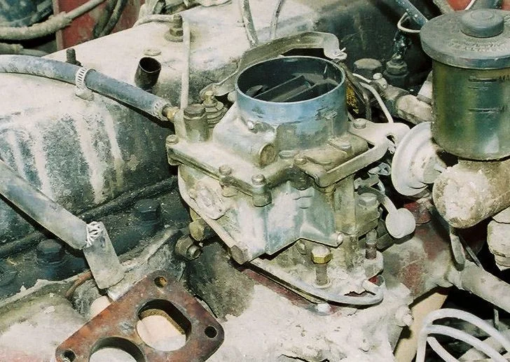

Have you worked on adjusting the carb any?
I know the driver's side barrell is not working, only the passenger's side. I've screwed in the set screw all the way and backed it out about 2 turns.

Have you checked your PCV valve? If you need a new one I have a trail spare you can have.
I don't know what/where this is...so, no I haven't checked it.
The PCV hose connects to the side lifter cover (cover behind dizzy) it goes to the spacer under the carb.
attachment.php
The PCV valve goes inbetween the hose and the nipple sticking out of the cover behind the dizzy. Any outoparts store will have this it's only around $5
