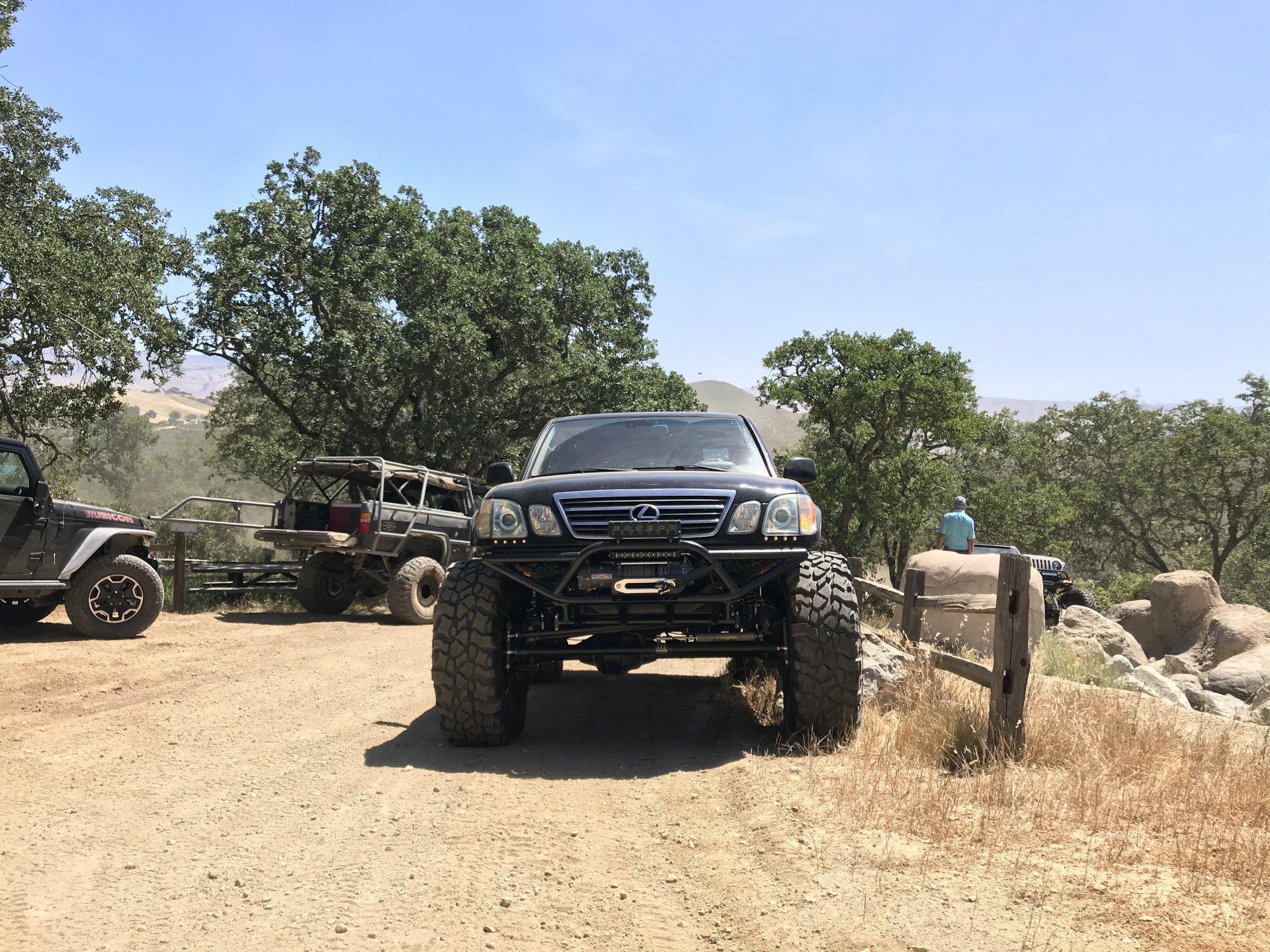

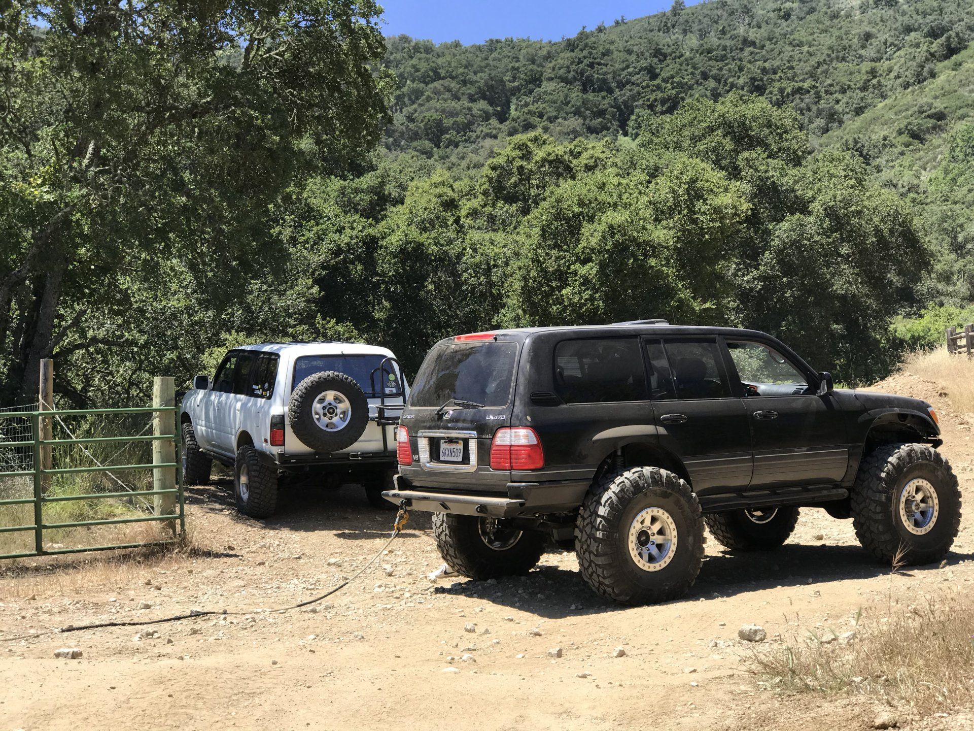

So I went for a shakedown run at Hollister. Other than adjusting coilover preloads and dual rate stops and other misc crap, it was mostly uneventful. We ran "white rock" up to Hector Heights, part of McCrazy, some stuff on the obstacle courses, etc. Relatively fun, until the end:
Pics:
Overall impressions? It's bigger and dumpier than the 80. It's nicer so I'm less inclined to YOLO it for now. I need to adjust the bump stop pressures still and do some rear bumper "clearancing". The sway bar still also wants to rub the frame in the rear so I need to tweak that out a bit more. Skid plates work great, overall performance is fine. I forgot to carry a pressure gauge so I was running "something" psi all day, but it was overall pretty good. The V8 but especially the A750F is nice for the low first gear, but the gated shifter is annoying to go from R to L. I don't know how you guys do it, unless you don't really crawl your 100s that often so it's irrelevant or something. Maybe there's a manual valve body available?
Side note: I hate the "tesla" style radio and if anyone ever reads this, do yourself a favor and avoid it. The volume controls are on the wrong side of the screen, it doesn't reject any noise from my Yaesu VHF radio, it doesn't sound great, the screen is impossible to see, the HVAC controls suck, and it's slow to load etc.
Anyway, I ended up also having an embarassing failure at the end of the day - my upper link in the front "folded." For those of you who don't remember, I put a slight bend in it to clear the motor mount on the driver side. Well.... 2" 0.120 wall wasn't thick enough (the JKs use smaller OD tube for their bent upper 3-link, but that's in the rear...). Under throttle, near the end of the day, the link buckled and my front driveshaft prevented the axle from spinning all the way over. Oof. So now I need to either relocate the motor mount or beef up the link. I'm going to beef up the link, but also use a square tube instead of round, which has a greater moment of inertia in the plane I care about.
The nice thing about spicer 1350 joints is that they're easy as heck to swap out, so no biggie there.
Overall, it was a good shakedown run. I'm glad I found out one of the main weak points before doing anything more substantial with it!
