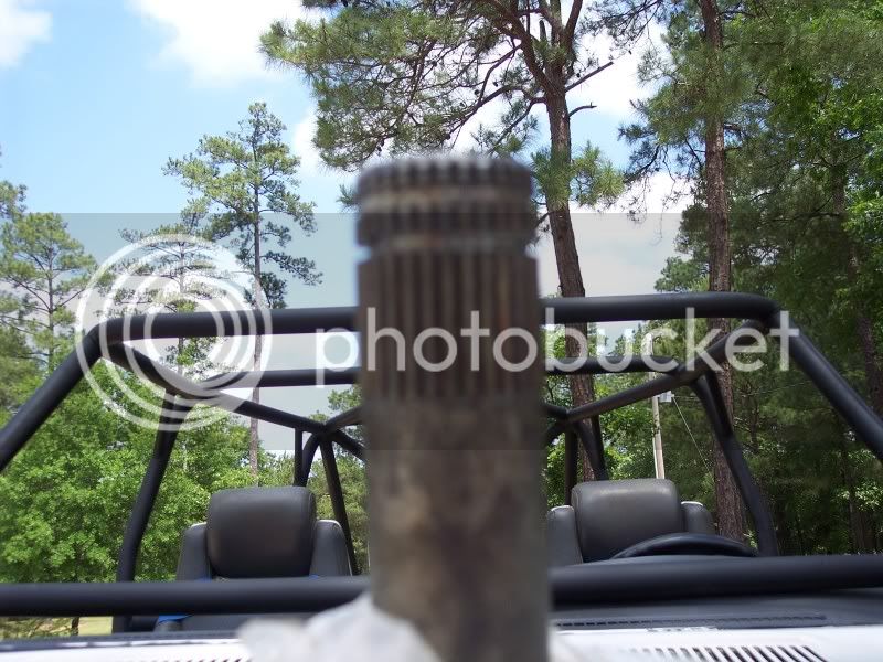

Got the front luch box locker installed and did a little more while I was there...
Sorry for the fuzzy pic but used my trusty Metabo to do this:
So I could install these:
Also Martack'd the inner axles so I could do away with the birf circlips. Now I just gotta do the CDL switch and 7 pin mod so I can lock/unlock at will. :cool:

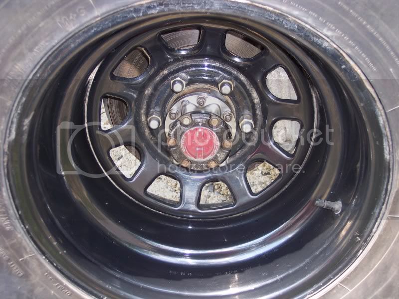

Are those mini truck hubs?

I know what you're thinking... I did manual hubs initially, but went back to flanges, they aren't bad on the road with that front auto locker.
Good call on the pin 7 mod... it does make a huge difference when on the trail and have the autolocker up front.
Not something I would spend big bucks to address but I had the hubs and only had to cut the snap ring relief in the birfs. I would have done the CDL and 7 pin mod either way. IF this rig ends up in Moab there will be some street time but that's about the only time I can think of.
