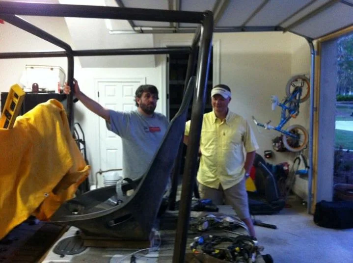

It was quiet at the Suzuki garage when I rolled in on Sunday morning. Bossman, Leonard and I had the place to ourselves. Lenny and Boss had taped off the truck to get the final design nailed down.
From here, all that was left was to finish off the rear end and put seatbelt bars/spreaders behind the B and C pillars.
Because all of the rest of the bars will be straight, Bossman will be finishing the door bars and the triangulation back at his secret lair.
While Lenny did the bending and notching, Bossman and I pulled the rear diff and installed a lunch-box locker.
JesS showed up and heckled and helped me install Lenny's 38.5's on 2" BS wheels on Half Ass and Bossman trimmed the fenders for clearance.
By about 3:00 on Sunday I was able to back the beast out and take it for a spin. My first impression is that it is very light with minimal body roll.
I think it will work great when finished. All it needs it a bit more tube and a bit more front end lift and it is ready for Hot Springs! I can't wait to see it on the trails.
