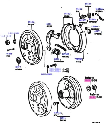

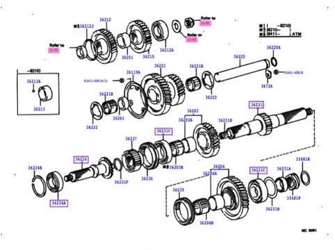

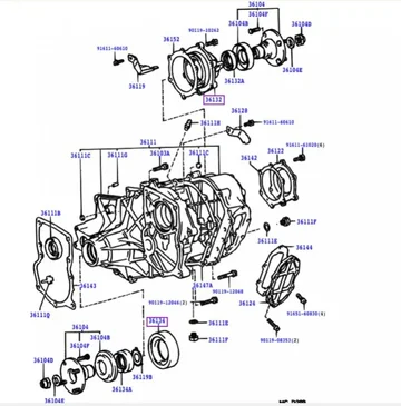

An attempt to define exactly what components are necessary for an 82 split case ebrake/H55:
Have a list from Kurt, to whom I'm appreciative of the time spent on the phone, that consists of the following:
Output Shaft (36231-60021)
Retainer (36231-60031)
Bearing (90363-35013)
Backing Plate (46503-60020)
Drum (46501-60030)

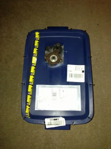

Parts details:
Have the drum from Georg, whom I believe reiterated Kurt's statement that the backing plate could be from any 40/45, since [Backing Plate (46503-60020)] is NLA.
Believe I've sourced the [Output Shat (36231-60021)] and the [Output Shaft Bearing (90363-35013)] leaving only the [Retainer (36231-60031)] to be located.

If this is the definitive list of all that's necessary for an 82 split case e brake:
Drum (46501-60030)
and in lieu of the depicted Backing Plate (46503-60020), what part number from a 40/45 is required?
if this is the definitive list of all that's necessary for an 82 split case e brake:
Output shaft (36231-60021) available
retainer (36231-60031) nfg
bearing (90363-35013) available
backing plate (46503-60020) replaced by 46520-60902: Disco
drum (46501-60030) nfg
and in lieu of the depicted backing plate (46503-60020), what part number from a 40/45 is required?

I'm wondering how different that backing plate is, have you tried mating that drum up with a one-piece case backing plate? I'd think the flange pattern is the major difference in the drum, especially since the same internals work.
Just thinking out loud ... looks like with the drum you've sourced most of it with what Beno posted is available ($$ aside) -
Tucker
The pattern was stated different, but I don't know .
Have sent the "order these" email but haven't a reply to solidify.
